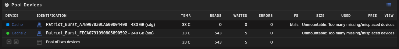

I currently have 2 x 240gb SSDs as a RAID 1 cache pool. I am trying to replace these with 2 x 480gb SSDs, and I have tried to follow the instructions here:
https://forums.unraid.net/topic/46802-faq-for-unraid-v6/#comment-480419
Upon selecting the 480gb drive as one of the 2 cache drives and starting the array, the pool devices look like this:
and there is an option at the bottom to format all unmountable disks (which seems to be both devices currently selected as cache drives, sdg and sdi)
I'm not sure what I'm doing wrong. I also really don't want to copy all the data from my cache pool to the array if i can help it since there is a lot of very small files (plex media library info and minecraft servers, etc.) which would take an extremely long time to copy.
EDIT: upon noticing the disclaimer that this isn't working in unraid 6.9.x, i read through that post in which someone suggested instead removing one drive without adding a new one first, however i am unable to start the array unless I have 2 drives selected (start button is greyed out).
any other suggestions?
