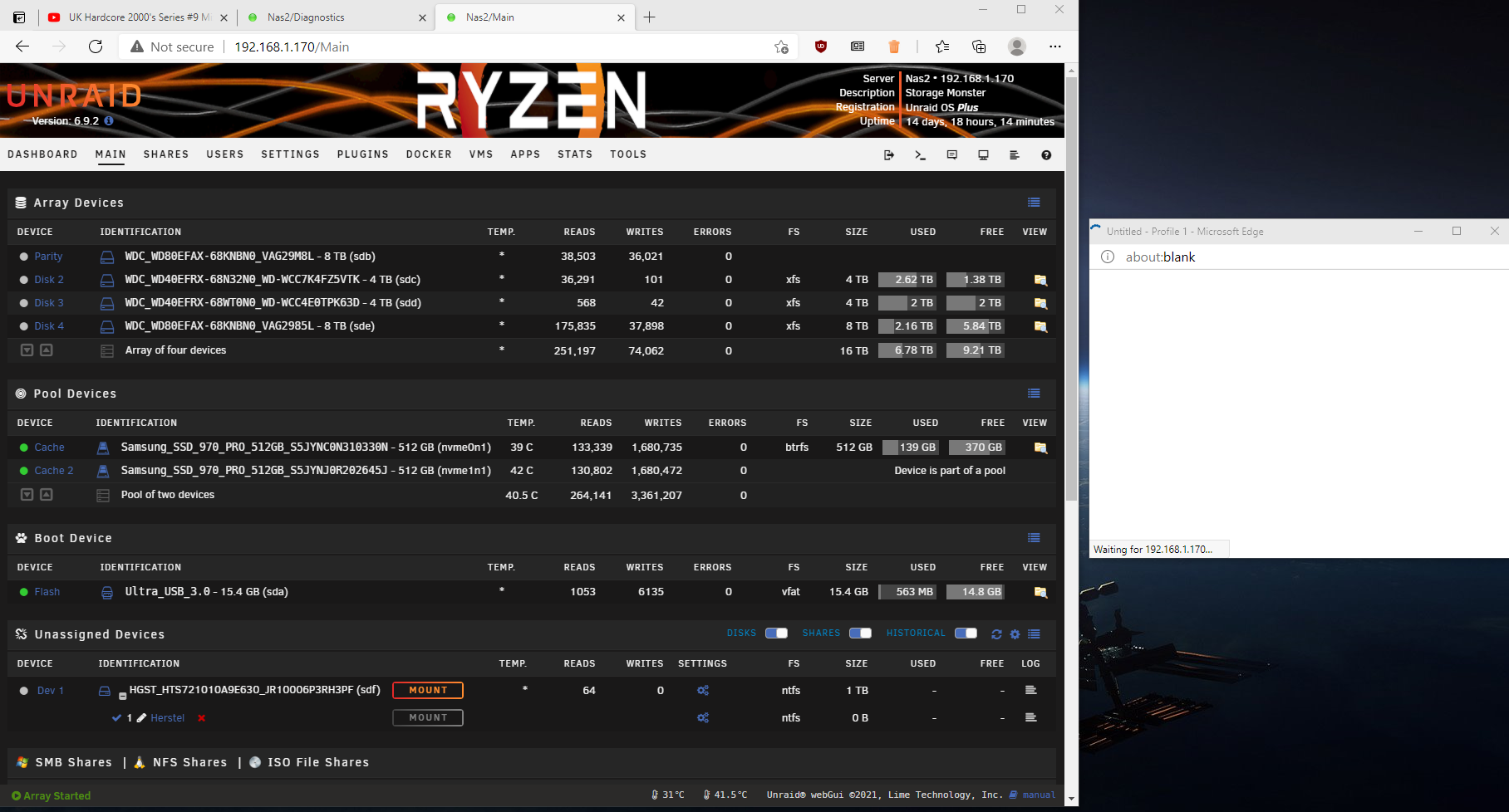

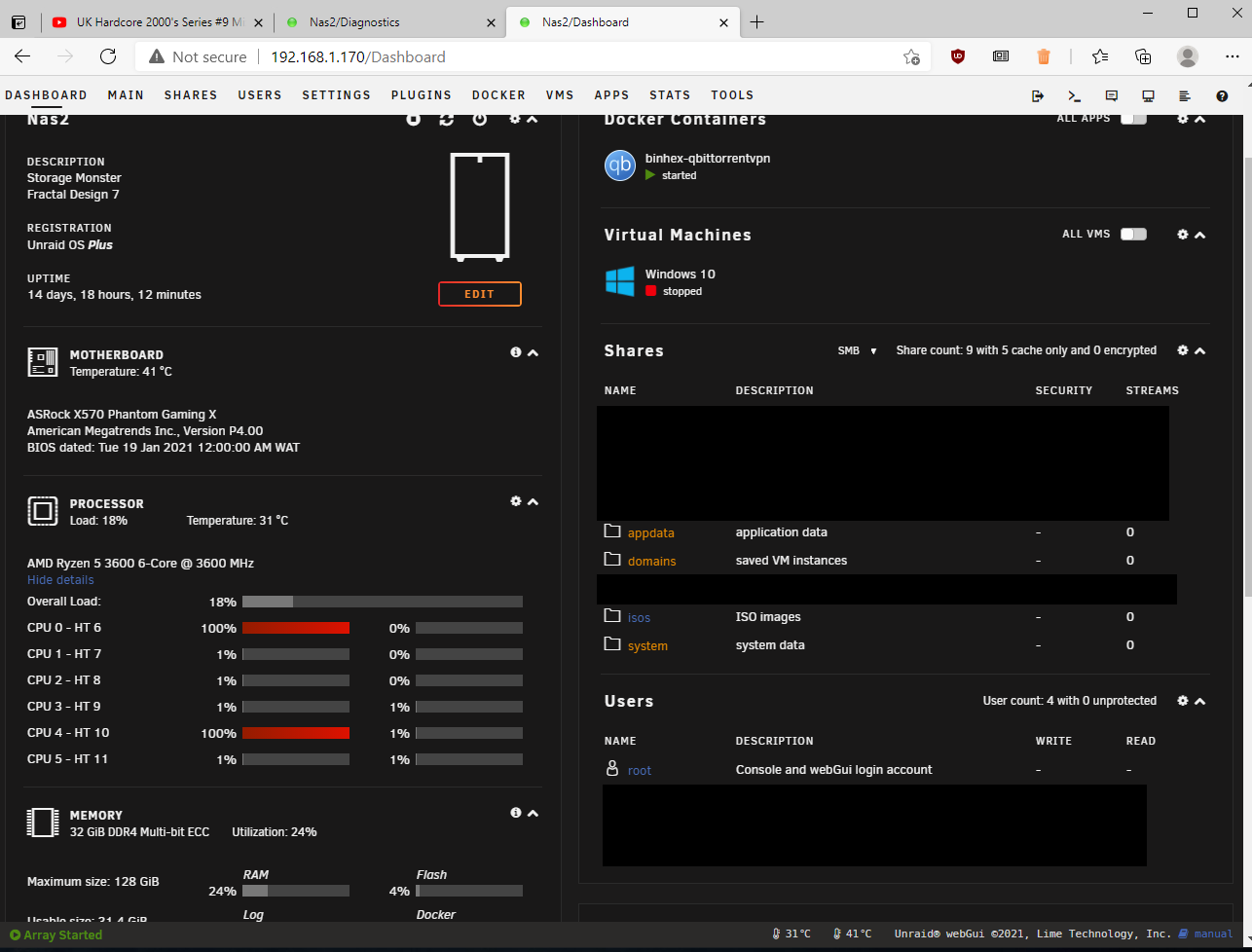

It had been running fine for about 14 days (daily checks to see if anything weird was up) and this evening I noticed 2 cores at 100%.

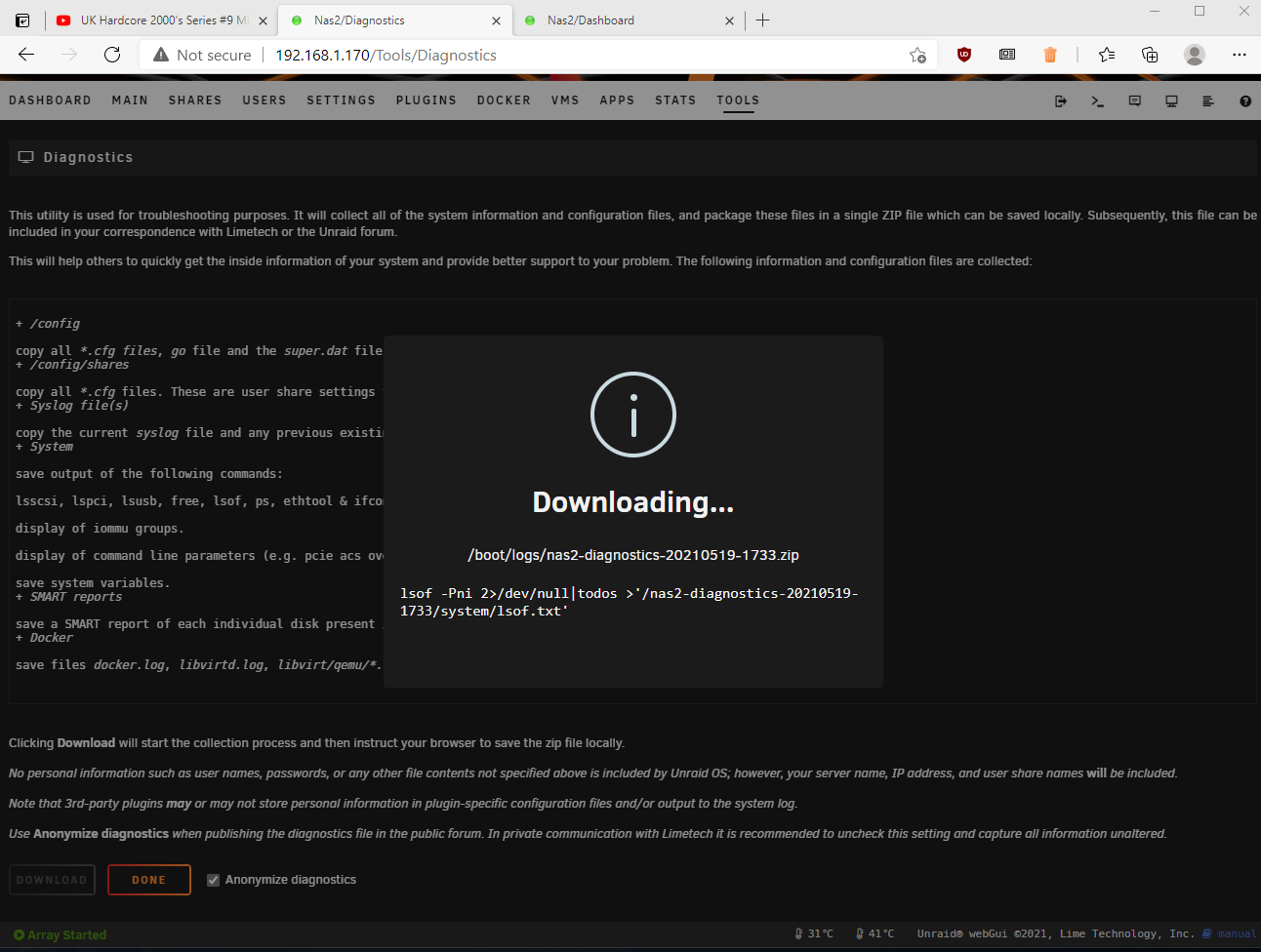

Thinking this was weird I tried to run a diagnostic, but it wouldn't do anything for about an hour...
I tried to see if I could access the data on the HDD's and I could, both trough samba and directly trough the webgui. Now the webgui didn't show the drives spinning up?
The command line didn't respond either.
One other thing I did notice was that the unassigned drive was unmounted, whilst I'm quite certain that  it was mounted (used for the VM, which is off by default) this morning.
