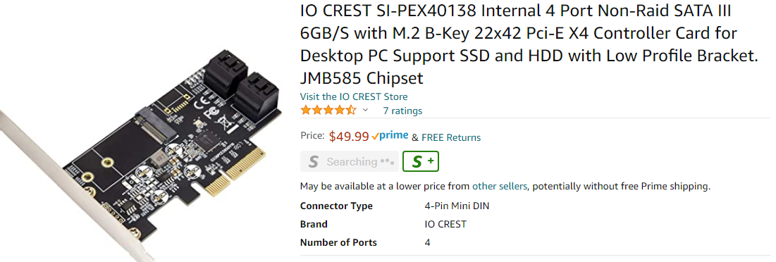

I have also now read that my Marvel chipset SATA card, could be causing issues.  I wonder if just having it in the server, is causing problems.  So I've ordered one of the recommended controllers to replace my current one.  3 of my unassigned devices, that are currently attached to that controller, show up as not mountable currently, and their FS is unknown.image.thumb.png.0a7aa4744334681a5823b10af5671f4f.png
I'll try swapping this in and attempt parity sync one more time, if it doesn't work, then I'll just copy all the data from the array back off, and then format the 3 USBs disks and mount as unassigned disks, then copy the data back to them, to start over with the 8TB disk.
