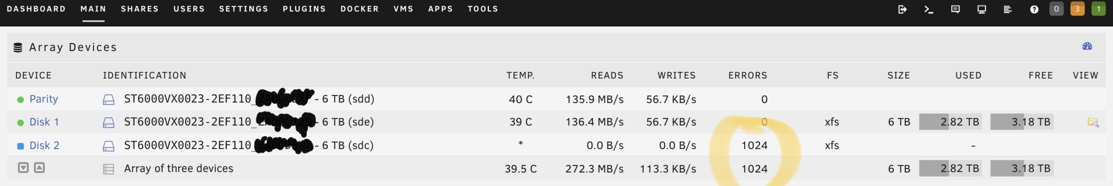

Im trying to put a 6TB hard drive to my existing array, which consist of 1*6Tb for parity an 1*6Tb for disk1. I notice that once i assign the new disk to disk2, i dont see it being reflected in the GUI, and in dashboard it's status is unassigned. There is no option for me to do any format.
Please help

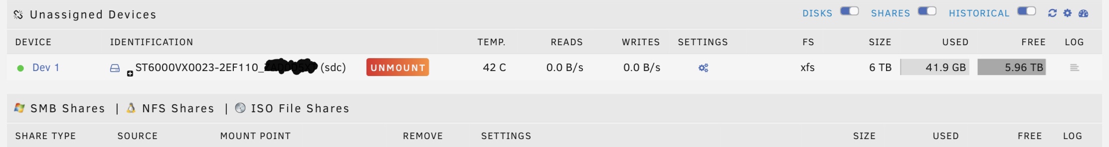

Just to add on, from the “unassigned devices” plugin, its seems to be able detect the drive.

Unassigned drives can handle drives dropping offline and re-appearing while the main array cannot.

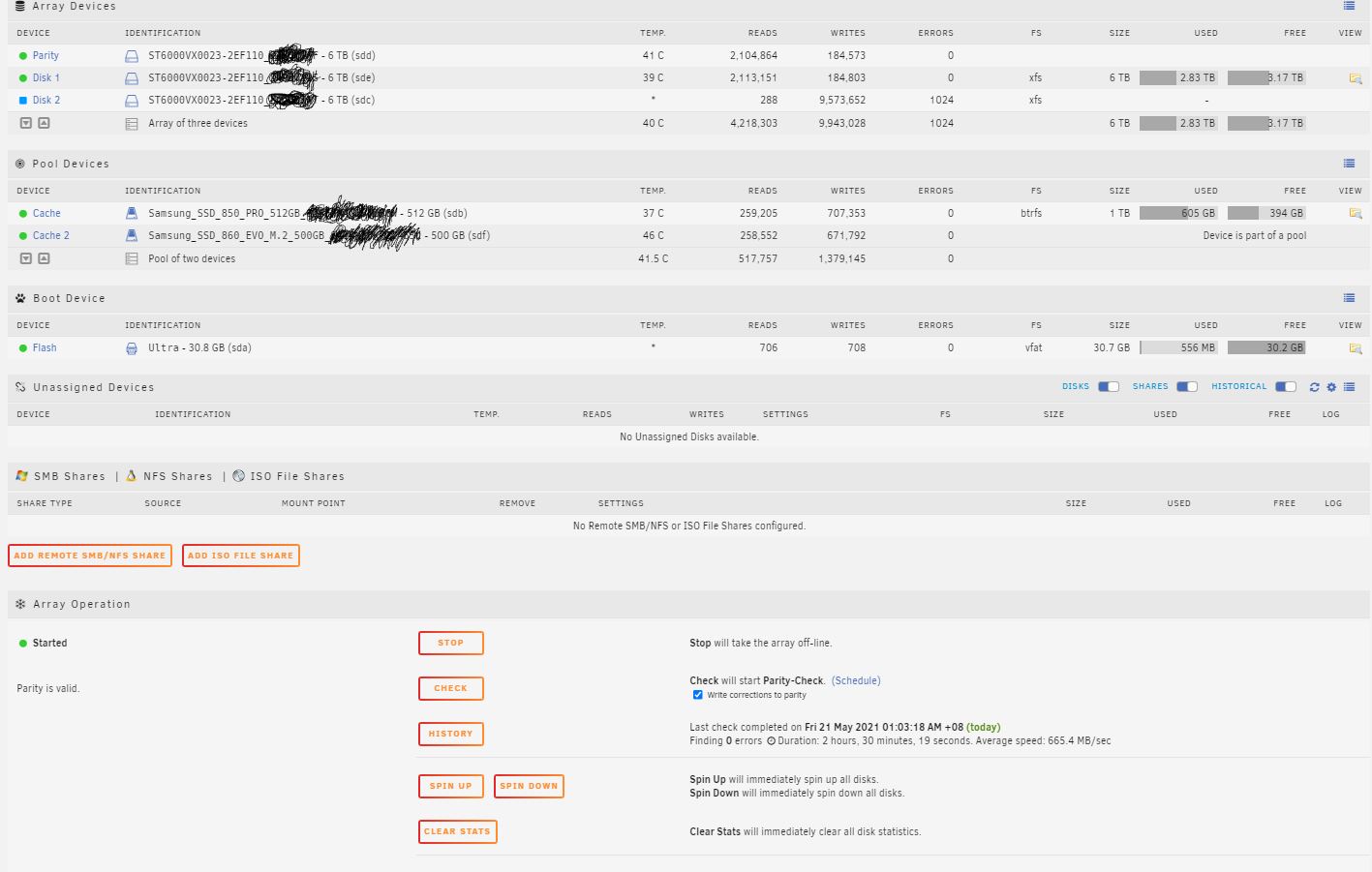

So I’ve change to a brand new sata cable. Did the clear and i notice the issue might still be there, stuck at 80+% and had to resume manually
I suspect my hard drive could be faulty, as previously the sata cable and port was use for my ssd which act as parity drive. Which later i remove it and replace it the 6tb hard drive
attached diagnostic, noticed this time there are a lot of disk0 read error in logs
Edited by Enjawd

Hmm, from the logs i still see the comreset error on ata2 several times. I’ve try using another sata power connector as well. I’ll try to plug in another spare 1tb hard drive to isolate the issue, maybe its just a bad 6tb drive.
As for the ftp,  not sure why did the service changes back to enable. I’ve just disable them again.

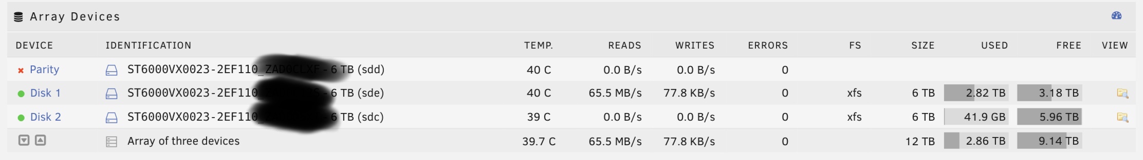

Alright, weirdest thing just happen. My (Disk2)ata2 came online and parity drive just died.
tower-diagnostics-20210523-0806.zip
Edited by Enjawd
That was the first opportunity to see Disk 2's SMART data. It's not a happy disk. It has a lot of reallocated sectors and a lot of pending sectors. You need to replace it. From your original post you said you were trying to add it to your existing array so it's unlikely to contain any useful data. That's just as well because your Parity disk is not in a good state either. I'd replace that, too. Fortunately, your Disk 1 looks healthy.
