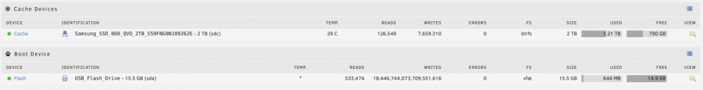

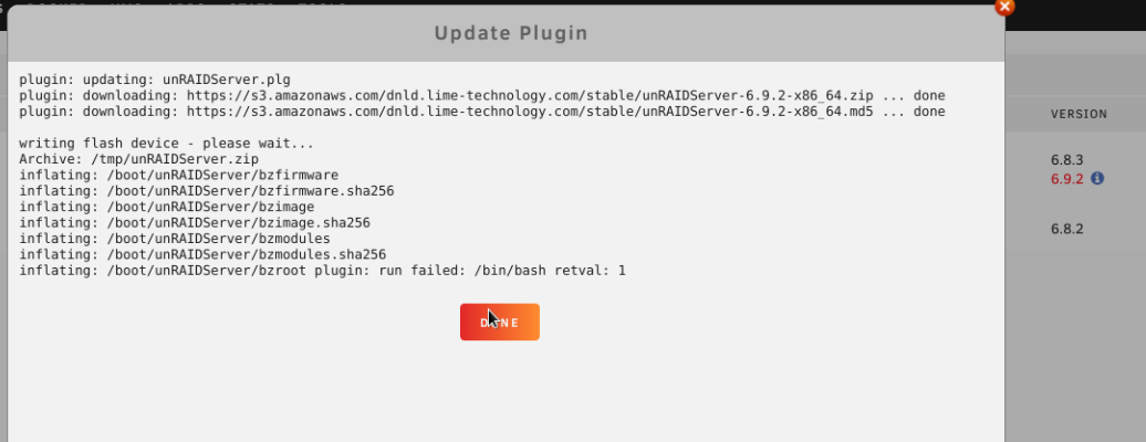

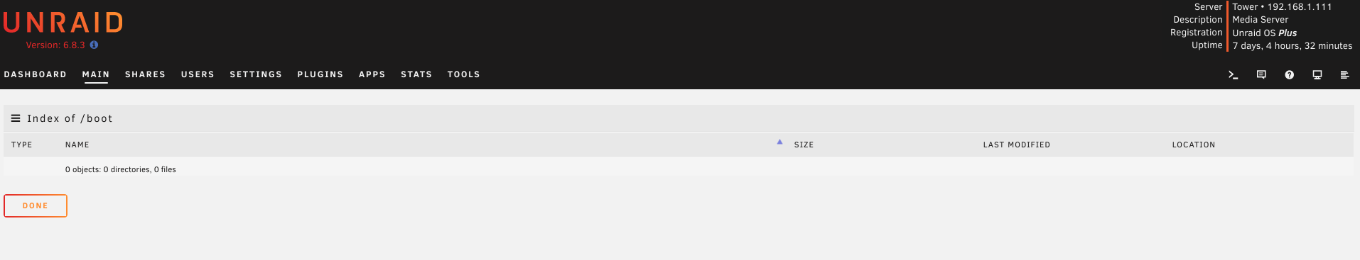

I ran into this error when upgrading to 6.9.2 and now my flash drive seems to be empty and shows writes with a value that I am not exactly sure how to say in words.   See screenshots below..
What might cause something like this to happen?  What would next steps be?

Could mean the drive dropped offline?
Suggest you plug it into a PC and let Windows check it.   Assuming that is OK, download the zip file for the release and extract all the bz* type files overwriting the ones on the flash drive.
