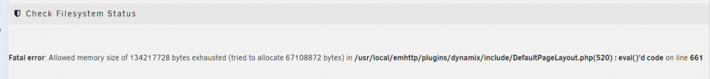

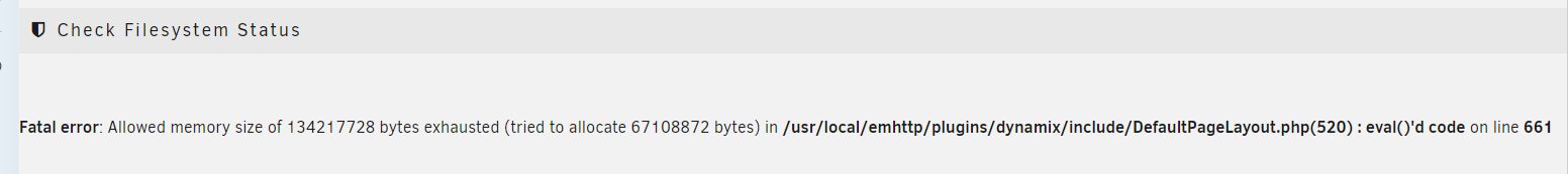

I tried doing a repair dry run with the n switch and got this:
Reboot and try again, or do it on the console.
I got the same result after rebooting. THis is the final part of the output when running from the console:
