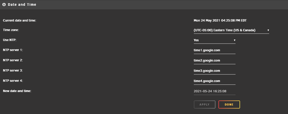

If the date is out, then most SSL requests will fail.  You should replace the battery and also set up the NTP servers in Date/Time settings
That seems to have fixed my issue. Don't know how I overlooked the Date and Time setting as I just assumed NTP was enabled by default.
It is, but you have to set your timezone.
