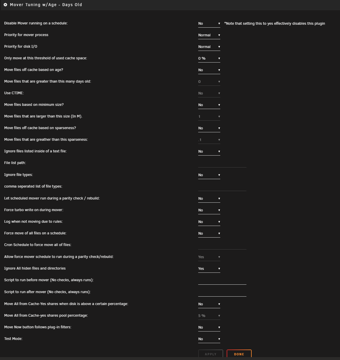

@hugenbdd Very much appreciate your efforts on this, apologise for the slow response.
I've just updated to your latest plugin (thanks for the special mention in the release notes) and have enabled your setting in the mover settings but am still seeing my folder `.doNotMove` being moved from the cache to the array.
Possibly I haven't set it up right?
Here is a screenshot of my settings
If you are using the Move Now button, you have it set to follow the original unRAID mover settings.  (i.e. All files)
Else, can you do a few things.
1.) Enable Logging
2.) Move Now button Follows plug-in Filters: Yes
3.) Set Test mode: Yes
Then post the syslog output for all of the mover entries.

@hugenbdd
Aha I missed this setting, yes I was hitting the move now button.
Yes its working!
any files or folders that are prefixed with a dot are ignored
THANK YOU
