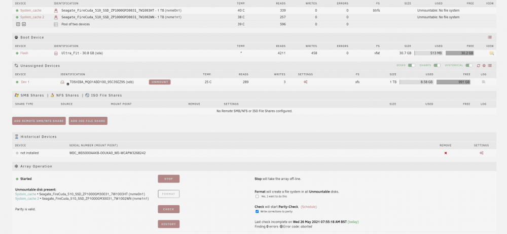

This morning my place had a power cut, after rebooting - I am now no longer able to mount my system_cache.
My system cache had:
  • appdata
  • domains
  • isos
  • system
It was mirrored to harden it on loss of a drive.

Hello @SmokeyColes, your system diagnostics could provide more information.
Please go to Tools / Diagnostics and attach the full zip file to your next post.
See here for some recovery options, first one to try in this case would be the nologreplay mount option.

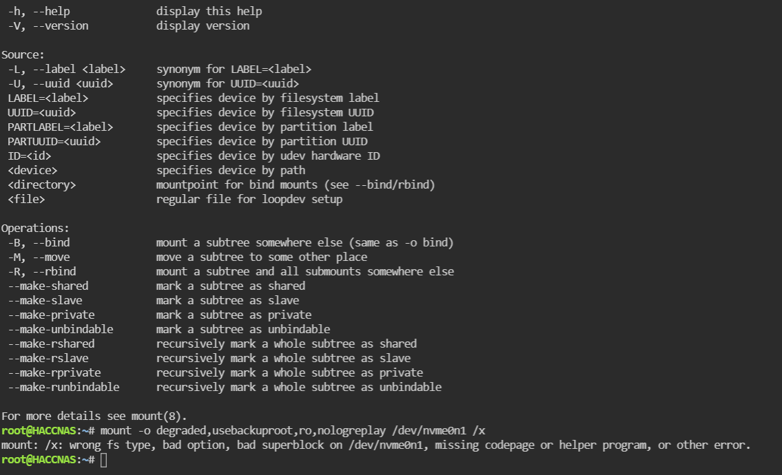

Hi @JorgeB
Forgive me, my ability isn't there.  Here's what I tried:
mkdir / x
mount -o degraded,usebackuproot,ro /dev/nvme0n1 /x
I just want to check before I move to BTRFS restore (safe to use) step -  that I've done the command correct?
I'm happy to pay for your time on this, with the help you've provided - you deserve a couple of pints anyway for it all.
Edited by SmokeyColes
Try this option first, but note that the device was missing the partition:
mount -o ro,notreelog,nologreplay /dev/nvme0n1p1 /x

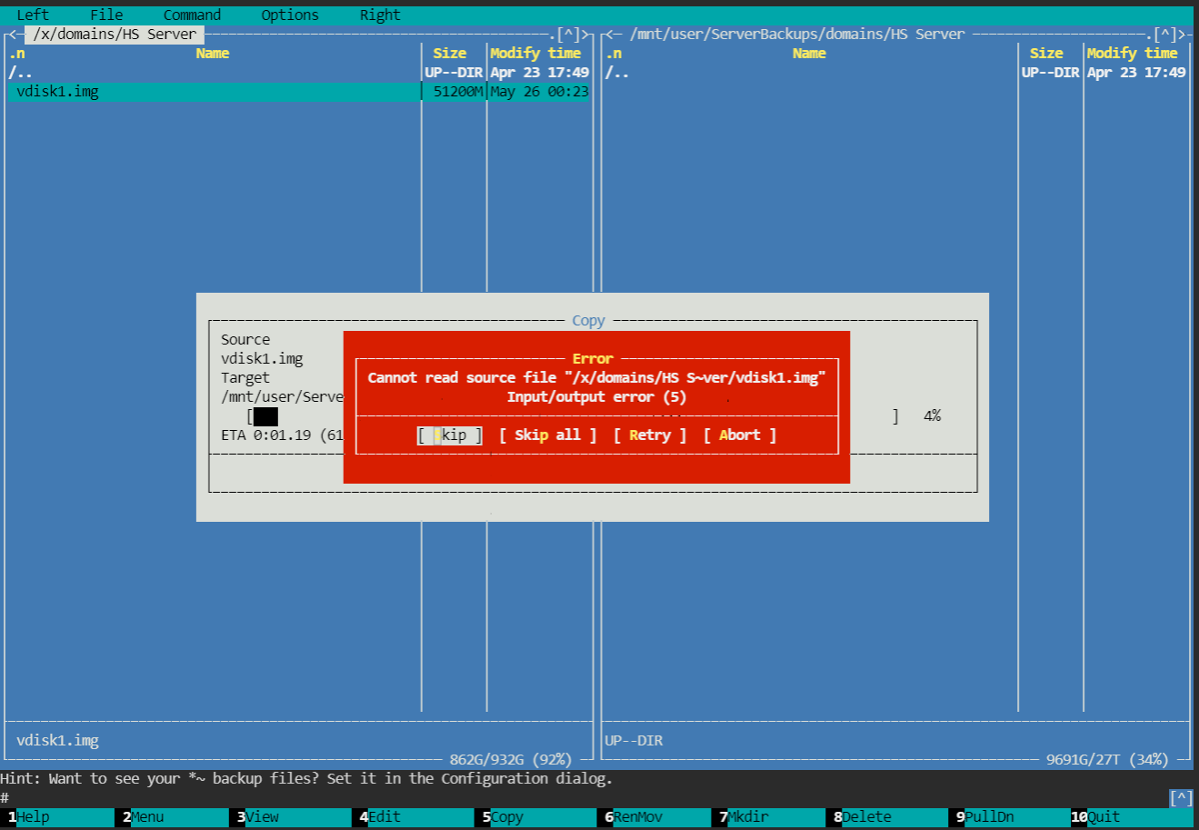

I have spoken to soon.
appdata and system no issues with the copy
1 of 3 VM's transferred, but the 2 I really needed did not.
2 of the 3 ISOs did not - but in fairness I can redownload (I'm not excessively worried) but would like to recover the VMs.
Should I move onto init log tree, or should I try something else?
That suggest those files might be corrupt, post current syslog.
Yes, they are failing checksums, I also noticed data corruption was detected in you other pool, you likely have bad RAM or other hardware problem.
You can use btrfs restore since it won't check for that, but files will still be corrupt, but depending on the severity they might still work.
