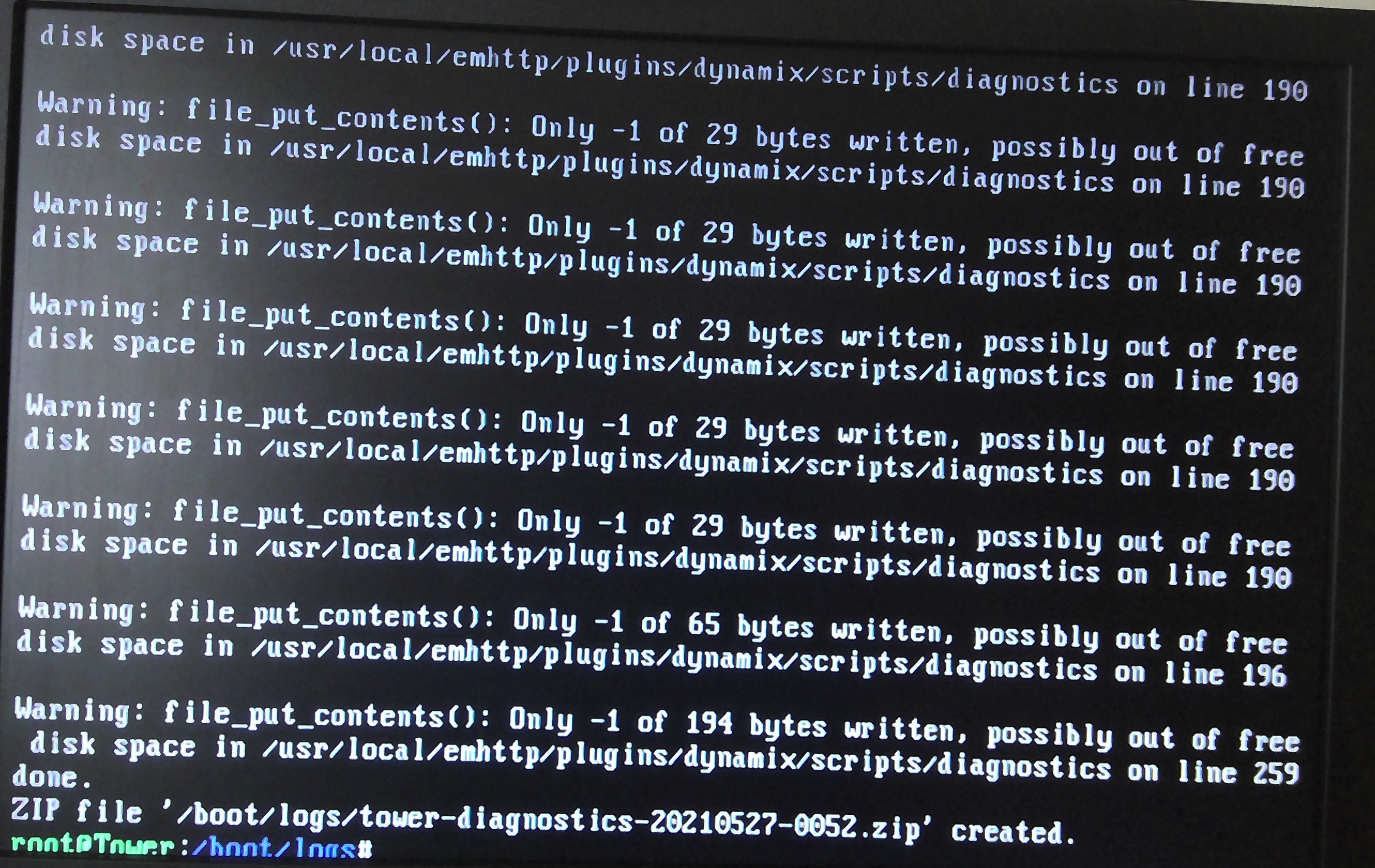

Type "diagnostics" in the console or use the local GUI to get them and post them here.
When running it i got a new error message: warning: no space left.
But on my usb stick as well as on my array and chache is actually still much space free.
tower-diagnostics-20210527-0010.zip
Now the correct ipv4 is displayed, but I still have no access to the webui.
tower-diagnostics-20210527-0052.zip

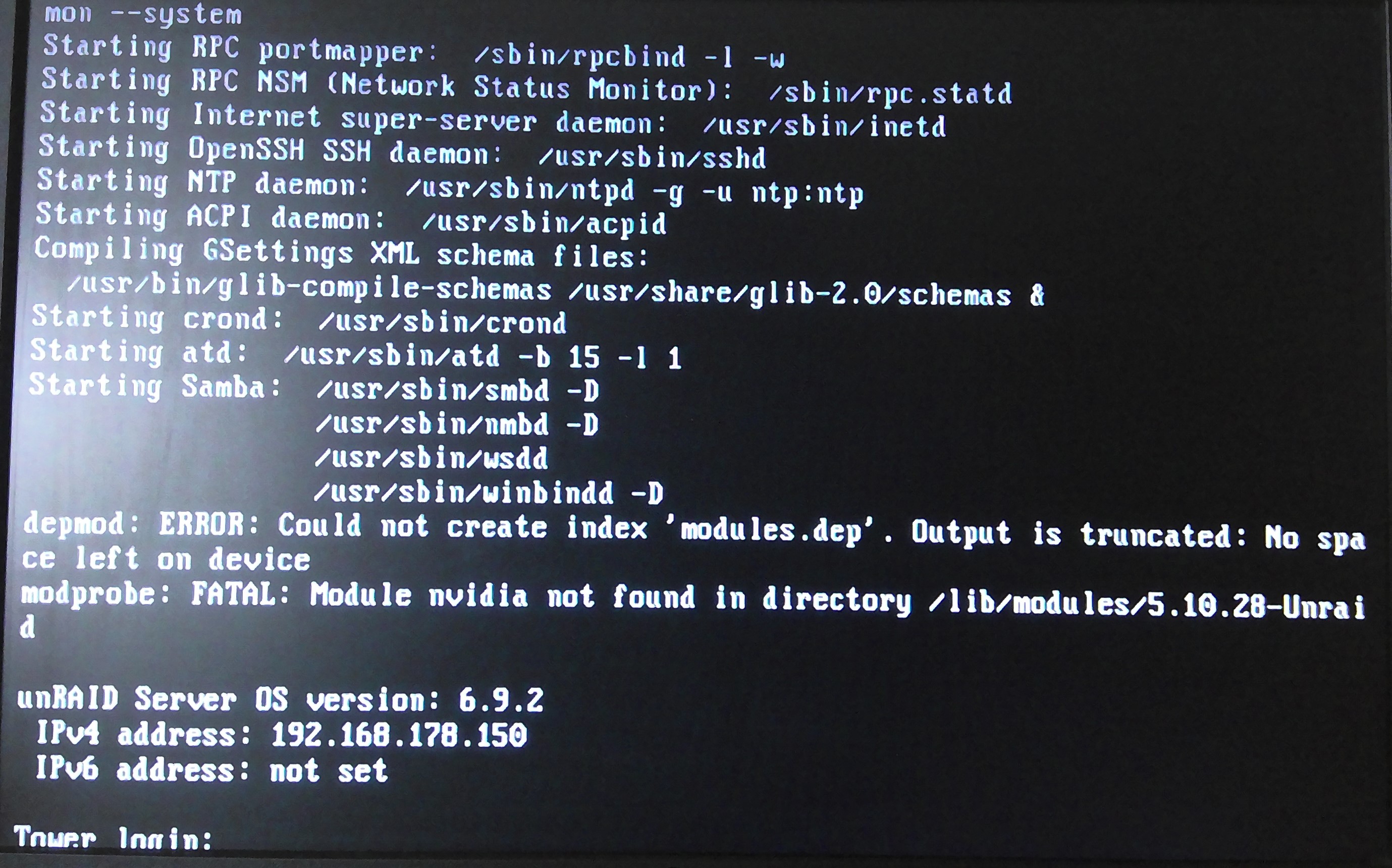

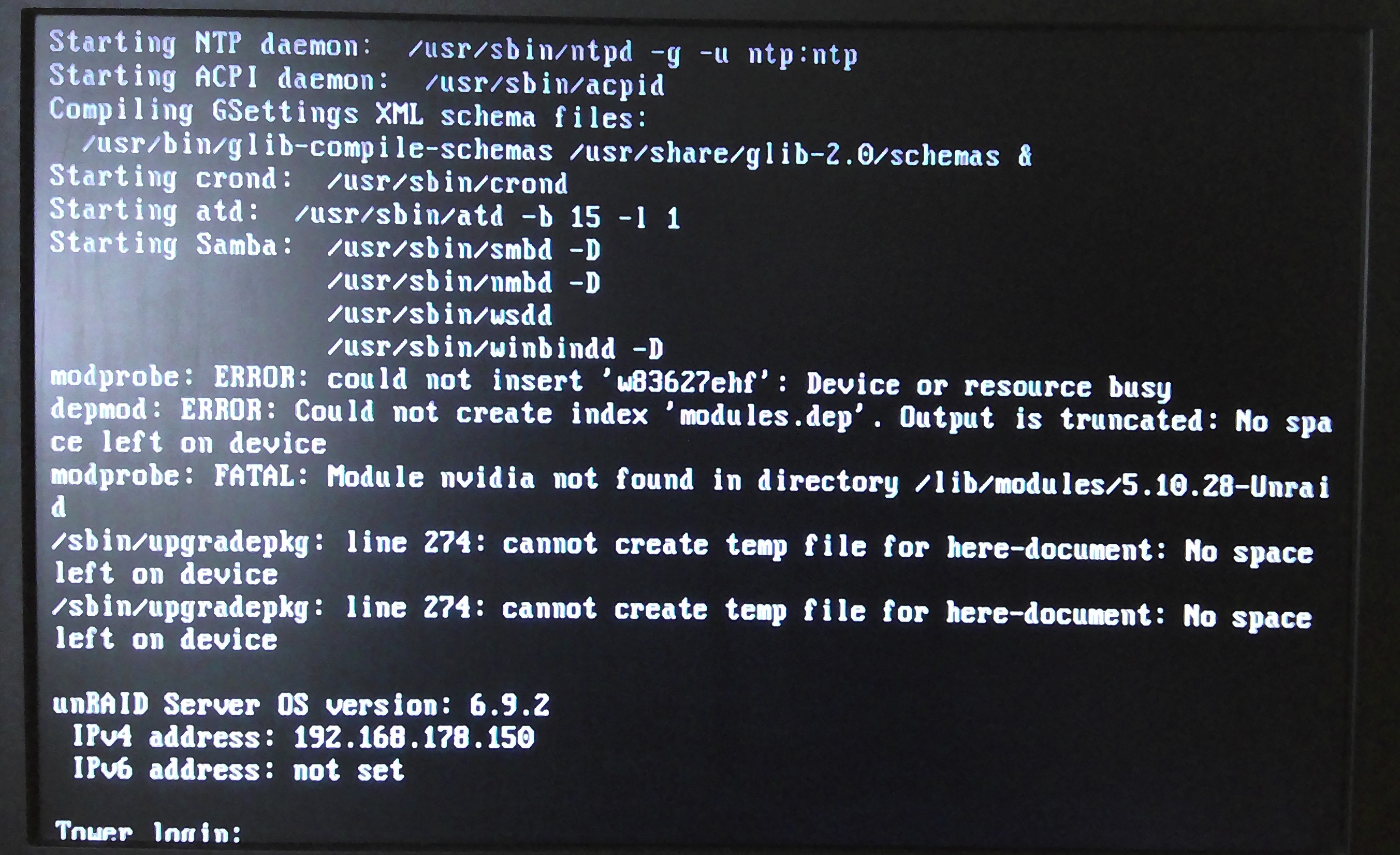

This is a picture from after the boot:
Looks like a flash drive problem, it's not booting correctly, try re-creating it or using a different one.
