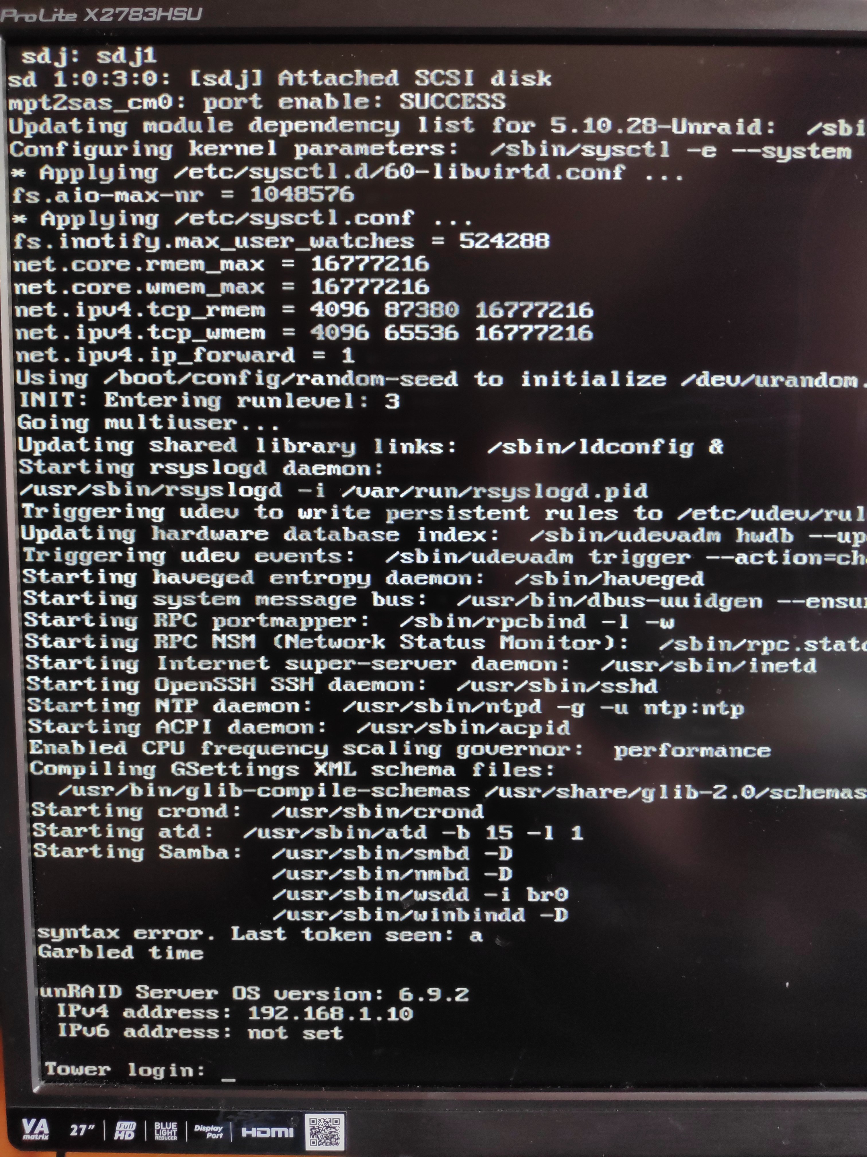

Since few days, this error appears just after the "Starting Samba" lines.
syntax error. Last token seen: a

On the screen attached to my Unraid server.
It shows all the services that are being launched, then there are 4 lines for "Starting Samba...." and then I have the error mentioned above.

It's from a plugin.  You can confirm by restarting in safe mode.  After that, to determine which one you have to uninstall them and then reinstall to see when the message pops back up.
Ok thank you, I'll debug that right now :)
Got it! The error disappeared once I uninstalled the "Tips and Tweaks" plugin. Mmmh, I need it so I'll try to reinstall it
EDIT: the error reappeared when I reinstalled the plugin. I will go to the Tips and Tweaks topic to report the bug. Thank you for your help!
