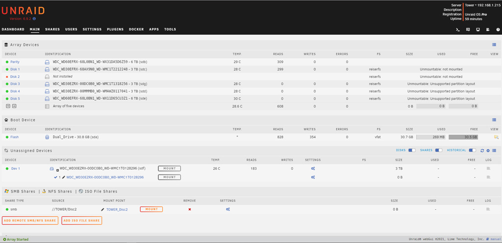

I can't seem to mount the disk that I unassigned.  When I click on the orange mount button it says "mounting" for just a second then goes back to "Mount".  Attached are a screen shot and diagnostics.
Any help would be appreciated.
tower-diagnostics-20210531-1922.zip
Edited by jwong0412
There's no mount option, that means no filesystem is being detected, you're trying an SMB mount, that won't work for this, post output of:
fdisk -l /dev/sdf
