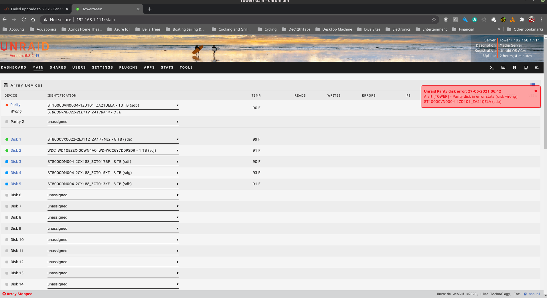

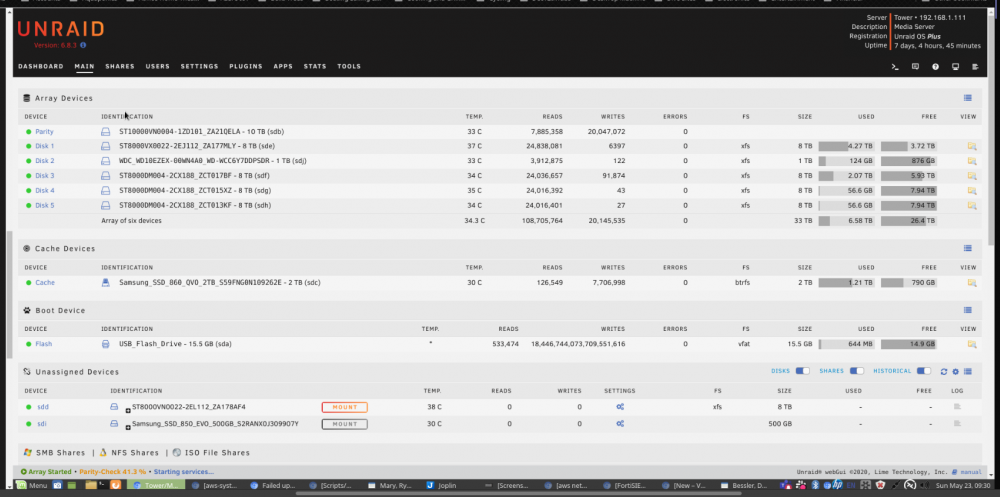

Here is a screenshot of how the disks were arranged prior to the upgrade:
1966130258_Screenshotfrom2021-05-2708-45-24.thumb.png.74463f250f3f66a4f8f5df286a2cbf78.png

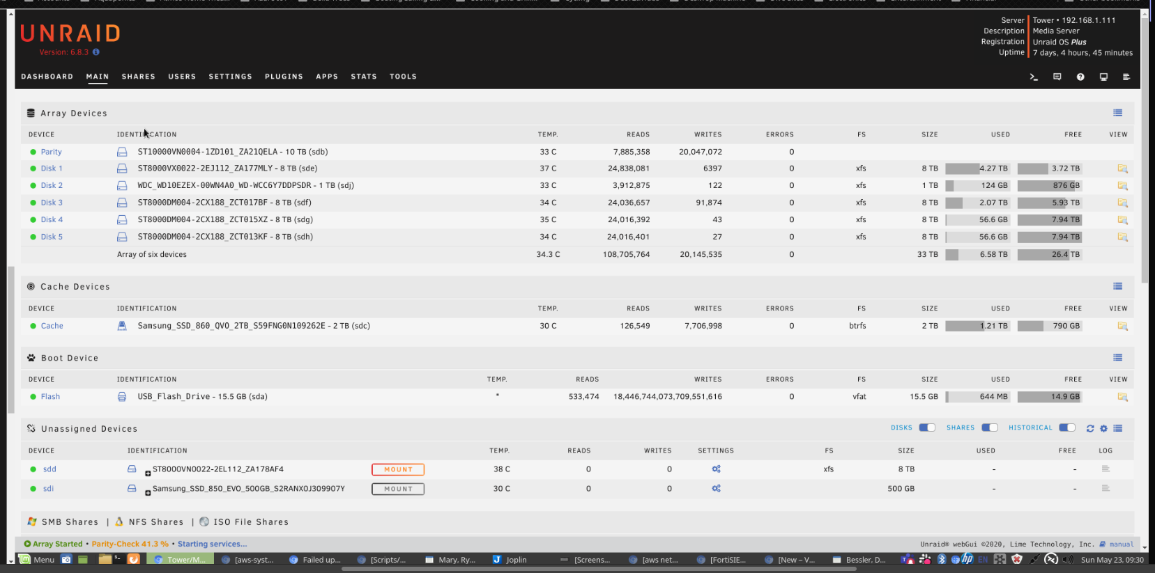

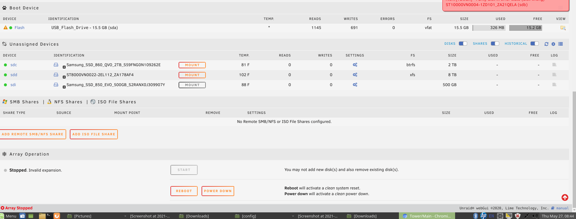

And here is a screenshot of how they are coming up currently:
1953823544_Screenshotfrom2021-05-2708-44-12.thumb.png.a134af1632e84cedf14a8fa5455dbae4.png
1021571566_Screenshotfrom2021-05-2708-44-40.thumb.png.0e663163a9d886942f132852fe44c0d2.png

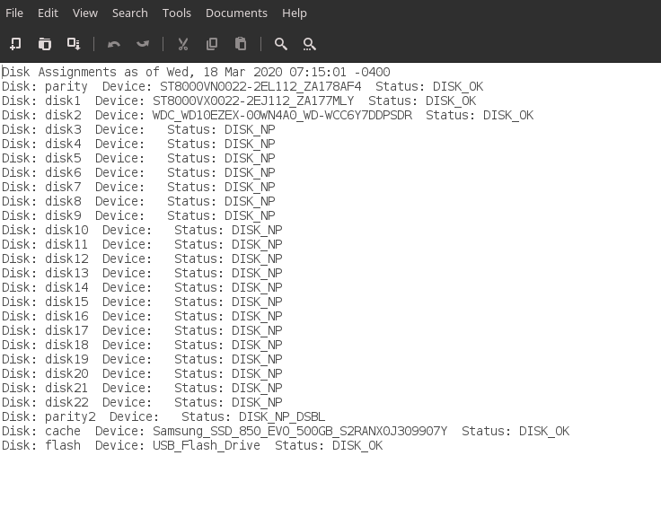

My DISK_ASSIGNMENTS.txt file  looks like this currently.
Can I just manually edit this file with the correct assignments?    If not, is there another way to get the disk organized back to the way they were and bring the array back online?
This file is created by the appdata backup plugin, and is simply a note for yourself.  The OS doesn't look at it at all, and the file that it does look at isn't human readable.

You're using an outdated backup, if you know the current assignments you can do a new config, assign all the disks are they were and check "parity is already valid" before starting the array.
Thank You.!  This worked perfectly.
