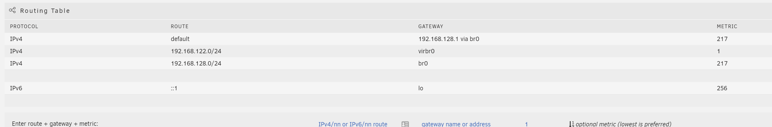

I am at my wits end with unraid.  I have a very basic unraid setup on a HP Proliant DL360p G8. Right now, only 2 VM's on it.
Everything works fine, except for the fact that none of the VM's can reach the internet other than on virbr0.  I need them to work on br0.
This is my current routing table.
any help is apprecieated as I am trying to use one of the vm's as a pxe server and the other as a domain controller so i need them both to be able to access the 128 network.
i should add attempting to give the vm's a static IP does not help.
Edited by OmegaXis
Issue turned out to be security somehow got turned on on my local switch, causing mayhem
