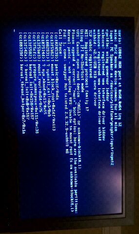

Hi everyone. I'm new to Unraid, and servers in general. I'm knowledgeable as far as computers go though. I built an unraid server about 2 months ago and it has been running fine. I'm running 2 Hitachi 2 t drives. Yesterday I stopped the array and shut down the computer to change the sata cables to right angle cables. Now when I try to boot it, starts to load and hangs in the loading process. I'm not really sure what to do, this is all new to me, and I know just enough to be dangerous. I'll try to attach a photo of the boot process. Any help would be greatly appreciated. I did go back and try the old cables to make sure I didn't have a faulty one.
put the flash drive in a windows machine and run a check disk on it to see if anything is wrong with it.
From there I would copy the bzroot and bzimage files back over to the flash drive and try to boot after that.
Thanks for the reply, would that be the images from the installation package? Also I'm assuming that won't affect passwords,  shares etc?
correct, just replaceing the bzroot and bzimage from the zip file that is on the Limetech site will not effect passwords and the like.
Thanks for your help,  that corrected the problem. Do you have any idea what may have corrupted that file?
