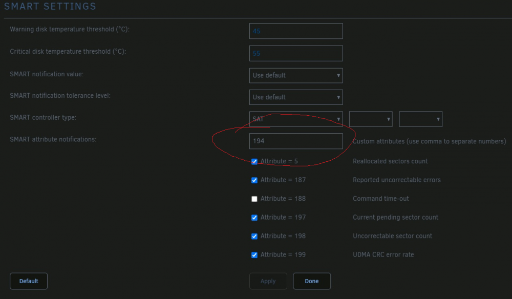

I made some progress, and can now see Smart Data under each disk.
I did this by intalling the plugin "hpsahba" from the CA apps, and then setting Default SMART controller type to SAT.
Though i do not get Tempeture readings still :(
Update again!
So i see that the Attribute of 194, Temperature celsius is there, but for some reason it still does not show on the Dashboard/Main page.

I got temperature data to display on the main screen by adding attribute 194 to SMART attribute notifications in each disk's smart settings
(wait up to one poling intervall for the temps to show up -> default is 1800 seconds).

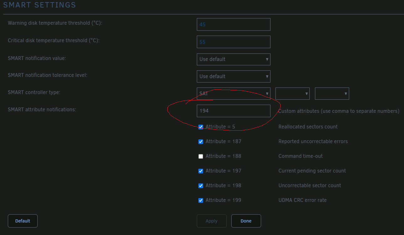

Though getting temps by filling in 194 does not seem to fix it for me :(
Even though i see the Attribute of Temperture celsius comes up as 194 in the list.
image.thumb.png.2980ae152c6ccebfe7ea64ca0079a7ef.pngimage.thumb.png.f88244995cad31534d991d4b0e5b3e2a.png
BR Apil
Even if you set "SMART controller type" to SAT?
