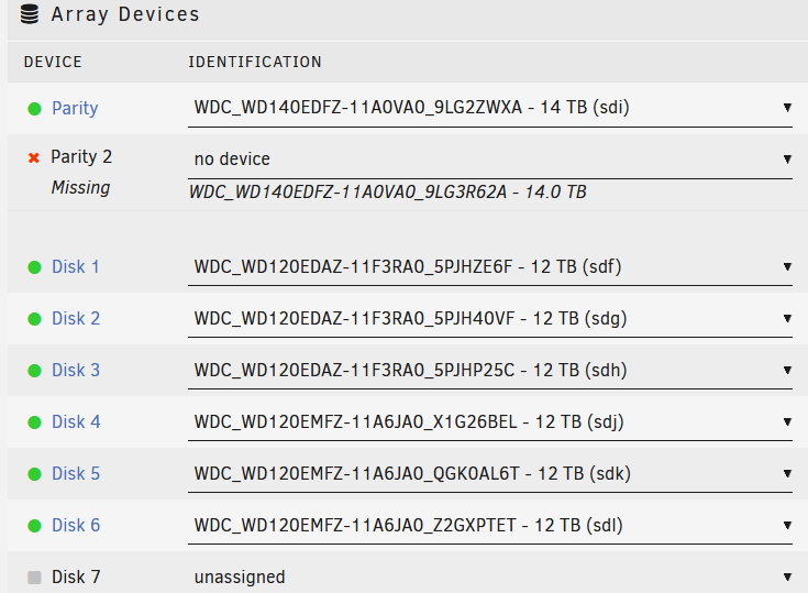

So I did a reboot of my Unraid server today in prep for the upgrade to 6.9.X
When my server booted back up my second parity disk was missing from the array (See Picture). I checked the cables and swapped the other parity disk into that slot to make sure it would still work and that one had no problems when I moved it. So the cables and LSI controller are good.

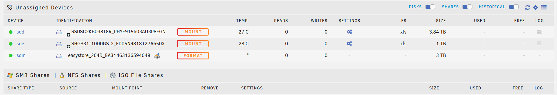

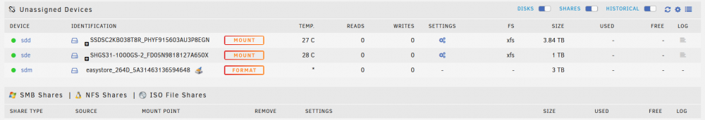

I pulled the HHD out of my server and connected it to a easystore USB board and the drive is now seen in unraid but as a 3 TB drive (See Picture.
