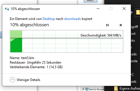

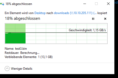

Hi there
form Windows PC to unraid Server
Copy to the disk share:
copy to the user share:
and from Unraid Server to Windows PC
copy from the user share: (doesn't matter from disk or user)

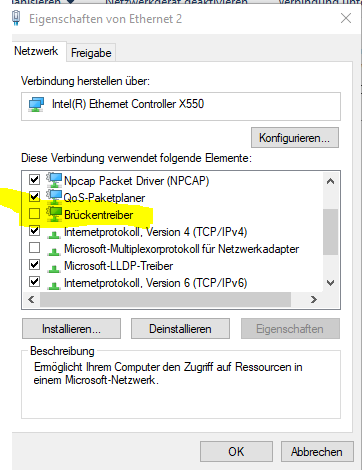

before it was even slower form PC to unraid also at diskshares ...  problem was the installed HyperV ... i had to deselect the bridgedriver otherwise it was 150-400MB/s

When i watched the Taskmanager Performance Monitor while transfering files, i could see both lanadapters, the 1GBit LAN and the 10GBit are working (1GBit was working at 100% Load). This was even if i did use the UNC path \\10.10.0.111\downloads both Adapter where transfering at the same time.
After i saw this i deleted all the used IP's and Names (192.168.0.159,192.168.0.111, WindowsPC, srvunraid) from the Router DNS/DHCP (Heimnetz>Netzwerk also the unused connections).
When the 1GB Adapter came back into the DHCP/DNS overview, i chanced the DNS NAME for the 1GBit from "unraid" to "unraid-1GBit" not sure if i had to do this step!
Because the 10GBit was not longer recognized by the router.
So Only the 1GBit Adapters have been recognized by the router now, like it should be.
After those changes i was beable to transfer with 1,15-1,16GB/s and i could see while transfer the 1GBit was not longer used while transfering to 10.10.0.111.

I had other problems in between like i said above the bridgedriver (improved from 200-350MB/s to about 600MB/s).
