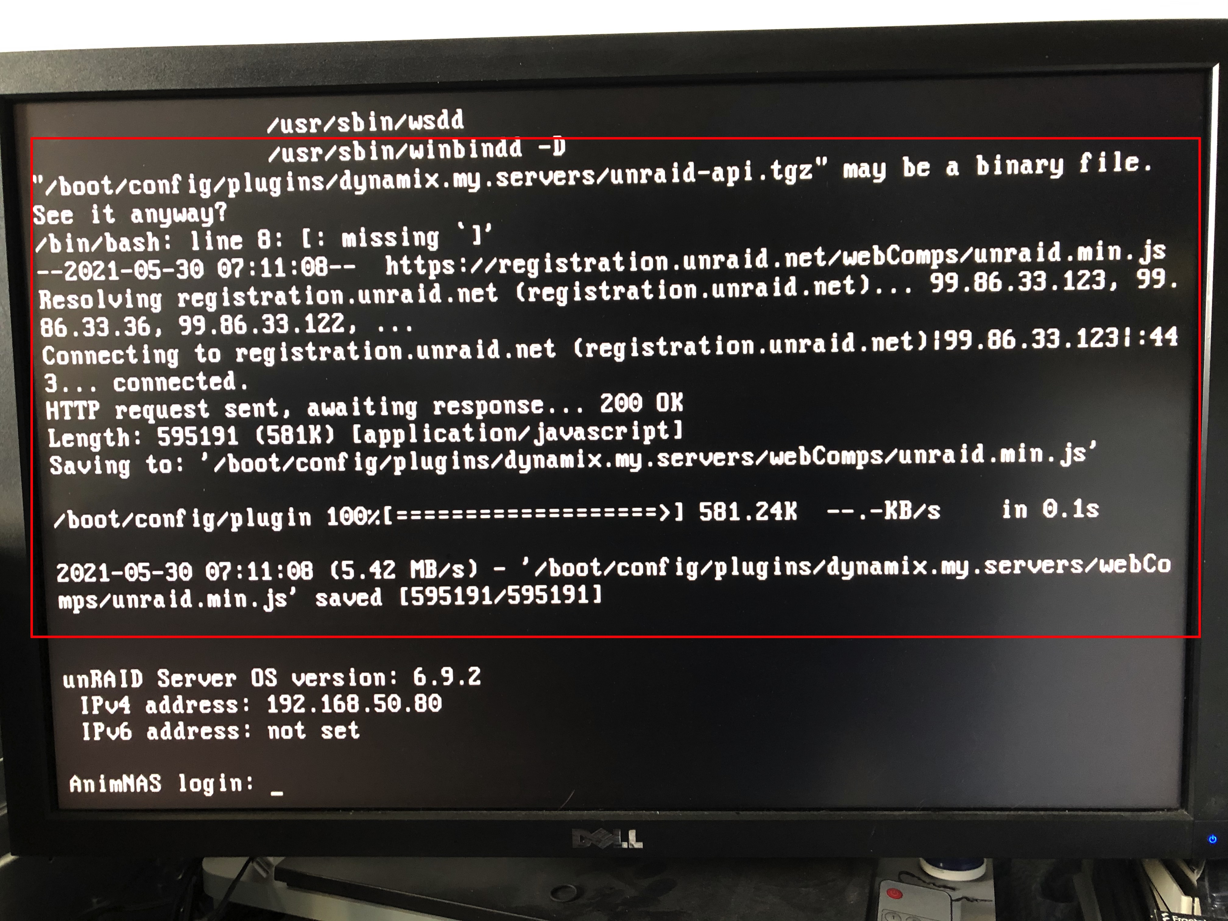

At the final stage of the boot process, I saw some messages on the monitor attached to the system. The area in the red rectangle shows some of the new messages I hadn't seen before, with an error on the 2nd line.
Before starting the array and the parity check (due to the unclean shutdown), I decided to try one more restart of the system. This restart had the same error as shown above, but of course was a proper restart so it cleared the requirement for a parity check. Regardless, I will start a manual parity check but I first want to troubleshoot the errors.

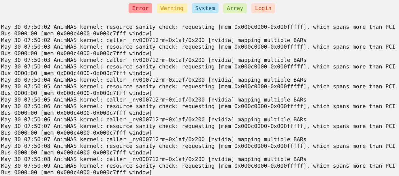

I also noticed that my system log is now filling up with messages about my Nvidia card; here's another pic showing the messages that are spamming the syslog:
Any recommended steps/actions I should take before starting the array and the parity check? Ideally I'd like to fix any errors and the cause of the syslog spam. Any assistance is appreciated! Thanks in advance...
That's a feature of the closed source Nvidia driver being called every second by the GPU Stats plugin. It's discussed in the support threads for both. The easiest way to get rid of it is to uninstall the latter.
It's interesting to note that after finding the memory fault mentioned above, these messages are no longer showing up in the syslog. Hopefully that will remain the case and/or the author of the GPU Stats plugin is eventually able to correct it.
