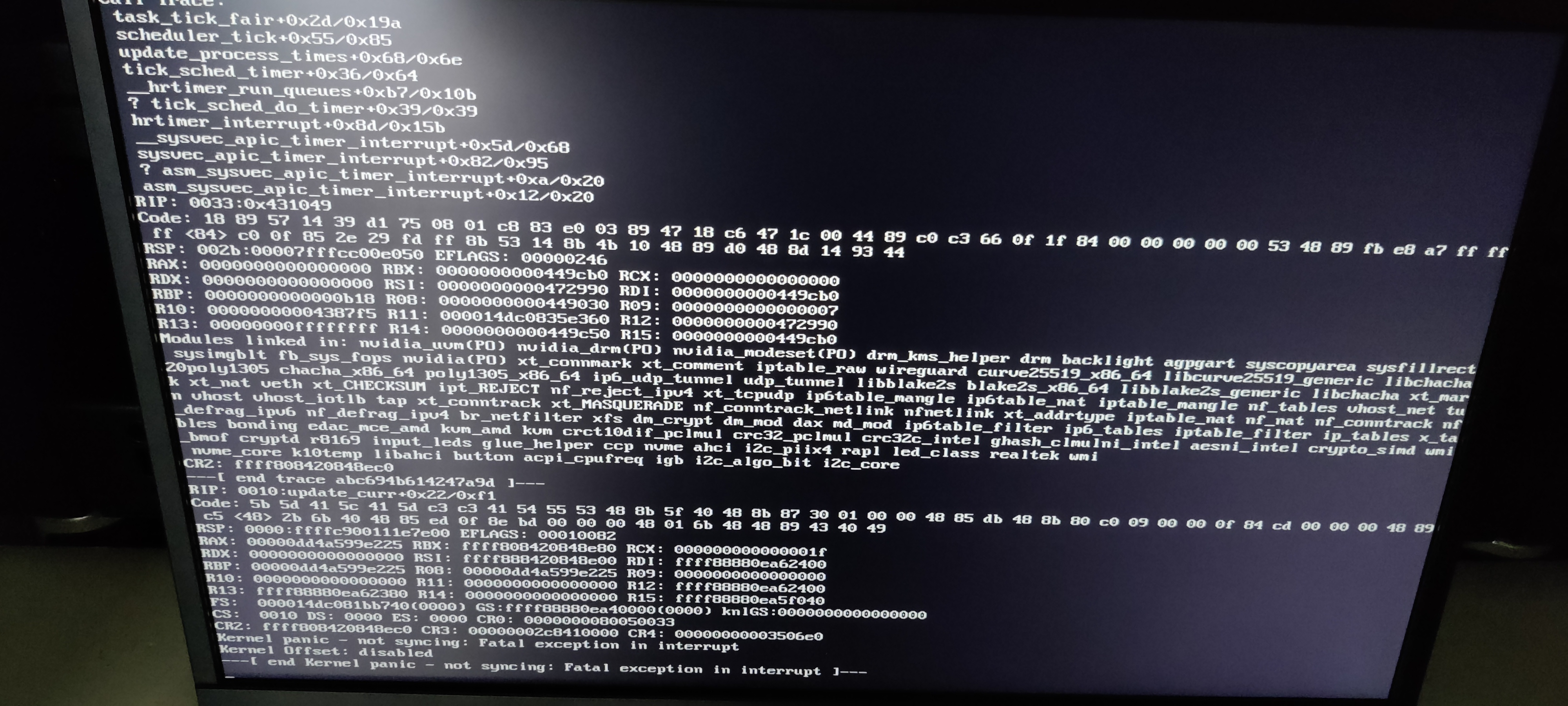

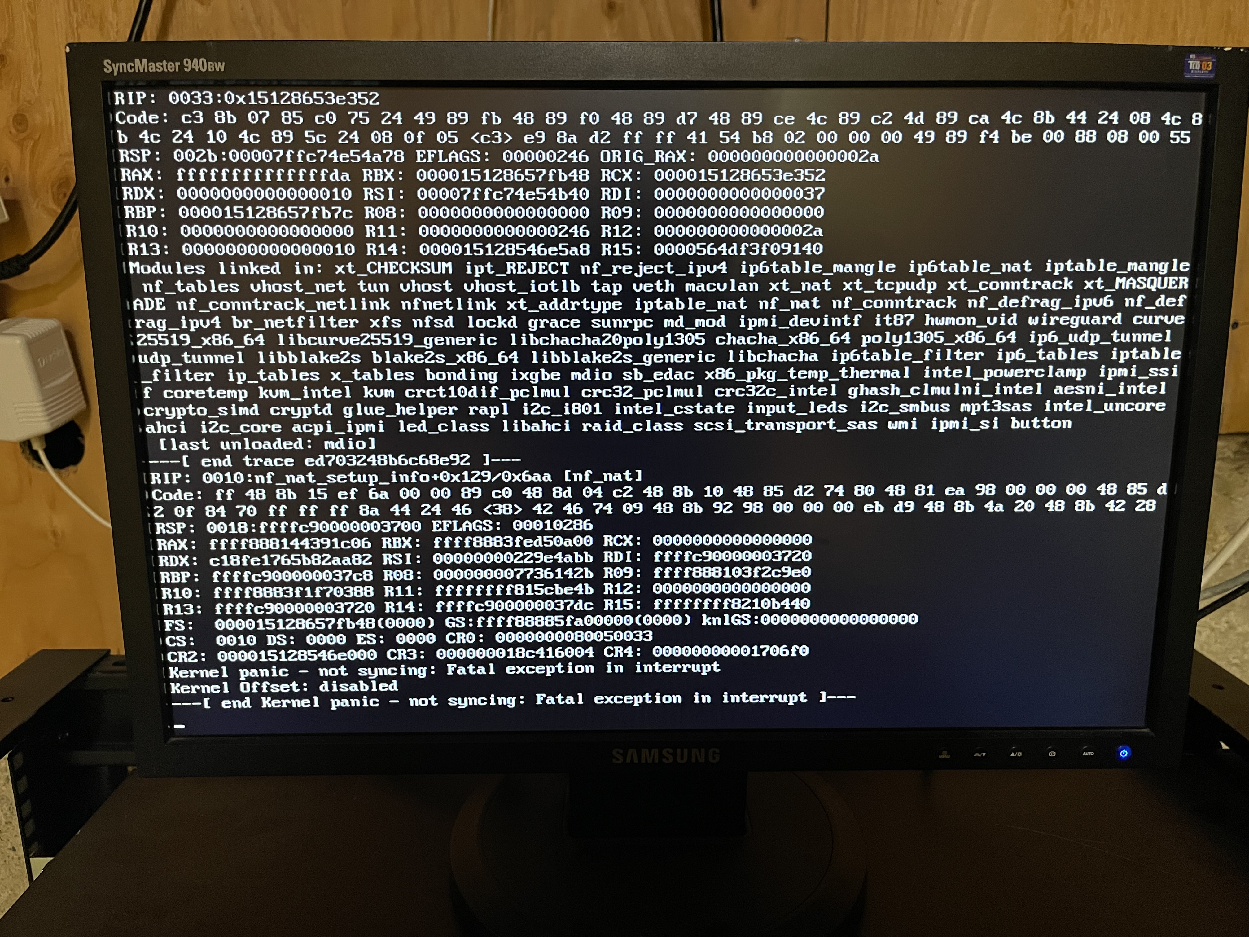

USB has been replaced with help from support on the licence. However after I left a parity check running overnight I awoke to a dead network (I run virtual pfsense and a dedicated dual nic) and the lovely kernal panic attached.
Powering off and on brought it back up and for now I'm running minimal dockers/vms and stopped the auto parity check.
It's probably just my paranoia now but I can't help but feel like this isn't a coincidence...

Ok so I managed a parity check a few days ago but I wanted to wait until it had been up and running for a least a week. As of Friday it has been. During this whole time I have had the nVidia plugin disabled/removed and now there are no crashes, USBs getting corrupted, other errors etc...
Also as my issues started after moving to 6.9 RC1 I definitely think the issues I've experianced since have to have been related to nVidia plugin or the change in how unRaid works with the driver. None of these issues were happening when the driver/support was still baked into the OS natively.
