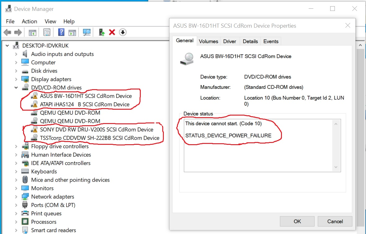

Hi All,
I am running the latest Unraid version and have both a Linux Mint VM and a Windows 10 VM configured. The problem is my Optical Drives work perfectly in my Linux Mint VM.  However, in my Windows 10 VM the Optical drives fail to work. As shown below my Device Manager window shows the Optical drives with yellow triangle warnings.  And the  PROPERTIES window for one of the drives reads: " The device cannot start (Code 10) STATUS DEVICE POWER FAILURE."
The SATA Controller card I am using has a Marvell 9512 chip. It also has a Marvell_SATA_V1.2.0.1049 - Windows 10. driver installed.

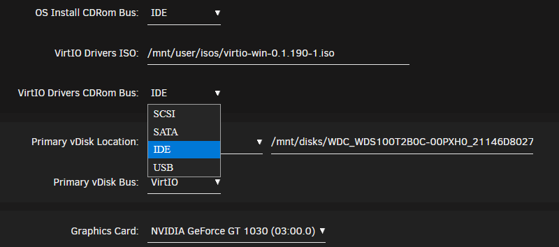

My WIndows 10 VM  Setup Form has IDE selected for both CDRom Bus parameters shown in graphic below:
Can anybody in the community please recommend a SATA controller Chipset that is compatible with both Windows 10 and Linux Mint that supports ATAPI devices such as Optical drives?  The chipsets below are the ones I have heard about for SATA controllers.

I never installed a win vm but from your screenshit windows sees that dvd/cd rom drives as scsi.
windows only sees scsi drives.
Did you add the scsi controller to your vm?

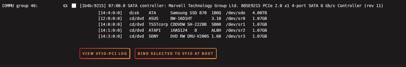

The screen shots below show how my Marvell card appears in the Systems Devices area.

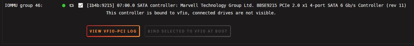

Below is how my Marvell SATA controller appears without a Checkmark applied. With no checkmark applied it does not appear in neither of my VMs:
However, after I apply a Checkmark then hit the BIND button and reboot the server the Optical drives work for my Linux VM but not for my Windows 10 VM due to how Windows 10 sees them as SCSI CDRom devices:
Again, thank you for your help and I hope this is the last brick wall I encounter in setting up my VMs.

mmm ok..you are passing through the marvell sata controller, so all the cd/dvd drives and your samsung ssd 870.
I found that this is not uncommon for devices attached to external controller with sata ports to show in windows as scsi devices, so I would say, nothing to worry about it.
The images you posted about the ide type bus for cdrom refer only to the virtio disk and to the windows installation disk: this has nothing to do with the bus type to which your your cdroms/dvd drives are attached, because you are passing through the marvell controller, so in your xml there is no trace of cdrom/dvd drives, which is correct (cdrom/dvd are downstream the marvell controller, you pass to the vm the controller, so everything that it's attached to the controller will be available on the windows vm).
Did you install any specific drivers for the marvell controller inside the virtual machine? I would search for specific drivers to install instead of using that provided by windows. Or, if you installed the specific driver, try to uninstall it and let windows install its generic driver.
You can try this:
https://www.tenforums.com/drivers-hardware/60112-marvell-92xx-sata-controller-6gb-driver-windows-10-1-2-0-1039-whql.html
You need to register to download files attached in the first post.
EDIT: I saw that you should have already installed the proprietary marvell driver; make sure the controller is using it and it's not overwrite by a win10 driver.
I saw also that one cdrom should work (the tsstcorp has no exclamation mark..what if you swap the asus with the tsstcorp drive?
Does the controller has a port to power it from the power supply or it gets power only from the pcie slot?

Good to learn the IDE / SATA / SCSI parameter settings I mentioned in my second post only impacts the Virtio drive and not the physical Optical Drives I have installed.  That information you provided allows me to remove these parameter settings from my troubleshooting list.  I honestly thought it was the probable cause to my problem.

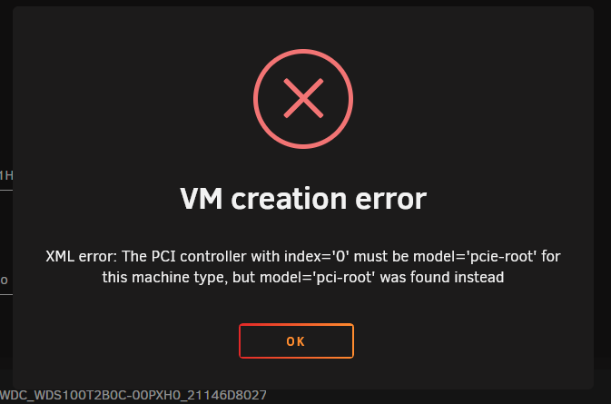

3 hours ago, slipstream said:
However, when I clicked on the "UPDATE" button to save my change to Q35-5.1 I got the error shown below:
Glad that you fixed it, and very strange that you had to disconnect/reconnect the ports..
For your info, the error above is because i440fx and q35 types have different topology:
The q35 has a pcie-root (bus 0), to which you can attach directly your pcie devices, different pcie-root-port (controller to attach other pcie devices on buses different than 0), different pcie-to-pci-bridge (controller to attach legacy pci devices), pxb-pcie (less common, pcie expander bus).
I don't know too much about i440fx, because it's an older chipset, better suited for legacy hardware, so I don't use it, but as far as I know it has a pci-root (bus 0, note that it's pci and not pcie), to which you can attach directly your pci devices and different pci-to-pci-bridge (controller to attach other pci devices on buses different than 0).
So the error is telling that there's an error in the xml, because with machine type q35 it isn't defined a pcie-root (that is the first error that shows, if you add/modify the pcie-root there are other errors in the xml) : the xml can be corrected manually, to fix the topology for that machine type, or most of the time recreating the virtual machine (with the same disk(s) attached, but different machine type) is faster.
I wrote this about the q35 type:
Edited by ghost82
Ghost82,
Thank you for your post.  It blows my mind the rabbit hole the error I got can take me down into.  I saw your link and my hat is off to you because that is some seriously complicated stuff.  🙂  At a basic level, I used the Windows 10 Template to build my Windows 10 VM.   And this template has i440fx as a default.
Do you think it is possible the UnRaid Developers could offer a Q35-5.1 version of the Windows10 template at some point in the future?
I honestly think a  Q35-5.1. Windows 10 template would have probably supported my Optical Drives with no complications in the beginning.
Edited by slipstream
