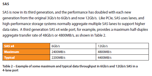

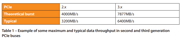

June 3, 20215 yr 5 hours ago, xxredxpandaxx said: "Supports 8 inputs and 28 outputs configuration" from the data sheet of the RES3TV360 OK, thanks, remember reading it only supported 24, and the Adaptec that uses the same PMC chip only mentions 24 devices. 1 hour ago, UhClem said: PCIe gen3 @ x8 is good for (real-world) ~7000 MB/sec. In my experience it's closer to 6000MB/s, even LSI mentions 6400Mb/s as the maximum usable: Assuming the OP is using SATA3 devices (not SAS3) it also means the PMC expander chip has something equivalent to LSI's Databolt, or max bandwidth would be limited to 4400MB/s with dual link, in my tests I could get around 5600MB/s with a PCIe x8 HBA and a databolt enable LSI expander, so it's possible that while that kind of technology certainly helps there could always be some extra overhead and not exactly the same as true SAS3 performance. As for the original question, the only x16 HBA I know of is the LSI 9405W-16i/e, though probably not worth the investment for this, and there's a risk that performance won't improve by much (if at all) unless using SAS3 devices.

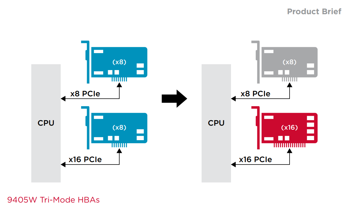

June 3, 20215 yr 1 hour ago, JorgeB said: LSI 9405W-16i/e On second though not sure these can use the x16 link with just two ports, might be just like two x8 controllers in one, product brief is not very clear:
June 3, 20215 yr 7 hours ago, JorgeB said: In my experience it's closer to 6000MB/s, even LSI mentions 6400Mb/s as the maximum usable: In my direct, first-hand, experience, it is 7100+ MB/sec. (I also measured 14,200+ MB/sec on PCIe3 x16). I used a PCIe3 x16 card supporting multiple (NVMe) devices. [In a x8 slot for the first measurement.] [Consider: a decent PCIe3 x4 NVMe SSD can attain 3400-3500 MB/sec.] That table's "Typical" #s are factoring in an excessive amount of transport layer overhead. Quote Assuming the OP is using SATA3 devices (not SAS3) it also means the PMC expander chip has something equivalent to LSI's Databolt I'm pretty certain that the spec for SAS3 expanders eliminates the (SAS2) "binding" of link speed to device speed. I.e., Databolt is just Marketing. Quote in my tests I could get around 5600MB/s with a PCIe x8 HBA and a databolt enable LSI expander, Well, that's two tests of the 9300, with different dual-link SAS3 expanders and different device mix, that are both capped at ~5600 ... prognosis: muscle deficiency [in the 9300].
June 4, 20215 yr In my direct, first-hand, experience, it is 7100+ MB/sec. (I also measured 14,200+ MB/sec on PCIe3 x16). I used a PCIe3 x16 card supporting multiple (NVMe) devices. [in a x8 slot for the first measurement.] I'm referring to HBAs, never got or seen someone get more than about 3000MB/s with a x8 PCIe 2.0 HBA and 6000MB/s with a PCIe x8 3.0 HBA, won't say it's not possible, just not typical, and we are talking about a HBA here. I'm pretty certain that the spec for SAS3 expanders eliminates the (SAS2) "binding" of link speed to device speed. AFAIK it's not part of the SAS3 spec, LSI has Databold, PMC mentions "SAS and SATA edge-buffering preserves customers' investment by improving performance with existing 3G and 6G drives", but in any case the wide link is never 12G native, so some performance degradation would be normal, I expect that if I used SAS3 devices with the 9300-8i and the expander I would get closer to the 6400MB/s typical speed announced.

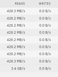

June 6, 20215 yr 22 hours ago, JorgeB said: I believe that in optimal conditions around 6500MB/s would be possible, don't think 7000MB/s+ can be done Remembered that while I don't have to hardware to test the real max for an x8 PCIe 3.0 slot, I can test with the HBA in an x4 slot, so same 9300-8i with 8 directly connected SSDs as above but this time I enabled bifurcation on the slot effectively turning it into an x4 slot: 02:00.0 Serial Attached SCSI controller: Broadcom / LSI SAS3008 PCI-Express Fusion-MPT SAS-3 (rev 02) LnkSta: Speed 8GT/s (ok), Width x4 (downgraded) So an x8 slot should be able to do around 6800MB/s, possibly a little more with different hardware, still think 7000MB/s+ will be very difficult, but won't say it's impossible, though again don't think the PCIe bandwidth is what's limiting the OP's speed, IMHO and more likely it's because of the expander being used with non 12G devices.
June 7, 20215 yr On 6/5/2021 at 5:44 AM, JorgeB said: Left side 8 SATA3 SSDs directly connected to an LSI 9300-8i, right side same but now with an expander in the middle, Excellent evidence! But, to me, very disappointing that the implementations (both LSI & PMC, apparently)] of this feature are this sub-optimal.. Probably a result of cost/benefit analysis with regard to SATA users (the peasant class--"Let them eat cake."). Also surprising that this hadn't come to light previously. Speaking of the LSI/PMC thing ... Intel's SAS3 expanders (such as the OP's) are documented, by Intel, to use PMC expander chips. How did you verify that your SM backplane actually uses a LSI expander chip (I could not find anything from Supermicro themself; and I'm not confident relying on a "distributor" website)? Do any of the sg_ utils expose that detail? The reason for my "concern" is that the coincidence of both OP's & your results, with same 9300-8i and same test (Unraid parity check) [your 12*460 =~ OP's 28*200] but different??? expander chip is curious.

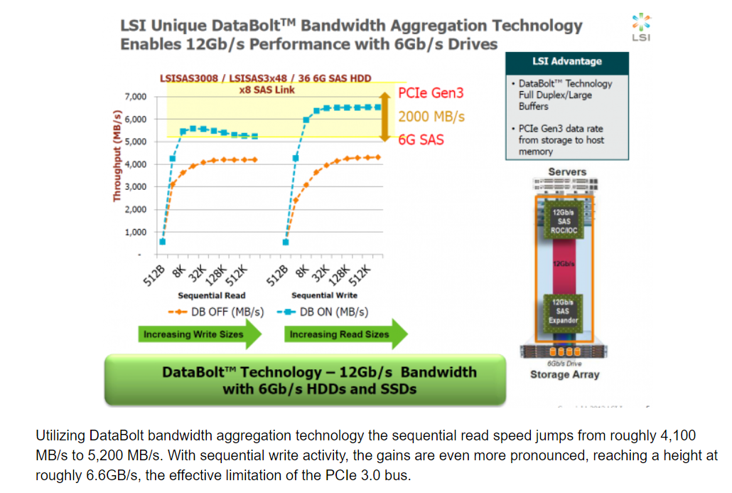

June 7, 20215 yr 2 hours ago, UhClem said: But, to me, very disappointing that the implementations (both LSI & PMC, apparently)] of this feature are this sub-optimal.. Interesting, I feel the other way, i.e. that they did a good job with it, I have an older HP expander that is SAS2 but SATA2 only, so with SATA devices it can only do 1100MB/s per wide link, without Databolt and the PMC equivalent, we'd only be able to get 2200MB/s per wide link with a SAS3 HBA+expander, so 4000MB/s (and around 5500MB/s with dual link) seem good to me, I think it's difficult to expect that a 6G link would have the exact same performance as a native 12G link. 2 hours ago, UhClem said: Probably a result of cost/benefit analysis with regard to SATA users It's not exclusive to SATA, it's link speed related, using SAS2 devices with a SAS3 HBA+expander will be the same, since they also link at 6G, and because there's no 12Gb/s SATA nothing much can really be done about it, SAS2 users can upgrade to SAS3 devices if they really want max performance, some more interesting info I found on this: Note that read speed aligns well with my results with dual link and the expander: Quote 10 x 510MB/s 12 x 460MB/s Write speeds are even better, basically same as native 12G, that is something I can never replicate since the SSDs I have for testing are fast at reading but much slower at writing. 2 hours ago, UhClem said: How did you verify that your SM backplane actually uses a LSI expander chip (I could not find anything from Supermicro themself; and I'm not confident relying on a "distributor" website)? Do any of the sg_ utils expose that detail? It can be seen for example with lsscsi -v: [1:0:12:0] enclosu LSI SAS3x28 0601 - dir: /sys/bus/scsi/devices/1:0:12:0 [/sys/devices/pci0000:00/0000:00:01.0/0000:01:00.0/host1/port-1:0/expander-1:0/port-1:0:12/end_device-1:0:12/target1:0:12/1:0:12:0]
June 7, 20215 yr 2 hours ago, UhClem said: Maybe try a different testing procedure:. See the attached script. I use variations of it for SAS/SATA testing. This was the result (PCIe 3.0 x4): ndk_sh t u v w x y z aa /dev/sdt: 409.95 MB/s /dev/sdu: 409.91 MB/s /dev/sdv: 409.88 MB/s /dev/sdw: 410.22 MB/s /dev/sdx: 410.31 MB/s /dev/sdy: 410.54 MB/s /dev/sdz: 412.00 MB/s /dev/sdaa: 410.20 MB/s Total = 3283.01 MB/s Ran it 3 times and this was the best of the 3, so strangely a little slower than an Unraid read check. 2 hours ago, UhClem said: Speaking of testing (different script though) ... Do you mind sharing that one also? Have 4 NVMe devices in a bifurcated x16 slot but no good way of testing, since an Unraid read check produces much slower than expected speeds with those. 2 hours ago, UhClem said: Total = 14204.5 MB/sec That's a good result, but I expect NVMe devices will be a little more efficient, consider that you have the NVMe controller on the device(s) going directly to the PCIe bus, with SAS/SATA you have the SAS/SATA controller on each device, then you have the HBA and only then the PCIe bus, so I believe it can never be as fast as NVMe, though I have no problem in now acknowledging that the PCIe 3.0 bus itself can reach around 7GB/s with an x8 link, but IMHO those speeds will only be possible with NVMe devices, still believe with SAS/SATA HBA it will always be a little slower, around 6.6-6.8GB/s. P.S. what adapter are you using for 5 NVMe devices in a one slot? Mostly find 4 device adapters to use on bifurcated slots, though I guess it will be more expensive due to the PICe bridge, still might be worth to get one more NMVe device in a single slot while maintaining good performance.
June 8, 20215 yr 20 hours ago, JorgeB said: Interesting, I feel the other way, i.e. that they did a good job with it, ... Certainly ... but as an old-school hardcore hacker, I wonder if it could have been (at least a few %) better. I have to wonder if any very large, and very competent, potential customer (e.g., GOOG, AMZN, MSFT), did a head-to-head comparison between LSI & PMC before placing their 1000+ unit chip order. Quote some more interesting info I found on this: That lays the whole story out--with good quantitative details. I commend LSI. And extra credit for "underplaying" their hand. Note how they used "jumps from 4100 MB/s to 5200 MB/s" when their own graph plot clearly shows ~5600. (and that is =~ your own 5520) I suspect that the reduction in read speed, but not write speed, is due to the fact that writing can take advantage of "write-behind" (similar to HDD's and OS's), but reading can not do "read-ahead" (whereas HDD's and OS's can). Quote It can be seen for example with lsscsi -v: Thanks for the verification.

June 8, 20215 yr 3 hours ago, UhClem said: Try the B option. It might help, or not ... Yep, that does it: ndk_sh B t u v w x y z aa /dev/sdt: 434.79 MB/s /dev/sdu: 434.79 MB/s /dev/sdv: 433.82 MB/s /dev/sdw: 435.06 MB/s /dev/sdx: 434.84 MB/s /dev/sdy: 434.54 MB/s /dev/sdz: 434.61 MB/s /dev/sdaa: 434.80 MB/s Total = 3477.25 MB/s And results were more consistent with multiple runs.
July 8, 20215 yr Turns out that contrary to what I understood at first the OP didn't have this HBA+expander combo yet, was just thinking of getting it and assumed the performance, I got one recently and tested it with an LSI 9300-8i and SSDs, note that these results are after updating the expander to latest firmware, it performed much worse without it, similar to what would be expected without Databolt or the PMC equivalent. Unraid read test (no parity): RES3TV360 single link with LSI 9308-8i 8 x 490MB/s 12 x 330MB/s 16 x 245MB/s 20 x 170MB/s 24 x 130MB/s 28 x 105MB/s RES3TV360 dual link with LSI 9308-8i 12 x 505MB/s 16 x 380MB/s 20 x 300MB/s 24 x 230MB/s 28 x 195MB/s So up to roughly 4GB/s with single link and 6GB/s with dual link, not that different from the LSI SAS3 expander, unfortunately since my LSI expander is on a backplane I can only test that one with up to 12 devices, this combo with SAS3 devices should be capable of around 4.4GB/s with single link and 7GB/s with dual link. Curiously total bandwidth decreases with more devices, possibly due to the hardware used or Unraid but don't think so, using @UhClem's script only got around 4500MB/s max with dual link (with or without the B option) using 12 or more devices, so there shouldn't be a CPU/Unraid bottleneck, I suspect the technology used by PMC to emulate a 12G link with 6G devices loses some efficiency as you add more devices.
