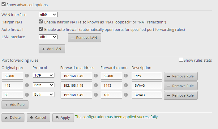

Somehow, my router, an edgerouter-x 5 port lost its configs without me backing it up.  I re-added port forwarding to get Ombi, nextcloud and plex back up, but for some reason, I am not able to reach nextcloud and ombi from my LAN.  I can reach the sites when not connected to my home network.  What am I missing?  I checked the conf files in nextcloud, etc and they are the same as when I installed using spaceinvader one's tutorial 2 years ago.  Am I missing a port forwarding?

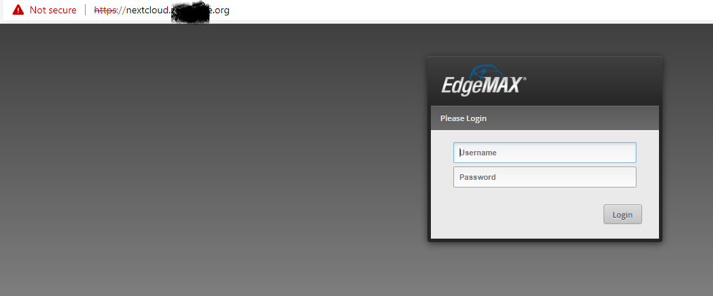

when I try to get to nextcloud.XXXXXXX.org, the broswer goes to my router ip (192.168.1.1) but shows nextcloud.XXXXX.org in the address bar.
