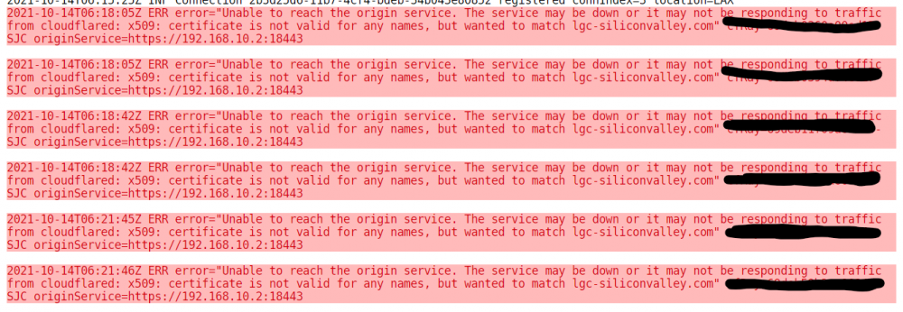

For those getting spammed with "Unable to reach the origin service. The service may be down or it may not be responding to traffic from cloudflared: EOF" errors. I fixed the issue on my end by renewing my SSL Cert after the tunnel was up and running and restarting cloudflared.
I'm using an origin cert. on NPM not a  lets encrypt so renew the origin cert?
-i renew the cloudflare origin cert. and updated NPM and all subdomains to newly created cert. still getting spammed errors.?
-i was able to resolve this spamming error by removing any down or unused cnames from CF.
Edited by Tolete
update
tried your solution, didn´t work for me :( still x509 error when not using a own hostname for each subdomain

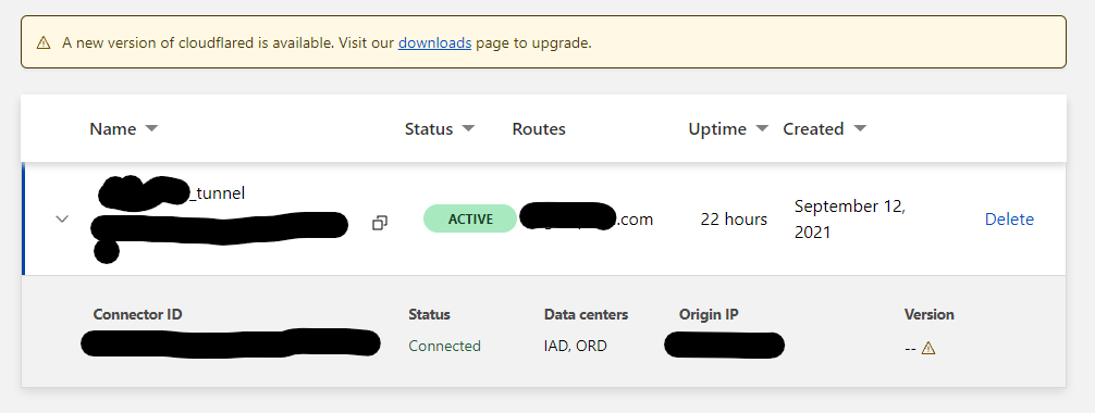

Question - What application is this in the screenshot above? Please comment. Thanks in advance
Edited by Shomil Saini
adding www exception, version update
9 hours ago, Shomil Saini said:
Hey guys,
Was going through the same trouble and stumbled on this post. Issue is resolved with using subdomains as others have mentioned. Cannot use the CNAME - WWW (www.yourdomain.com).
Also, you cannot use CNAME with nothing mapped to it. It will give the same error. For now version 2021.10.3 works as well.
It is on the cloudflare website. dash.teams.cloudflare.com
Then click Access>Tunnels
Oh, thanks a bunch. :) Is it a paid service as I only have a free account to tinker with.
I went to that site and it asks to create a domain and stuff. Just want to know what I am getting into.
