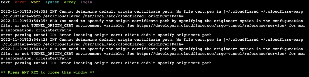

  • Hello,   I get the error below   2021-06-07T17:15:06Z ERR error="Unable to reach the origin service. The service may be down or it may not be responding to traffic from cloudflared:

Solved: For anyone else experiencing the same issue, to fix this do the following:
1. set your NPM host to http
2. Get the origin server key and cert being used by your tunnel and create separate files for each (name.key, name.pem)
3. Go the the SSL tab in NPM and create a new custom certificate using the .key and .pem files created
4. do to SSL tab for the host and add that certificate
