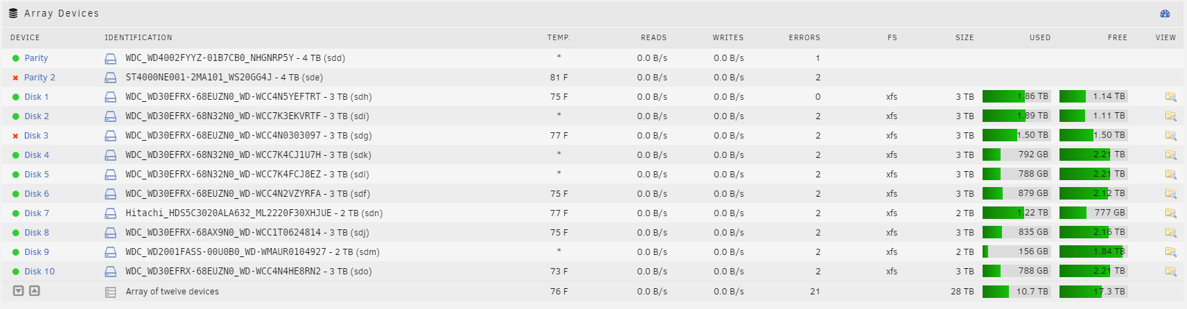

Yesterday my server emailed me saying it had array errors, 3 disks with read errors (Parity disk, Parity disk 2, and Disk 3).  It disabled the Parity Drive as well as Disk 3, but things kept running.  I was thinking the chances of three drives having errors all at once out of nowhere seemed a bit low, so I doubted it was actually bad drives.
Turns out the following below is not the problem.  Problem just came back and shows 11 drives with errors.  I'm at a loss and have diagnostics if someone smarter than me can make sense of them.

I did run tools -> diagnostics several times, but I now know that every time you reboot you might miss something important.  These files along with the syslog did show errors, but I'm hesitant to  believe it as it has since rebuilt the parity drive, and is currently 66% through rebuilding disk 3.  The syslog currently shows only the errors for the disabled drives, prior to me removing them and adding them back.

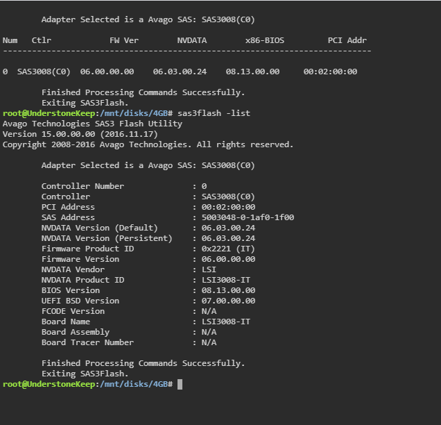

I have been searching and this seems to be exactly what I am experiencing.  In the logs I also see the exact same error across multiple drives on the exact same sector.  As with that poster, I also have a Supermicro Chassis with 12 drive bays.  I am going to try what they tried (disable spin down) and will see how that works.  I wouldn't think it'd be a power issue as it has dual 1000w power supplies.  I'll also try to update the firmware on my card (Supermicro Card, LSI3008-IT, running firmware 6.00.00.00-IT)  The card and cables haven't been moved so nothing has come unseated or anything.

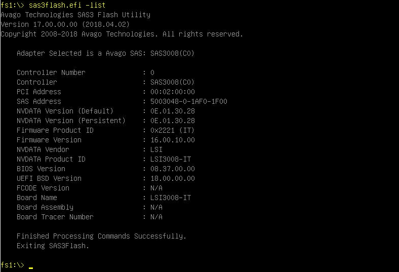

Fist thing would should do is updating the LSI firmware, if still issues after that see if disabling spin down helps.
I updated the firmware to the latest on the supermicro site.  I'm nervous to tell the drives to spin down yet, I might give it a day or so.  No issues since telling them not to spin down.  I'll see how the newer firmware does then reenable spin down.  Thanks again, appreciate it.
updated:
original:
