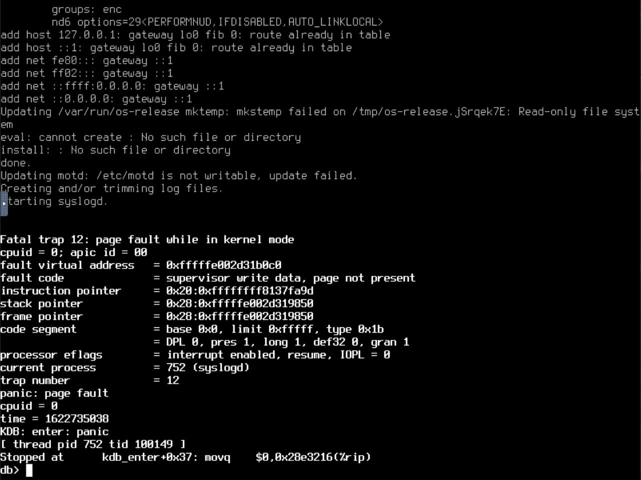

Hey,
I'm running UNRAID on a Ryzen 5 5600X and MSI MAG B550M MORTAR WIFI and I cannot get pfSense to boot if you use host passthrough.
My Windows 10 and Windows Server VMs are working using host passthrough with no issues. I suppose it could be a FreeBSD issue.
I'm using a fresh FreeBSD template and have tried pfSense 2.4.5, 2.5.0, 2.5.1 and 2.5.2 beta (with and without NICs passed through).
For now, emulating the CPU with QEMU works but it doesn't support AIS which is going to be a problem in the future.
Has anyone experienced this?

Same issue here unfortuantly - same failiure at the same point. I have used the FreeBSD / Linux and Custom templates. I have attempted with unraid 6.8.3 and 6.9.1
5600x with a x470 mobo.
I have tried altering the bus type of the ISO and of the guest's disk. I have used the same ISO's as you (checked the sha265) with and without NIC's. I have allocated 1 core (not CPU0) and multiple cores.
If I remove my unraid USB stick and try the pfsense ISO burnt to a USB drive I manage to reach the setup screen.

Hey Impossible,
Thanks for the reply, it's good to see that I'm not alone.
If you passthrough a USB stick and install successfully, does pfSense boot normally once the installation is complete?

My pfSense VM is still running emulated, it's running fine but I would like to get moved over to host passthrough.
I was thinking of just switching the xml config but I haven't messed around yet.
I just updated my processor from 3900x to 5950x and now getting the same error.  I ended up emulating the cpu to get it working.  Hopefully I can figure out how to get passthrough working again.
I have a 3900x and the same issue, the only thing that worked was to emulate to Skylake so AES NI is present:

3 months later and I still haven't figured this out.
I've tried passing through a USB with the pfSense installer on it.
I've upgraded to the latest MOBO BIOS.
Maybe an unraid update will fix this?
I am also having this issue for my 5950x and emulating CPU as a workaround on 6.9.

I haven't tried the 6.10 RC although I have been trying to find a changelog or something that might point to issues with AMD CPUs being resolved.
All I've been able to find so far shows that there have been some onboard GPU improvements for AMD and Intel.
So I'm not sure if 6.10 is going to fix the issue either.
I had this same issue on my CPU (5900) and it looks like 6.10RC2 solves it. Maybe the devs will mention something about this in the changelog, after the new version becomes stable.
Hey @MrX, this is really good news, thank you for checking in and confirming.
I look forward to the stable release of 6.10
I just spent 1 hour trying to figure this out.  Makes me feel better that I am not the only one with the issue.
Same issue when swapping from 2700 to 5700G. I can confirm on my side that updating to 6.10 RC2 fixed the issue.
