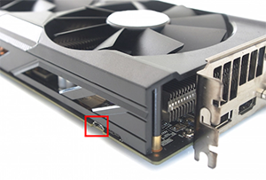

3- Some of the R9 380 have a physical switch, to use the gpu in uefi or legacy mode. Check your instruction manual and set it to use uefi, since you are using ovmf. Below an image of the switch on a R9 380 Nitro.
To check UEFI vs legacy mode you can use gpuz to see if there's a check next to "UEFI".
