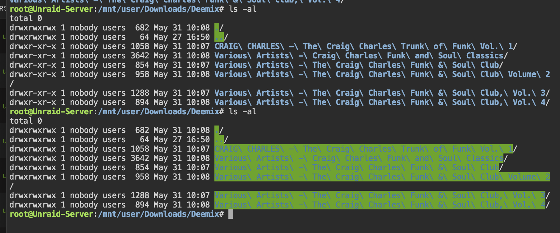

I have a fair few containers and a Server2019 VM, with shares mapped via a root share. This works well but every few days the permissions change and no longer have edit rights to the shared folder. This is the same when mapped to the share in my VM or connecting from ym Macbook. Running the tool 'docker safe perms' fixes the permissions but they keep reverting.
I've run ls -al before and after fixing the permissions so can see whats being changed, see attached screen shot.
I've also attached my servers diagnostics for info.

Thanks for the reply. Yes that was my first though, however permissions for most other folders and files in the share are being changed too, so harder to track down as have lots of container mapped to the whole array. I can at least narrow it down to container that have access to the share though.
There were a few containers without a PUID and PGID variable, so added those, but that didn't fix the problem. Think the next step is to look at umasks, I've ssh'd into each container and they've all running under 0022. Had some good advice in the unraid subreddit, sounds like changing umasks to 002 or 000 where supported might work?
