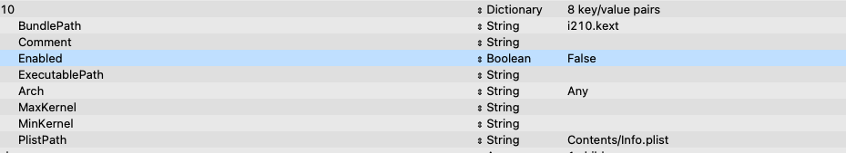

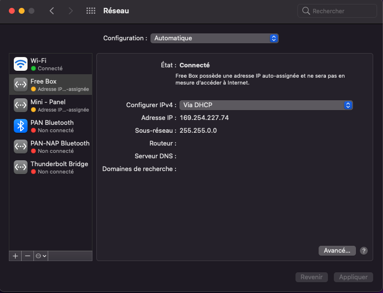

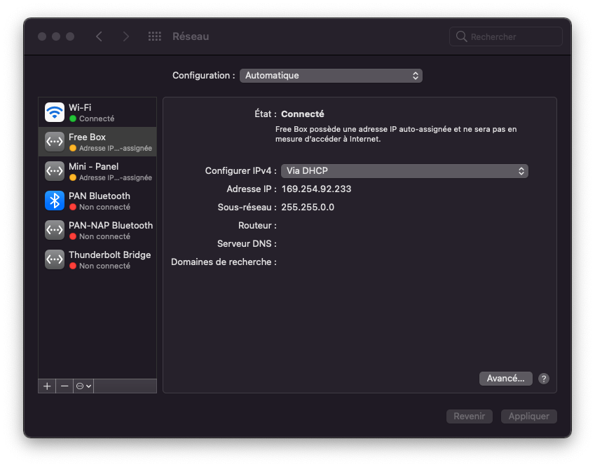

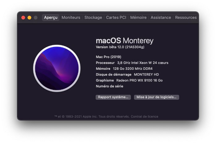

August 20, 20215 yr Vendor: 8086 and Product Id 1533 (See Screenshot) Monterey version 21A5304g (See screenshot) I don't understand the question What is the output of kextstat? (Sorry I'm a newbie in this field) Here is my Ioreg IORegistry Arrakis.ioreg Experiences Modules are assigned with the wrong IP address and subnet (See Screenshot) with your kext. In this state the system is very stable. To have try other solutions as long as the modules are not assigned like in the screenshot. This is Kernel Panic at various stages before logging in or after logging in. There is also the case with the 2 ethernet ports disabled in the Monterey system preferences. The system is stable. Edited August 20, 20215 yr by Arrakis
August 20, 20215 yr 2 hours ago, Arrakis said: Vendor: 8086 and Product Id 1533 (See Screenshot) Monterey version 21A5304g (See screenshot) I don't understand the question What is the output of kextstat? (Sorry I'm a newbie in this field) Thank you for the data. From what I see the kext is loaded instead of the dext, so the injection kext is working; what happens if you don't use the injection kext (and use the dext)? I would not worry too much now, monterey is still bugged as hell and we are still at beta 5. When big sur came out we had a lot of issues with networks in the beta phase, most of the issues were solved by apple in subsequent releases. Btw, kextstat is a terminal command to see what kexts are loaded in mac os, but I can see from your ioreg that the injection kext is loaded.

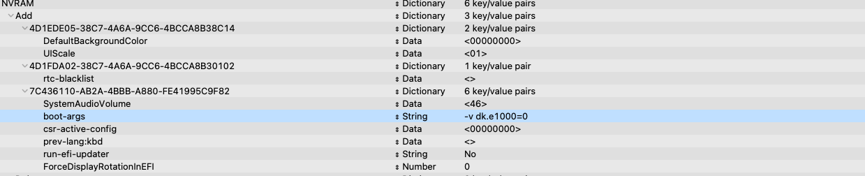

August 21, 20215 yr Hello, I tried with the kext turned off and without the DEX. It's the same see screenshot. Since I'm not sure which DEX command to turn it off I have attached a screenshot. I remade Ioreg under Monterey. Ioreg Arrakis.zip
August 21, 20215 yr 3 hours ago, Arrakis said: I tried with the kext turned off It seems that the same kext is loaded (AppleIntelI210Ethernet), so I think the injector kext is useless, as in this case the "correct" kext is loaded, apple fixed one thing and broke another one, typical....
