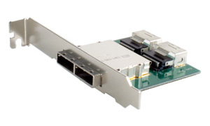

1. The poster says he used an HBA card with external ports  in primary case (the actual server) which uses some cable to connect to a "SFF-8088 to 8087 adapter" in secondary case that in turn connects to 24 port RES2SV240 expander (powered by molex) which in turn has breakout cables to power the drives in secondary case. Is that a correct synopsis?
Assuming the above is true....
2.  Would this HBA card work?
3.  What is the name of the cable he used? (assuming SFF-808 but just to confirm)
https://www.amazon.ca/Deconn-External-SFF-8088-Cable-Attached/dp/B00S7KTXW6/ref=sr_1_1_sspa?dchild=1&keywords=sff-8088&qid=1623055881&sr=8-1-spons&psc=1&smid=A3CMOOTCHB9X54&spLa=ZW5jcnlwdGVkUXVhbGlmaWVyPUExVjBDRVY5STM4RkRYJmVuY3J5cHRlZElkPUEwOTI5ODk2M1FYSTc2SEJDREM1NyZlbmNyeXB0ZWRBZElkPUEwNTM5OTgyMTRKQ1BKWldDV0g2TyZ3aWRnZXROYW1lPXNwX2F0ZiZhY3Rpb249Y2xpY2tSZWRpcmVjdCZkb05vdExvZ0NsaWNrPXRydWU=
4. What SFF-8088 to 8087 adapter would you recommend that compatible with Unraid?
5. What would power the above SFF-8088 to 8087 adapter? Is there some cable I could use to connect to main case?
Yes.
Any one will work, they are transparent to the OS.
It's not powered, looks like this:
