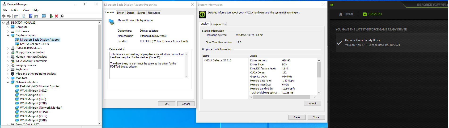

3 hours ago, Siren said:
Last thing:
If you look at the second window from the left, the error points to bus 0, slot 8, function 0.
This refers to the (wrong) audio part of the GT710, not the 3080 ti (see the source address and the wrong target address set in the vm below):
      <driver name='vfio'/>
      <source>
        <address domain='0x0000' bus='0x01' slot='0x00' function='0x1'/>
      </source>
      <alias name='hostdev2'/>
    </hostdev>
Update (added): there's no trace of the 3080 ti: this suggests that the same drivers cannot be used to have both gpu installed in the same system, and you probably installed the driver for the GT710 --> see comments in the next reply
Apart this, are you sure you can run an Ampere card and a kepler card on the same build with the same drivers?It's just a question..check that the drivers supports both generations, otherwise one of the 2 cards could not be installed.
For example I have a bare metal windows machine with a very old nvidia 8400GS and a newer GTX Titan Black and there's no way to have both gpu installed in the same system.
Update:
just checked, there should not be any issue about compatibility with the same driver:
Edited by ghost82

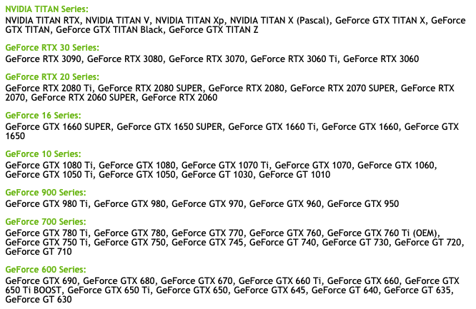

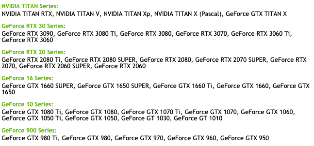

Sorry, not true with driver version 466.63 (there's only the 3080ti, not the GT710):
Driver v. 466.47 according to nvidia should support the GT710 and the 3080, but 3080ti is not listed...not sure you can run both...:
