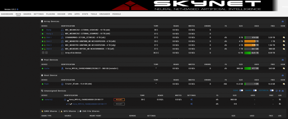

So long story short, I started the new server, it boots nicely, and logs-in (checked from WebGui).
However there is a problem with the nvme-Cache-drive.
MB_Bios sees the Force MP510-drive fine.
Unraid also sees it, but it sort of "ejects it"? I dunno 🤷‍♂️..
Also if I press the "mount"-button (see picture) nothing happens, it starts to mount (with the spinny-circle) for like .5seconds, before it turns back to the Mount-button.

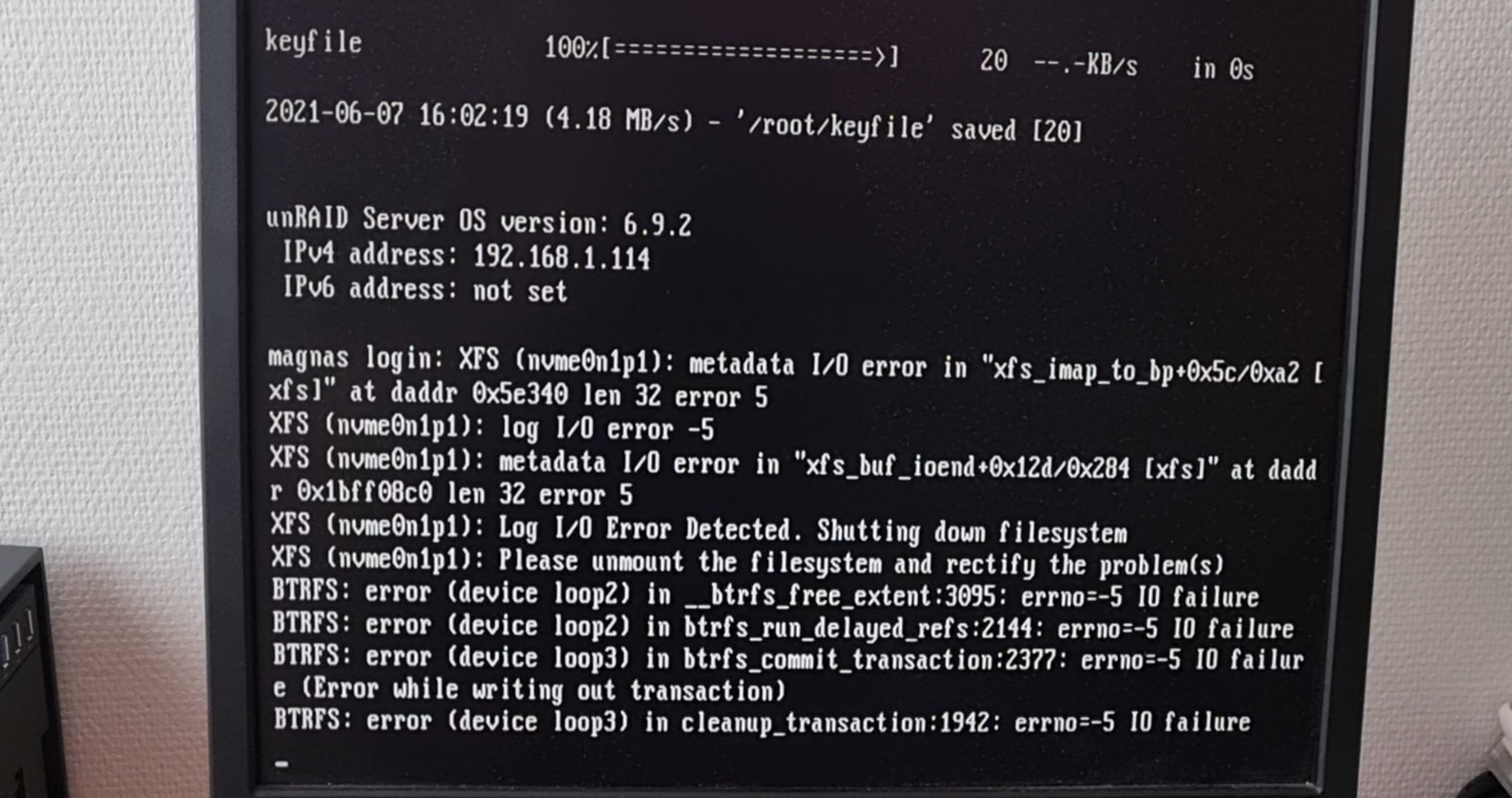

Attaching:
pic from Server (taken just after auto-download of keyfile and log-in)
UnraidWebGui-ss
Logfile (without GO-file due to cleartext username and PW)

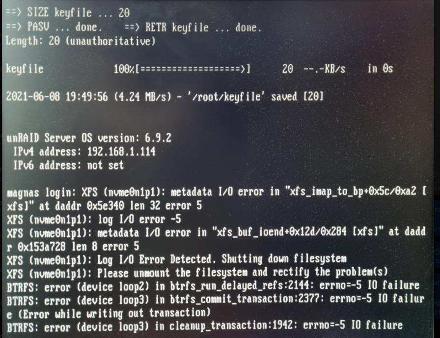

Thanks for the quick reply, however I have to report NoJoy on this.
Added line to the Syslinux Config and rebootet, and the same happens when it boots back up.
New picture taken from attached monitor.
Regarding BIOS: I upgraded the BIOS to latest from MSI (release 31|st of May I believe) before booting to unraid for the first time, so that is already covered.

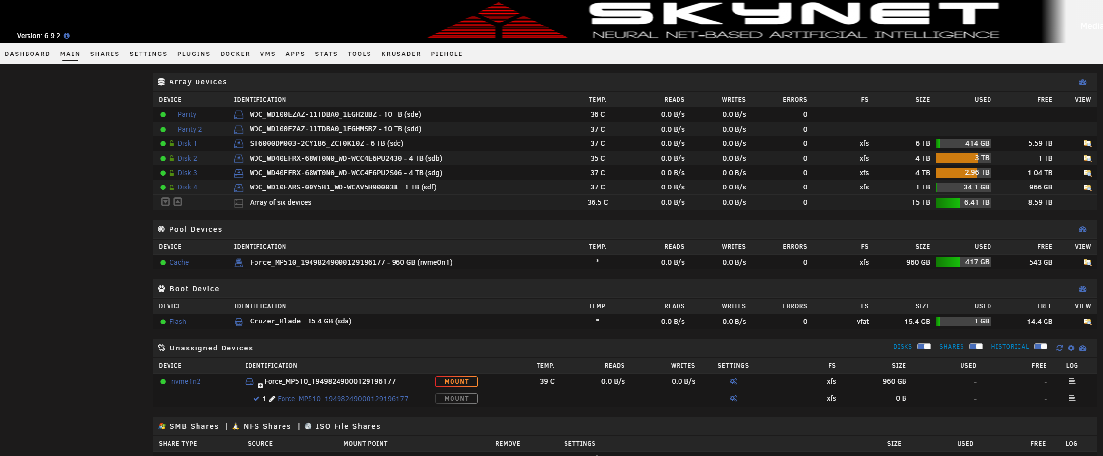

However something peculiar.
If I stop the array,
unmark/remove the cache from the pool-dropdown list
re-add the nvme to the cache-pool
start array.
It does seem to work normally again.
All dockers (that write to the cahce) function (opening KRUSADER i can browser the cache-drive).
So I mean yeah, it works, if I take the time to stop/remove/add/start the array I guess... 🤔
Any clues?
//Magmanthe
Edited by Magmanthe
Reboot and post new diags as soon as it happens again.
It's rather strange, cache initially mounts OK:
Jun  9 19:30:20 magnas kernel: XFS (nvme0n1p1): Ending clean mount
But just a few seconds later it fails:
Jun  9 19:30:26 magnas kernel: nvme nvme0: failed to set APST feature (-19)
Jun  9 19:30:26 magnas kernel: XFS (nvme0n1p1): metadata I/O error in "xfs_imap_to_bp+0x5c/0xa2 [xfs]" at daddr 0x5e340 len 32 error 5
Then it's detected again but now as nvme1 so it's picked by Unraid as a new device:
Jun  9 19:30:26 magnas kernel: nvme nvme1: pci function 0000:01:00.0
Jun  9 19:30:26 magnas kernel: nvme nvme1: missing or invalid SUBNQN field.
Jun  9 19:30:26 magnas kernel: nvme nvme1: Shutdown timeout set to 10 seconds
Jun  9 19:30:26 magnas kernel: nvme nvme1: 8/0/0 default/read/poll queues
Jun  9 19:30:26 magnas kernel: nvme1n2: p1
As far as Unraid is concern the cache is offline, because it's looking for nvme0, don't remember seeing an issue like this before, I would try a different model NVMe device if that's an option.

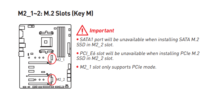

11 hours ago, Magmanthe said:
SATA1-port
That should remain enable when an NVMe device is used in the M.2 slot, disable if you use a SATA M.2 device.
Well, not according to MSI-manual..
Source: https://download.msi.com/archive/mnu_exe/mb/E7B79v3.0.pdf
Page 32/110 on the M2-page it says:
  • SATA1 port will be unavailable when installing SATA M.2 SSD in M2_2 slot.
  • PCI_E6 slot will be unavailable when installing PCIe M.2 SSD in M2_2 slot.
  • M2_1 slot only supports PCIe mode.
//Magmanthe
? That's what the manual says, SATA1 will be disable if a SATA M.2 device is used, you're using an NVMe (PCIe) device.
Ahh, yeah now I see what you mean..
I think I read that section kind of fast and wronlgy. Thought it was BOTH goth disabled when using the M2_2-slot...
Not (like you say) that it is either SATA1 port is disabled IF SATA M.2 or PCI6 is disabled IF nvme M2.. Got it..
Thanks for pointing that out..
