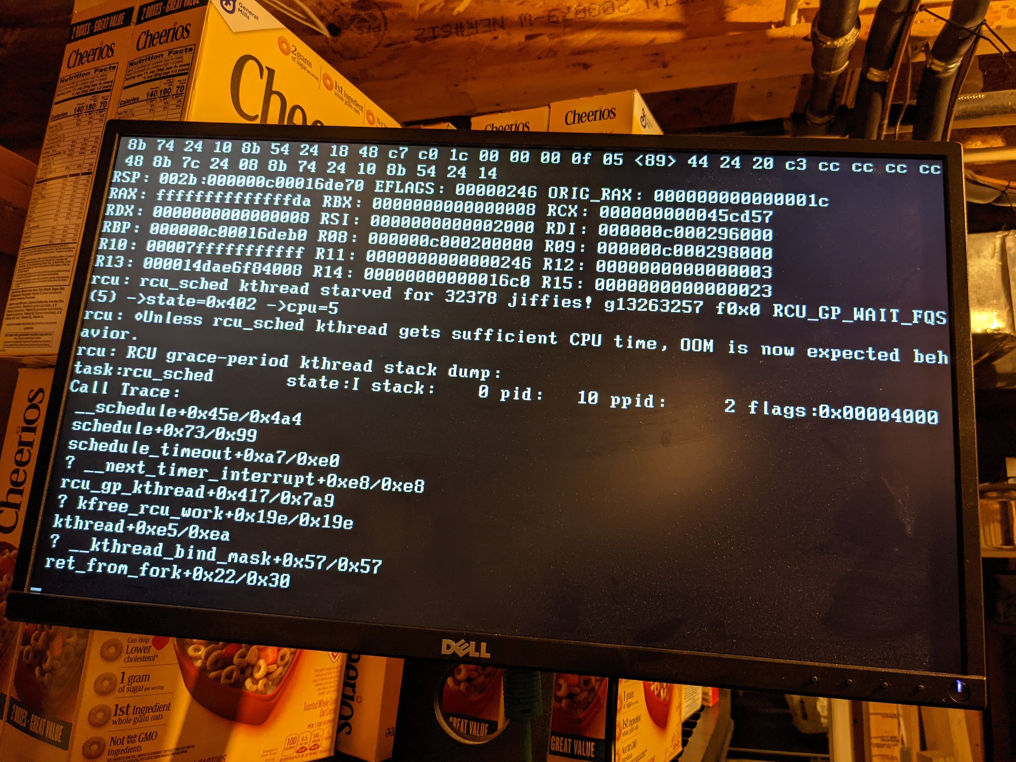

Woke up to day to find that my unraid server is unresponsive.  I took a pic of what the server was sending to my monitor and attached the diagnostics.
Last time this happened 4 days ago, it said that my btrfs 2x cache drives were unmountable and had to be reformatted.  I was able to recover my cache data (plex metadata and binhex krusader docker data) and re-integrate it into my server. I ran a parity check that finished yesterday and didn't have any new sync errors.
When it occured this morning, i couldn't initiate a clean shutdown bc the keyboard was unresponsive and i couldn't access the server remotely. When the server came back up, it initiated a parity check which i cancelled.  This time, the cache drives are still mounted and part of the pool.
In the past week, i've run memtest for 10 passes (>24 hrs) and reseated ram and sata cables. I haven't the slightest idea why this keeps happening.  A little guidance would be helpful.  Thank you.

Can this be SW related. I updated to 6.9.2 last week.  looks like some weird kernel error on my monitor.

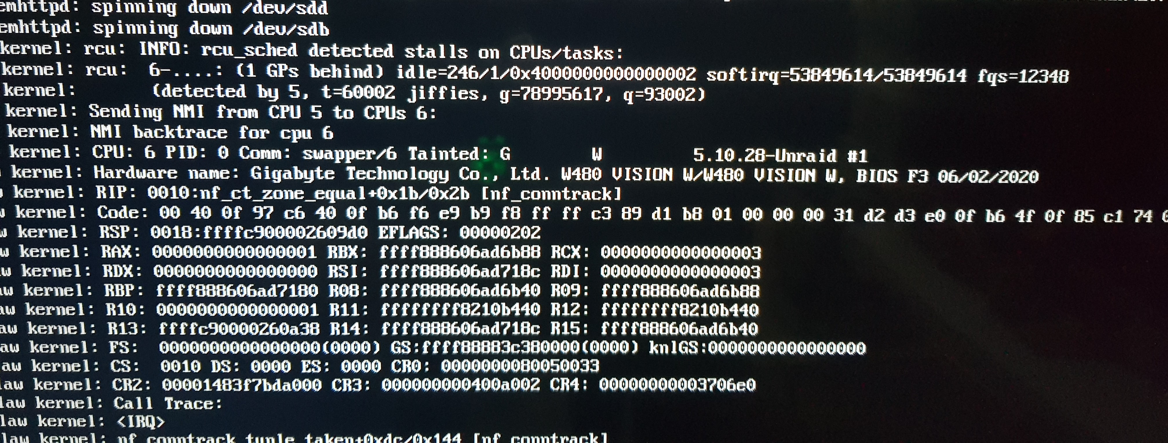

I had similar crashes on my new Server, one after six days than another after nine days running.
Disabled all my d ockers that used br0 net, now running since almost 17 days without crash.

Those are not similar, they mention nf_conntrack and those are typical of the macvaln related crashes with v6.9.2
