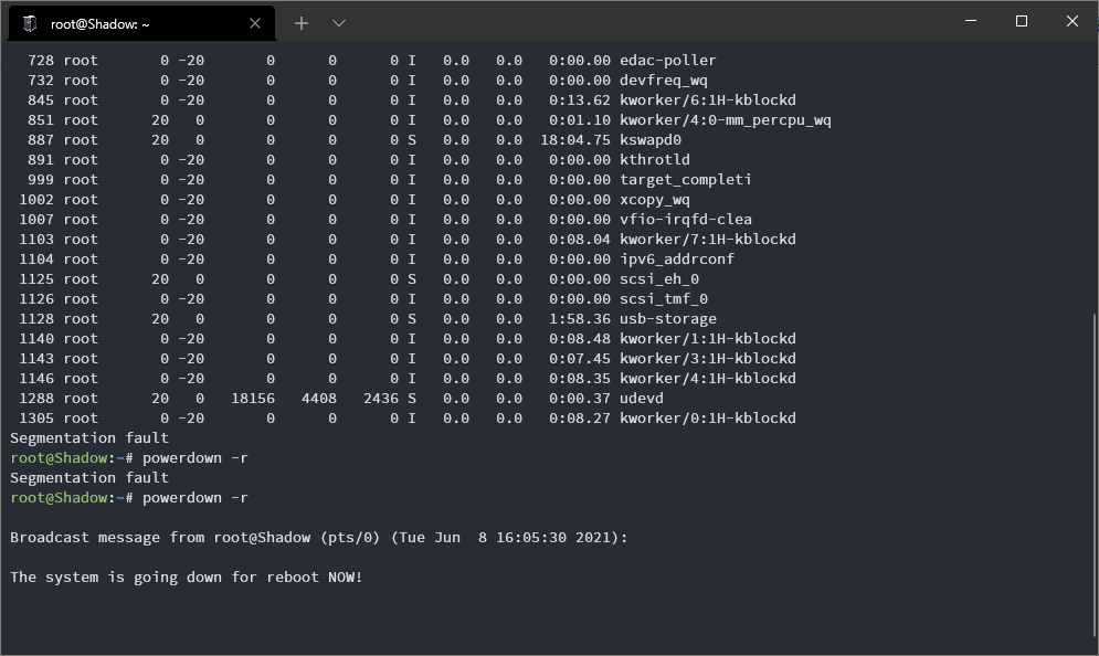

The syslog (which I could still open) showed a lot of red error logs. But I was not able to download the diagnostics anymore - the system had become too unresponsive. I did managed to connect via SSH. The top command showed nothing to be concerned about, but the top command crashed after 5 seconds with a "Segmentation fault" error. (see screenshot attached)
That's when I decided to reboot the server entirely with the Unraid "powerdown -r" command, which again resulted in a Segmentation fault error. Trying again did show the "going down" message, but after waiting another 10 minutes it still didn't power down. Even the terminal when connecting to the server directly with keyboard and display, was unresponsive. I could still type but the commands didn't actually do anything.

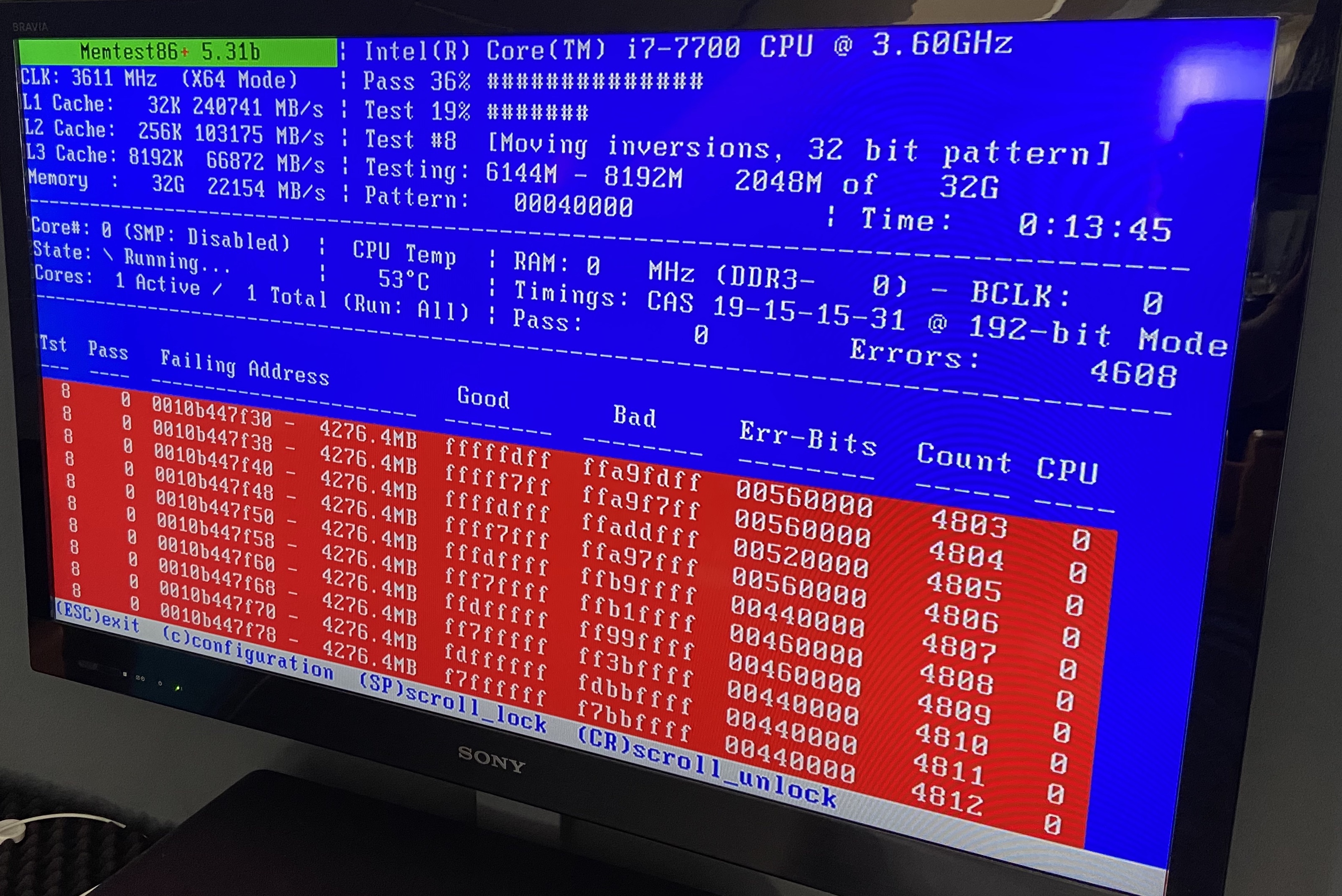

Not sure if this error could be related to RAM, but I decided to do a RAM test anyways.
At around 36% of the first pass, errors started appearing.
So I am starting to suspect my memory modules / motherboard / cpu now (or can it only be the memory itself with these kind of errors?).
I am using 2 sticks of 16 GB DDR4-2400 memory (CMK32GX4M2A2400C16) in dual-channel mode with XMP disabled, using the "Auto" frequency setting in the BIOS. So what I am doing now is testing each stick individually to see if the errors remain (will post results here).
Edited by ssh
Turns out one of my modules is bad. Tested them separately, module A seems to be fine: no errors after 5 hours (3 passes), module B started spitting out errors during the 2nd pass (or after 1 hour). This was repeatable on another system with another motherboard and cpu, so it's definitely the module itself.
I've replaced both sticks with 1x 8GB stick that I had laying around and completed 8 passes on that without any errors. I've started up the server again and did another parity check (luckily still 0 sync errors, so it seems that the memory was faulty, but not faulty enough to cause any data loss on the array yet). Hopefully replacing the bad RAM fixed the issue :)
