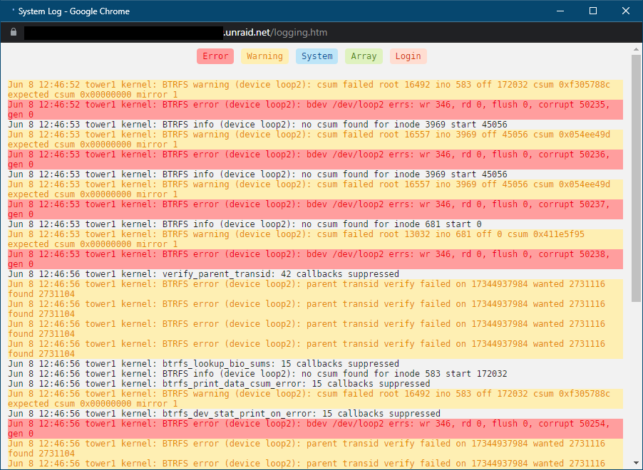

My log looks like this:
Memory->log is 100%.
Docker containers have stopped working and container webgui's are not accessible.
I don't know what to do. Please help.

Corruption was detected on the cache filesystem and it went read-only:
Jun  8 07:29:47 tower1 kernel: BTRFS error (device dm-3): block=1041472405504 write time tree block corruption detected
Jun  8 07:29:47 tower1 kernel: BTRFS: error (device dm-3) in btrfs_commit_transaction:2377: errno=-5 IO failure (Error while writing out transaction)
Jun  8 07:29:47 tower1 kernel: BTRFS info (device dm-3): forced readonly
You should backup and restore data, docker image should then be recreated.
