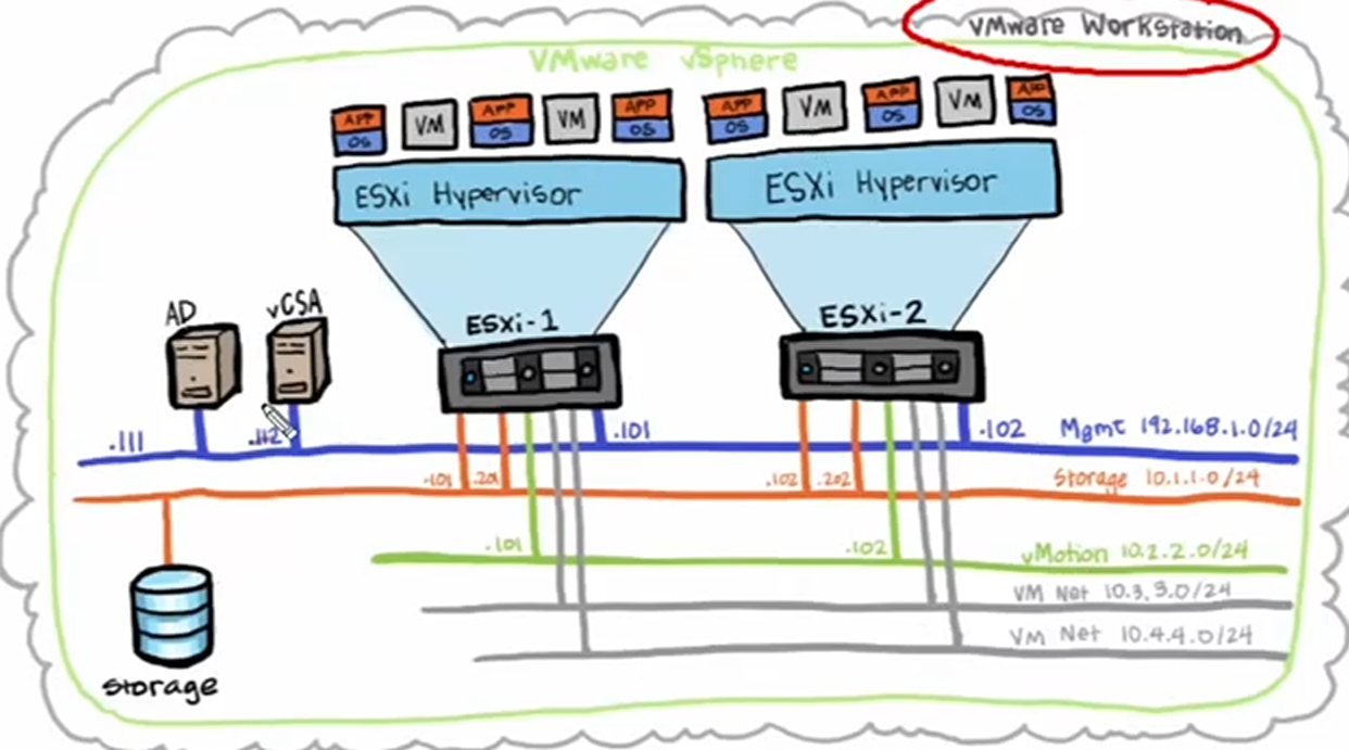

would I be able to set up a private environment that will allow me to create a heartbeat, VMotion and Storage Ip Ranges - Ref Image
so that I can walk through my course and also create and test the my knowledge.

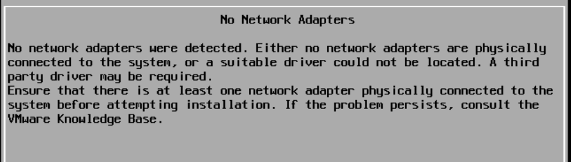

I have been looking around and I found the following link URL but I am having issues getting it to work. as it stops at the following screen.

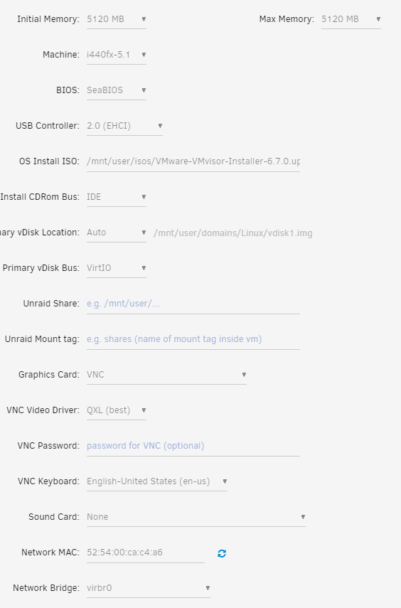

and here is my VM Set up
any ideals ?

I assume you did this:
Change from virtio-net to vmxnet3
<interface type='bridge'> <mac address='52:54:00:67:54:a0'/> <source bridge='br0'/> <model type='virtio-net'/> <address type='pci' domain='0x0000' bus='0x01' slot='0x00' function='0x0'/> </interface>
to
<interface type='bridge'> <mac address='52:54:00:67:54:a0'/> <source bridge='br0'/> <model type='vmxnet3'/> <address type='pci' domain='0x0000' bus='0x01' slot='0x00' function='0x0'/> </interface>
Once you change the network card to vmxnet3 in the "form-view" you can't edit it again that way as it resets the network controller. On the post you reference, rootisgod says:
NOTE
Never edit this again in the Form View as it will undo the changes or even make it an invalid config. So try to change to XML first. It’s really annoying…
Caught me out a few times trying to get mine to work.

good morning,
I just tried your advice amd no joy.  what ever I did to get a network card to work, I was just not able to do it,  so I have looking at using my Windows PC and VMware Workstation.  just so that I can learn Vmware.
thanks for your advice
