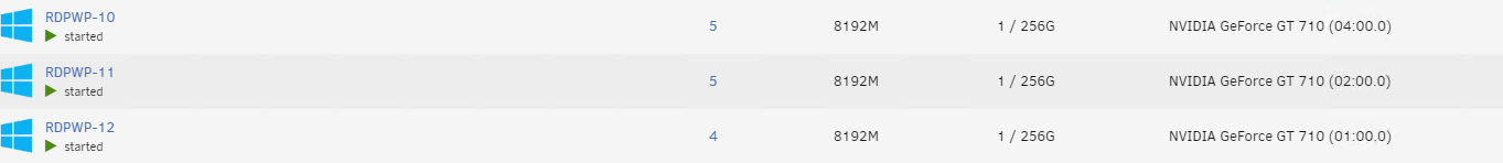

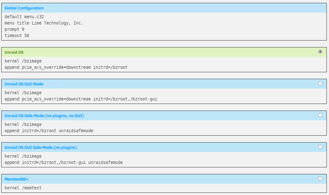

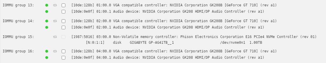

I have a computer running unraid 6.9.2 with 3 video cards and running 3 VMs each with its own dedicated video card. I made sure by pcie_acs_override=downstream that there are 3 different IOMMU groups.
Now I have the problem that the first video card responds slowly, so this VM can't actually be used for the application we need it for.

Is the affected card the one that the server uses by default for its own output - the BIOS screen and Unraid boot menu, for example? I don't see the 10700K's iGPU listed in your diagnostics - is it disabled? You could set it as the primary GPU in the BIOS, which should avoid the problem of the GT 710 not detaching.
