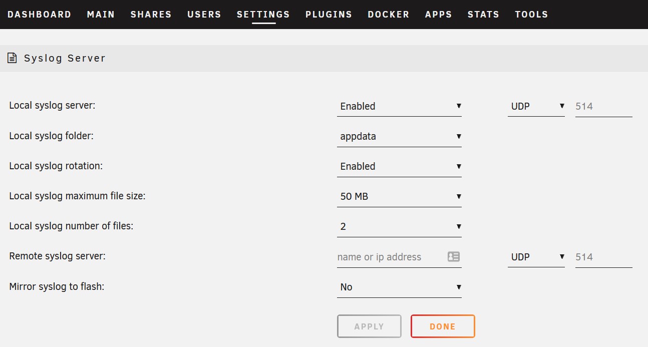

Thanks for the response @Gragorg. It would be great to have this running for the future, so I have found and enabled the syslog server for the local machine, but not for any remote server as I only have the one. I have also set the log files to be created on the cache drive in Appdata. My only question now is when will I see a log file there? It has been a few hours and no luck.
Screen capture is attached of my syslog settings
The log should be there in realtime.  I have not setup a local syslog only remote or mirror to flash.  If you want to test your UPS you could set the shutdown to 1 minute and turn off the breaker.
Here is a great post for setting up syslog server.
