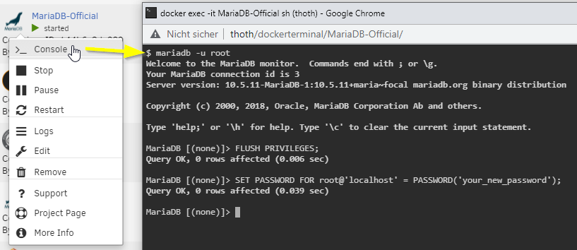

  • Set Root Password   If you like to manually set your root password remove the word "yes" from "Generate Random Password":   Then set your password through "Show more settings

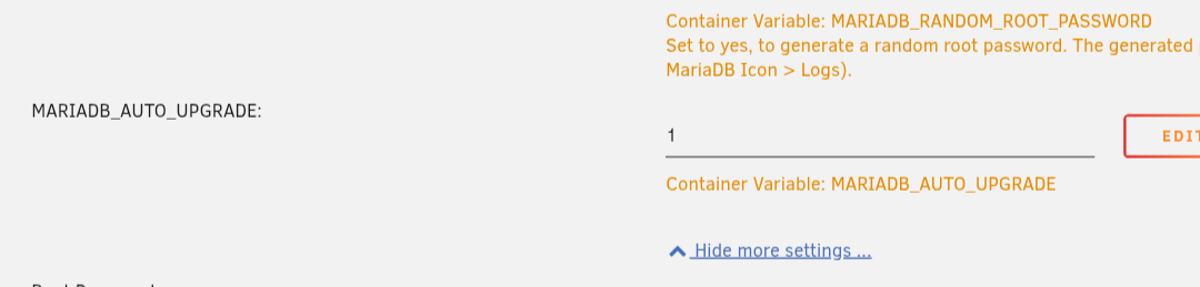

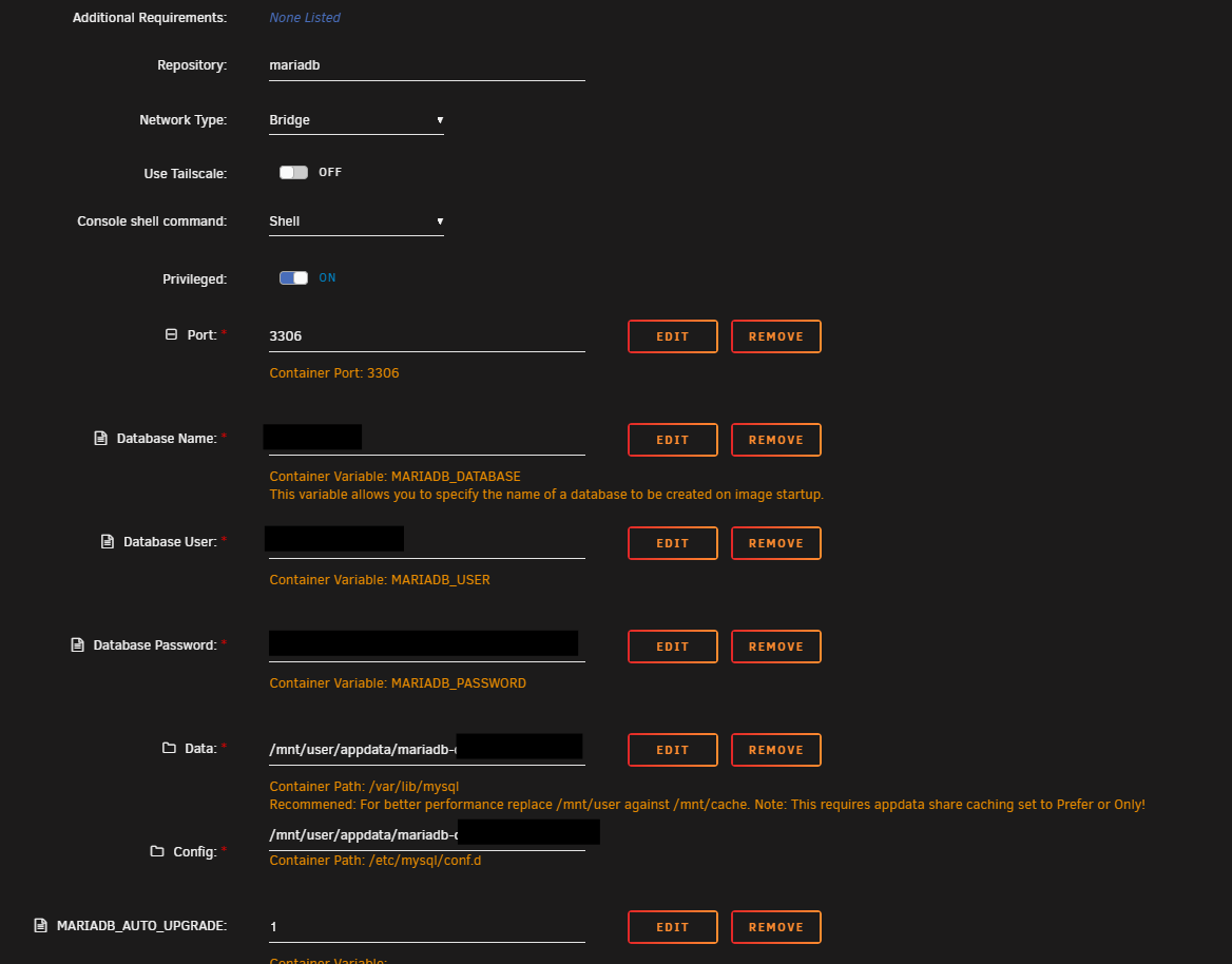

1 hour ago, mgutt said:
And at which step do you get the error? For me it sounds like you don't edit the container, instead you try to add the same container, which obviously is not possible.
I just re-read your message, and I don't think I answered it clearly. I get different errors depending on what I try to do. My first post had images of the errors. I get a different error trying to start, Delete, or save a configuration change (link move to a different network). Deleting orphaned images from Docker didn't change anything. Rebooting UnRaid did not change anything.
1 hour ago, kitten-kiwi said:

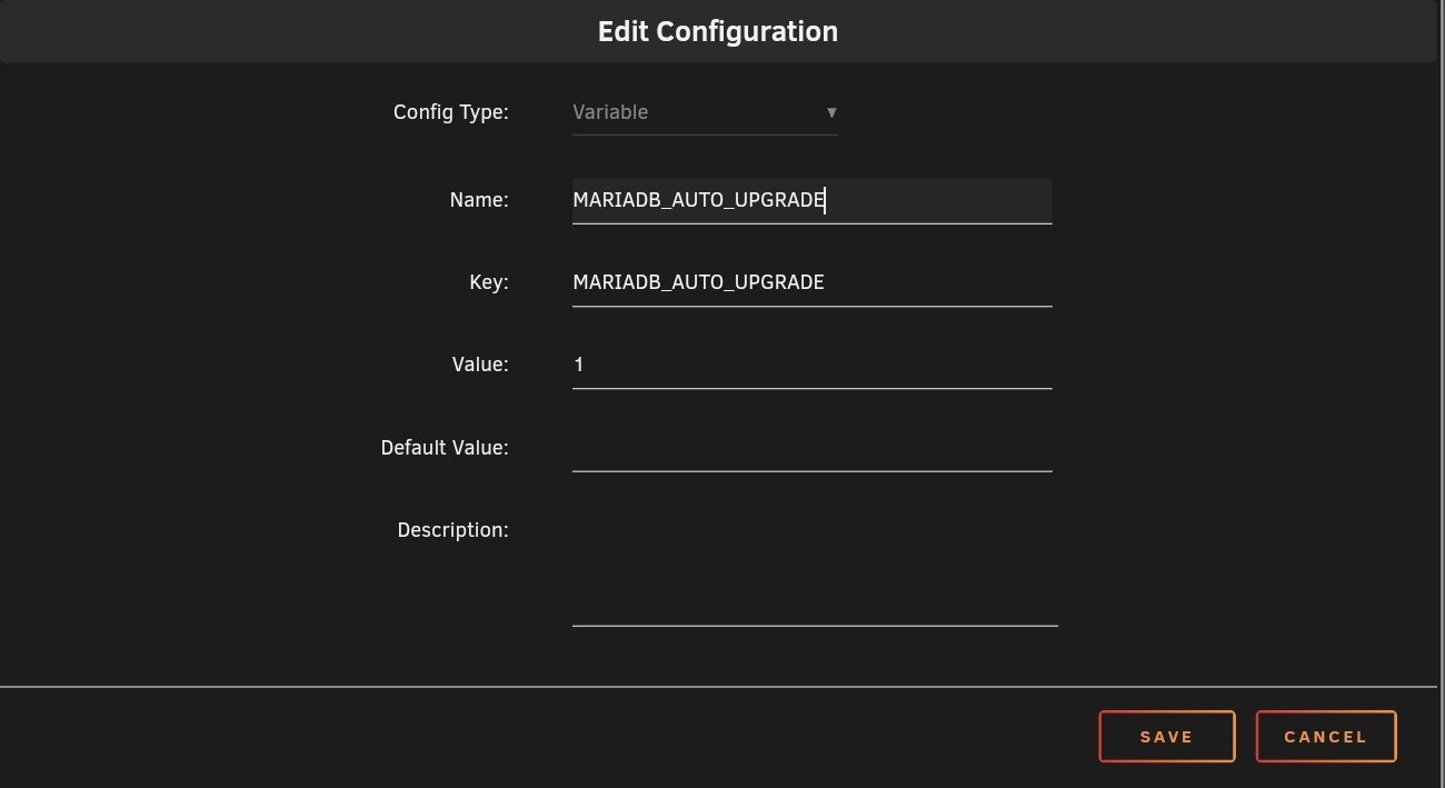

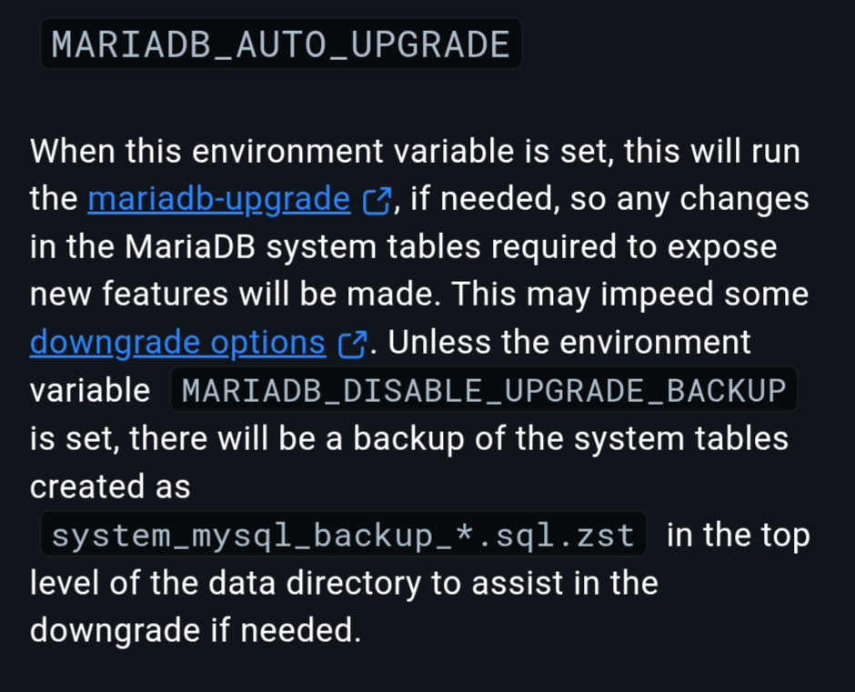

skipped due to $MARIADB_AUTO_UPGRADE setting
Do you have this variable? If not, create it:
Delete the container. Then check for orphaned containers. Delete them, too. Finally re-add the container through "add container" and select the container's template from the dropdown.
8 hours ago, loosenut76 said:
 I do have auto update for docker containers enabled
A comment regarding this: Never use auto update in combination with :latest containers. It's a guarantee for incidents. At least you should limit it to a major version like :10 so you won't hit the most alpha release of an upgrade which often contains bugs. That's the reason why I'm still not using Unraid 7 😉

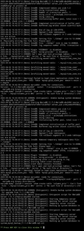

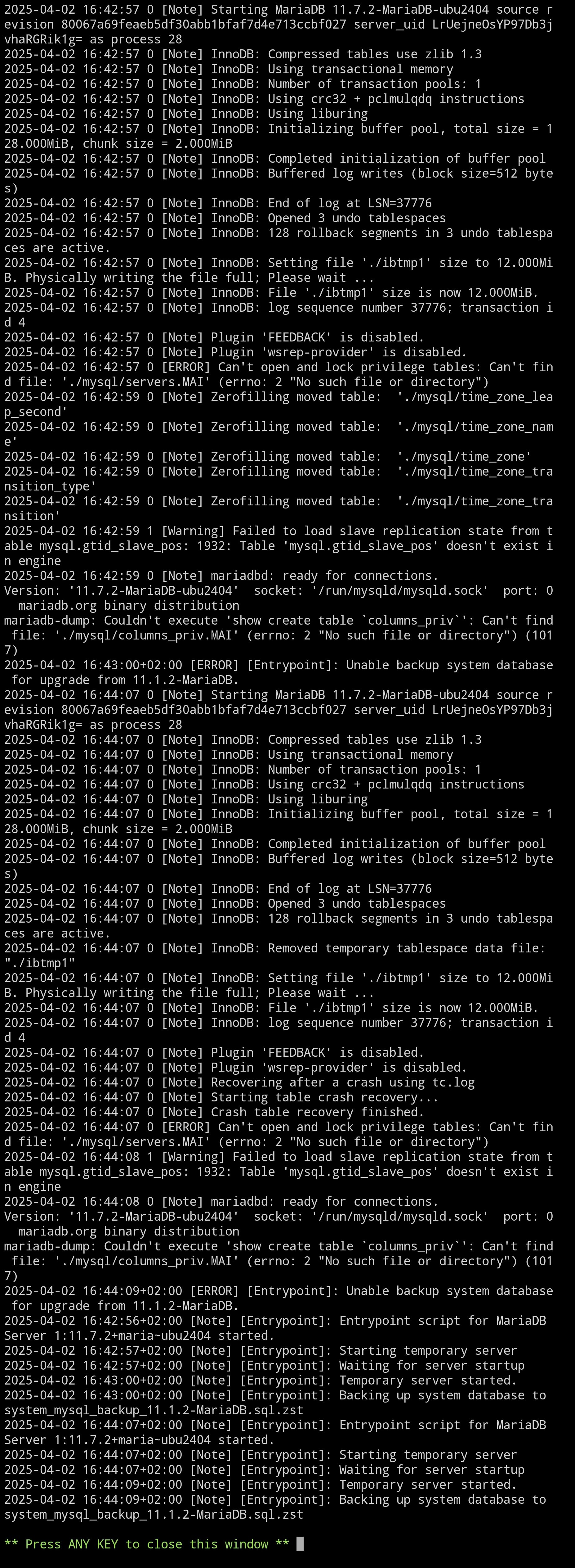

I added your variable and it just gave me a new error, but the old error is still there
2025-04-02  1:16:12 0 [Note] Starting MariaDB 11.7.2-MariaDB-ubu2404 source revision 80067a69feaeb5df30abb1bfaf7d4e713ccbf027 server_uid kHDchnVZSkxlm6ySc12huKSFRik= as process 1
2025-04-02  1:16:12 0 [Note] InnoDB: Compressed tables use zlib 1.3
2025-04-02  1:16:12 0 [Note] InnoDB: Using transactional memory
2025-04-02  1:16:12 0 [Note] InnoDB: Number of transaction pools: 1
2025-04-02  1:16:12 0 [Note] InnoDB: Using crc32 + pclmulqdq instructions
2025-04-02  1:16:12 0 [Note] InnoDB: Using liburing
2025-04-02  1:16:12 0 [Note] InnoDB: Initializing buffer pool, total size = 128.000MiB, chunk size = 2.000MiB
2025-04-02  1:16:12 0 [Note] InnoDB: Completed initialization of buffer pool
2025-04-02  1:16:12 0 [Note] InnoDB: Buffered log writes (block size=512 bytes)
2025-04-02  1:16:12 0 [Note] InnoDB: End of log at LSN=37776
2025-04-02  1:16:12 0 [Note] InnoDB: Opened 3 undo tablespaces
2025-04-02  1:16:12 0 [Note] InnoDB: 128 rollback segments in 3 undo tablespaces are active.
2025-04-02  1:16:12 0 [Note] InnoDB: Setting file './ibtmp1' size to 12.000MiB. Physically writing the file full; Please wait ...
2025-04-02  1:16:12 0 [Note] InnoDB: File './ibtmp1' size is now 12.000MiB.
2025-04-02  1:16:12 0 [Note] InnoDB: log sequence number 37776; transaction id 4
2025-04-02  1:16:12 0 [Note] Plugin 'FEEDBACK' is disabled.
2025-04-02  1:16:12 0 [Note] Plugin 'wsrep-provider' is disabled.
2025-04-02  1:16:12 0 [Note] InnoDB: Loading buffer pool(s) from /var/lib/mysql/ib_buffer_pool
2025-04-02  1:16:12 0 [Note] InnoDB: Buffer pool(s) load completed at 250402  1:16:12
2025-04-02  1:16:12 0 [ERROR] Can't open and lock privilege tables: Can't find file: './mysql/servers.MAI' (errno: 2 "No such file or directory")
2025-04-02  1:16:13 0 [Note] Server socket created on IP: '0.0.0.0'.
2025-04-02  1:16:13 0 [Note] Server socket created on IP: '::'.
2025-04-02  1:16:13 0 [ERROR] Fatal error: Can't open and lock privilege tables: Can't find file: './mysql/db.MAI' (errno: 2 "No such file or directory")
2025-04-02  1:16:13 0 [ERROR] Aborting
2025-04-02 01:16:11+02:00 [Note] [Entrypoint]: Entrypoint script for MariaDB Server 1:11.7.2+maria~ubu2404 started.
2025-04-02 01:16:12+02:00 [Note] [Entrypoint]: MariaDB upgrade (mariadb-upgrade or creating healthcheck users) required, but skipped due to $MARIADB_AUTO_UPGRADE setting
** Press ANY KEY to close this window **

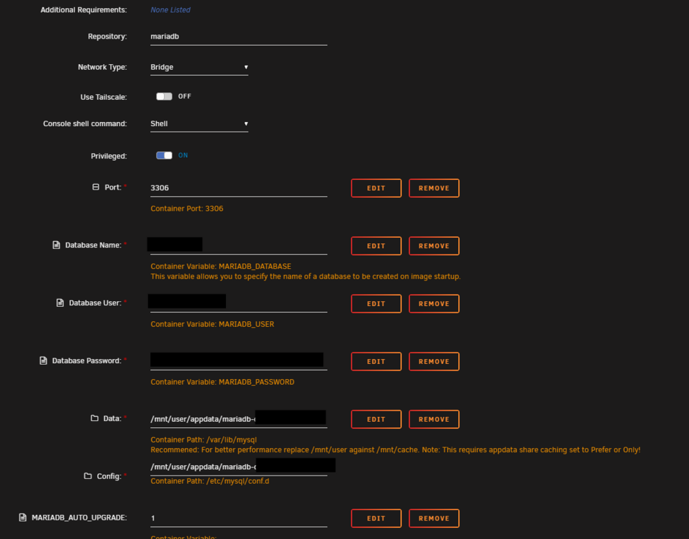

I will attach all my variables

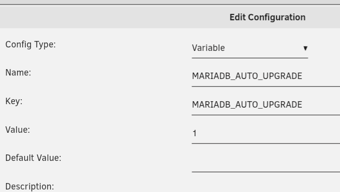

Strange, should work. Key is set the same? (Name is irrelevant, it's only a description of the var)

And after (so the variable can be used permanently):
2025-04-01 04:01:23+02:00 [Note] [Entrypoint]: Entrypoint script for MariaDB Server 1:11.7.2+maria~ubu2404 started.
2025-04-01 04:01:24+02:00 [Note] [Entrypoint]: MariaDB upgrade not required
Documentation:
https://hub.docker.com/_/mariadb
Usually the logs changes while an upgrade to the following lines:

So, i checked and i made a mistake with the var... changed it but the container still crashes. Screenshots attached.
Throw the error lines into an ai chat. I'd say it's broken. Not sure what to try next.
Did you probably set appdata to use both, array and cache? Maybe something got corrupt while moving files.

On 6/10/2021 at 3:33 AM, mgutt said:
Set Root Password
Then set your password through "Show more settings":
Note: This does not allow to change the password.
Reset Root Password
Edit the container, enable advanced view and add "mysqld_safe --skip-grant-tables" to the Post Arguments and start the container:
Open the cotnainer's console and execute the following commands:
mariadb -u root
Now you are connected to MariaDB. Execute this:
FLUSH PRIVILEGES;
And finally this:
SET PASSWORD FOR root@'localhost' = PASSWORD('your_new_password');
Finally edit the container and remove the "mysqld_safe --skip-grant-tables" part again.
