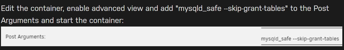

Ok I have this setup.
Then I went to the Unraid terminal and put in the below with my root password.
docker exec -it MariaDB-Official mariadb -u root -p'your_root_password' returns...
ERROR 1045 (28000): Access denied for user 'root'@'localhost' (using password: YES)
****The above is fixed with for now just using a simple password.
I am also now trying to use Adminer to connect to this db but keep getting.....
Access denied for user 'root'@'172.17.0.1' (using password: YES)

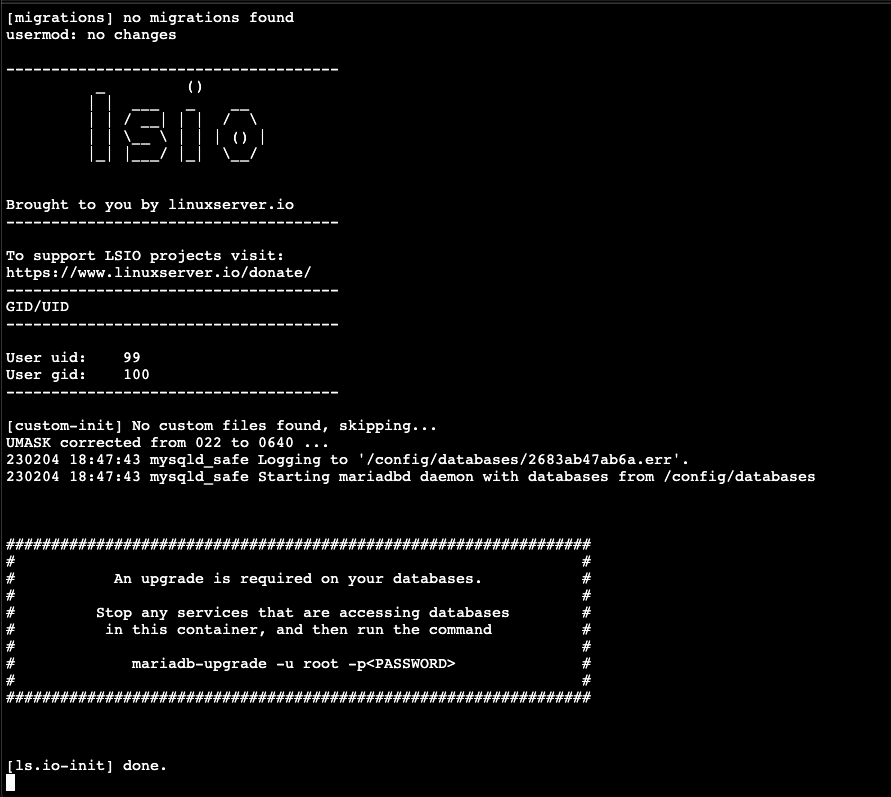

Hi guys, I have been using Mariadb for two years for my nextcloud.  Everything has been working fine and stable all that time since setup. I know Nextcloud was updated (or was at least over a week ago when I last checked).  However, I have just noticed today, that all of the sudden, my Nextcloud stopped working. Except for updating the various dockers, I haven't done anything to my unraid.
My setup is mariadb with duckdns and nextcloud which is rooted through a reverse proxy swag.  I do think I am having some issues with swag when people want to upload/download files over 2Gb in size.
When I was troubleshooting this, I went into the logs of mariadb and found a notice "An upgrade is required on your databases. Stop any services that are accessing databases        #
#          in this container, and then run the command          #
#             mariadb-upgrade -u root -p<PASSWORD>
So I stopped the services listed above and went into the console and typed the command, logged in with my password and I saw that it was working. But I am still getting the same error in the logs, that I have to upgrade (docker is up-to-date for all dockers I am using).
In the console, I get the following message : This installation of MariaDB is already upgraded to 10.6.10-MariaDB.
There is no need to run mysql_upgrade again for 10.6.10-MariaDB.
You can use --force if you still want to run mysql_upgrade
So I went in again and used --force at the end, but that doesn't lead me further and I keep getting the same log error that I have to upgrade.  Not sure if it has anything to do with Nextcloud not working, but it's somewhere to start at least.
The error I am getting is "ERR_CONNECTION_REFUSED"
Any help will be greatly appreciated for sure as this is a bit of a nightmare.  I really don't want to loose the Nextcloud that I have painstakingly built up over the years.

As above mentioned, seeing this in log too and not sure if I should attempt to manually do anything, or not?
1429809694_ScreenShot2023-02-04at6_55_49PM.thumb.png.946dcd63bbbcdcf99e19d289baa5b8f2.png
6 hours ago, blaine07 said:
seeing this in log
You are not using the official maria db Container. Ask Linuxserver!
