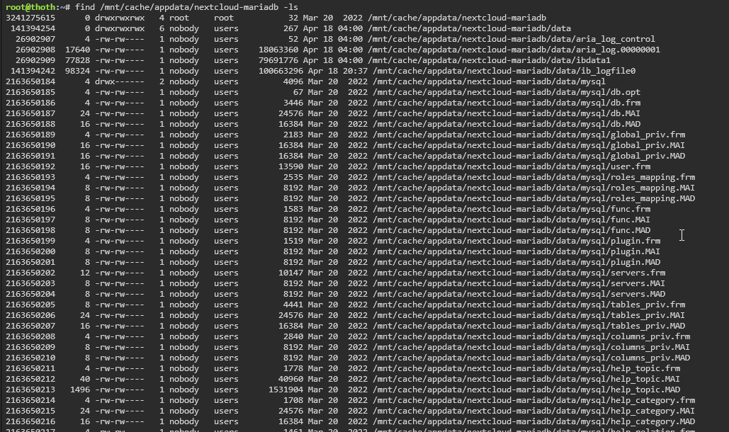

At first check your permissions:
find /mnt/user/appdata/mariadb-official -ls
In the next step correct the permissions if needed:
chmod 777 /mnt/user/appdata/mariadb-official/config
chmod 777 /mnt/user/appdata/mariadb-official/data
chown root:root /mnt/user/appdata/mariadb-official/config
chown root:root /mnt/user/appdata/mariadb-official/data
find /mnt/user/appdata/mariadb-official -mindepth 2 -exec chown -v 99:100 {} \;
find /mnt/user/appdata/mariadb-official -mindepth 2 -type d -exec chmod -v 700 {} \;
find /mnt/user/appdata/mariadb-official -mindepth 2 -type f -exec chmod -v 660 {} \;
I've done a totally newb thing, I lost my acess to my databse. I hsould start with I had a fully functioning database, with nextcloud running. I want to say I'm totally new to unraid and the docker. I am using adminer to access the databse to make change, created users for the nextcloud database and such. I'm alittle more familiar with phpmyadmin and was trying to get that to connect to mairiadb. I was getting frustrated becuase I could not wrap my head around why it wasnt connecting. So in frustration I changed the root user pw inside mariadb beacuse I couldnt find the mariadb password when I set it up. Stupid me found the it too late. Onece I change the pw it kicked me out of mariadb, wanting me to log back in and to connect to a database.  The databse is still there running becasue nextcloud is stull functioning. Is there any way to recover this?
On 4/18/2023 at 8:45 PM, mgutt said:
All files in appdata are extremely sensitive regarding user permissions. MariaDB official does not run as root. It runs with unraids default user permissions 99 (nobody) and group 100 (users):
Here is an example of one of my installations:
And how did you copy them to the UD SSD? And how is it formatted? If its not a Linux filesystem, all file permissions are lost.
So is that the right way to configure the permissions?

I tried to login as root user and i get this error:
root@e571c6533173:/# mariadb -u root
ERROR 2002 (HY000): Can't connect to local server through socket '/var/run/mysqld/mysqld.sock' (111)
Can anyone point me in the right direction here? I do not seem to have a 'mysqld.sock' file, so I am not sure where I need to start?!

Hey.
So unfortunately these forums seem to be a bit of a ghost town recently! I am sure I have done something wrong with my new server setup that has broken everything, and I initially blamed macvlan. I actually think the mover is breaking my dockers. So, today, I will be deleting some dockers, and making sure only the cache drive is used for Appdata, Domains & System. I'll kick off the mover, then delete some dockers, and start again.
I think with the multiple databases, you can do it that way, but I think they recommend 1 mariadb per database is that it is potentially easier to manage! I'm not really a db guy so I am not sure if you can do what you want to do. It sounds like a permissions issue though.

A little feedback on that: This is not a place to help users of other containers like the one of Linuxserver and users using the command line to create multiple databases are additional special scenarios I'm not really willed to help only because some YouTubers are spreading bad How-Tos
1 hour ago, Killabee44 said:
copying the different DB folder
This is not recommend. Create dumps from each database. You can use phpmyadmin, HeidiSQL (Windows), Adminer, Command Line ...
