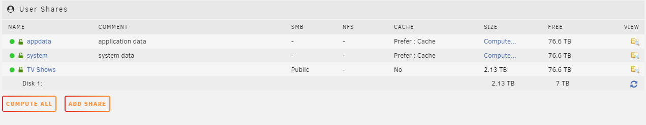

There's something strange here, but not sure what, only disk1 appears as having contents for that share, that looks wrong, post a screenshot of the share in the GUI after clicking "compute".

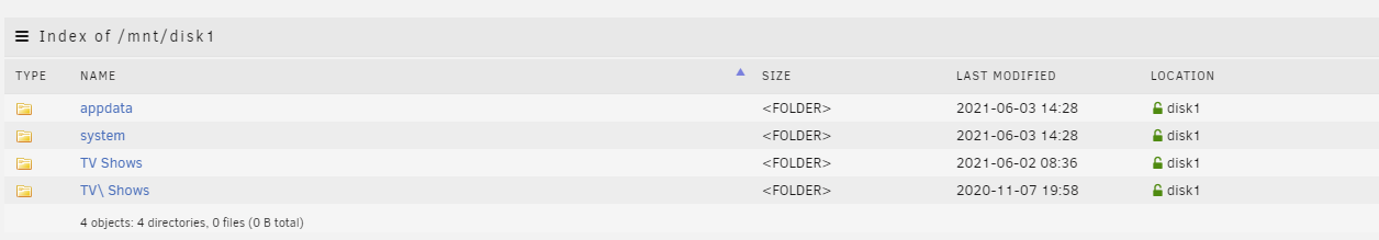

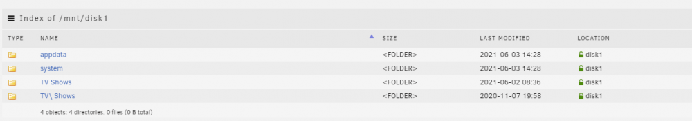

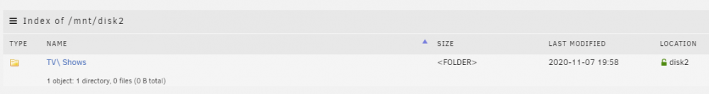

Hmm, this is very strange, the data does appear to be only on Drive 1 according to the shares page, but if I click each disk manually and view the files I can see a share. There seems to be a folder TV Shows on Drive 1 as well as a folder TV\Shows.  On all other drives there is only a TV\ Shows folder. Maybe my sync from my other server has a malformed command. Hopefully I can just log into each disk via midnight commander and move the data into the correct folder.

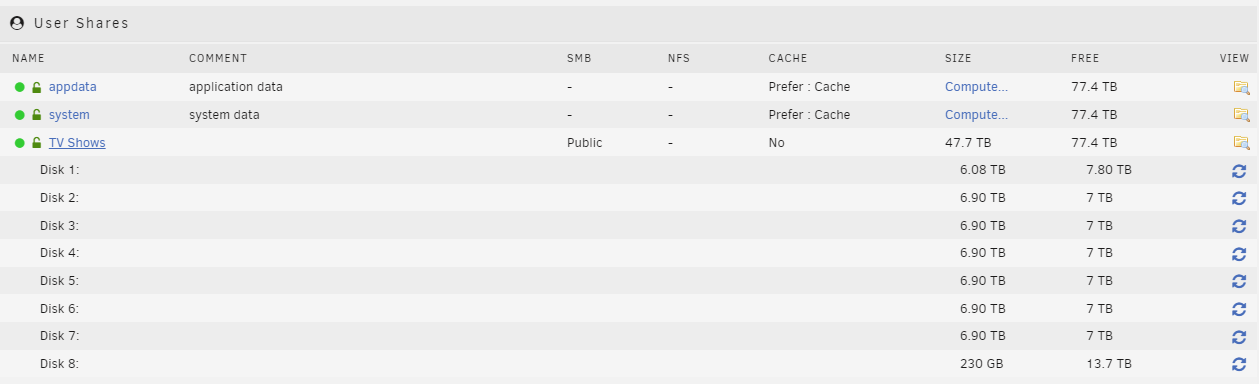

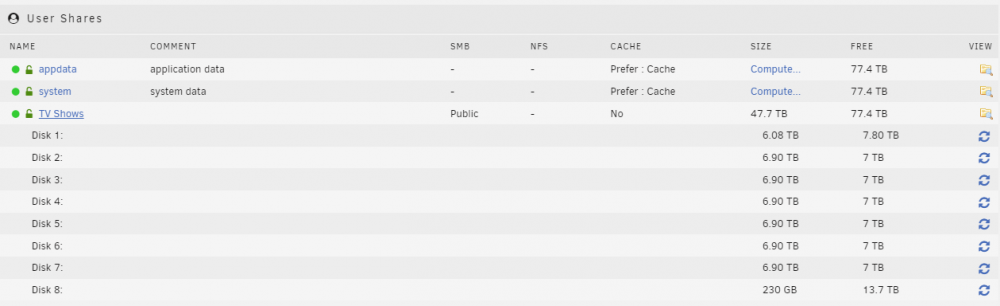

OK, I renamed the TV\ Shows folder on disks 1-8 to TV Shows and recomputed the share.  All the files are now correctly in one folder and all show under the share.
