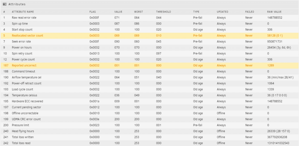

I just got home and noticed that my unraid server while completing my normal monthly parity check has been spitting out a whole bunch of errors.  (these are showing up as a bunch of read errors. The parity is not finished (at 99.6%) .  I have attached the diagnostics below. and will update with a new one once parity is completed.   Below is a screen shot of my Parity drive SMART data report.
Is this a sign that the drive is failing/ about to fail. ?
what are steps that I should take to investigate at this time.  I am looking into option to send drive back RMA. (it is a drive I have had in system since the beginning).

Yeah, you should replace that disk.
