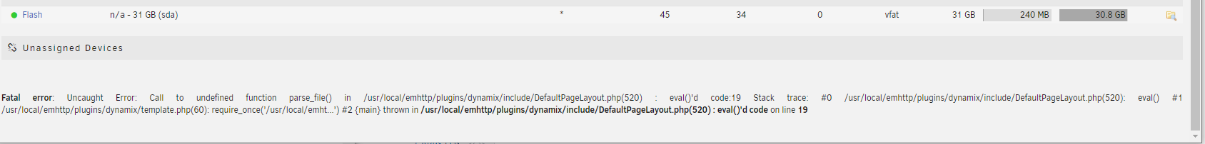

Once back in OS (6.8.3) I noticed a few GUI display errors.
Fatal error: Uncaught Error: Call to undefined function parse_file() in /usr/local/emhttp/plugins/dynamix/include/DefaultPageLayout.php(520) : eval()'d code:19 Stack trace: #0 /usr/local/emhttp/plugins/dynamix/include/DefaultPageLayout.php(520): eval() #1 /usr/local/emhttp/plugins/dynamix/template.php(60): require_once('/usr/local/emht...') #2 {main} thrown in /usr/local/emhttp/plugins/dynamix/include/DefaultPageLayout.php(520) : eval()'d code on line 19
Of course I couldn't start the array there, but was able to use some Android app to start.
(Seems to be some Unassigned Devices issue, I posted this issue there).
