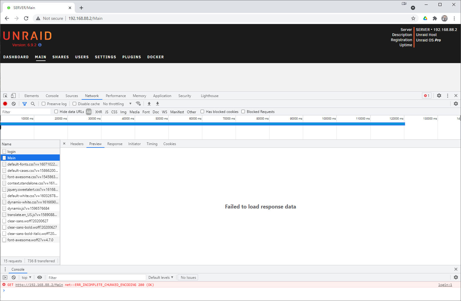

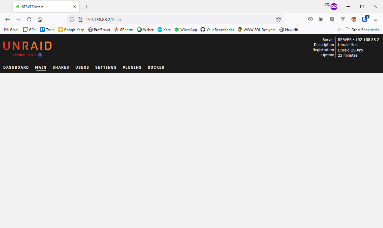

Unraid v6.9.2, has been working fine since the upgrade, but today I noticed that I could no longer access the web interface.
I can log in without issue, but after logging in, only the top banner of the UI loads. It takes a long time to "finish" loading, but never does. Everything below the banner is blank. All pages are the same.
In the background it seems that storage shares, Docker services, VMs etc all still seem to be running fine. I can get to the terminal over SSH.
I've tried a couple of reboots (using the ssh terminal). But its not helped. Any ideas what to do?

The first thing I'd do is try a different browser. What is the blue shield icon with the "4" badge in the top right of your screen grab? Is it responsible for blocking content? You'll need to whitelist your server if you use an ad-blocker.
Sorry i should have mentioned i have tried it already in firefox and chrome, and with adblock disabled. The blue icon is just a password manager.
Thanks though.
Looking in debug, it seems the page just doesnt load properly.
