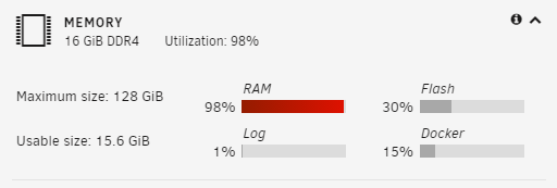

Once Mover finished I started the Windows 10 VM again and it seems to start ok but occasionaly it seems to run out of RAM. On the Unraid - Dashboard tab I can see my RAM running at 97-98% and "Fix common problems" still tells me I have "Out Of Memory errors detected on your server". More good tips?
I've given the VM 13824MB out of 16GB total.
Try reducing to 8096. Unraid needs resources to emulate the hardware for the VM.
Thanks to both of you. After also adjusting the RAM for the VM it seems to be better balanced and I have now done a proper test run for more than 5 days without any hick-ups. My understanding was that Unraid only need like 1-2 GB RAM but I didn't take into account the actual VM-emulation.
