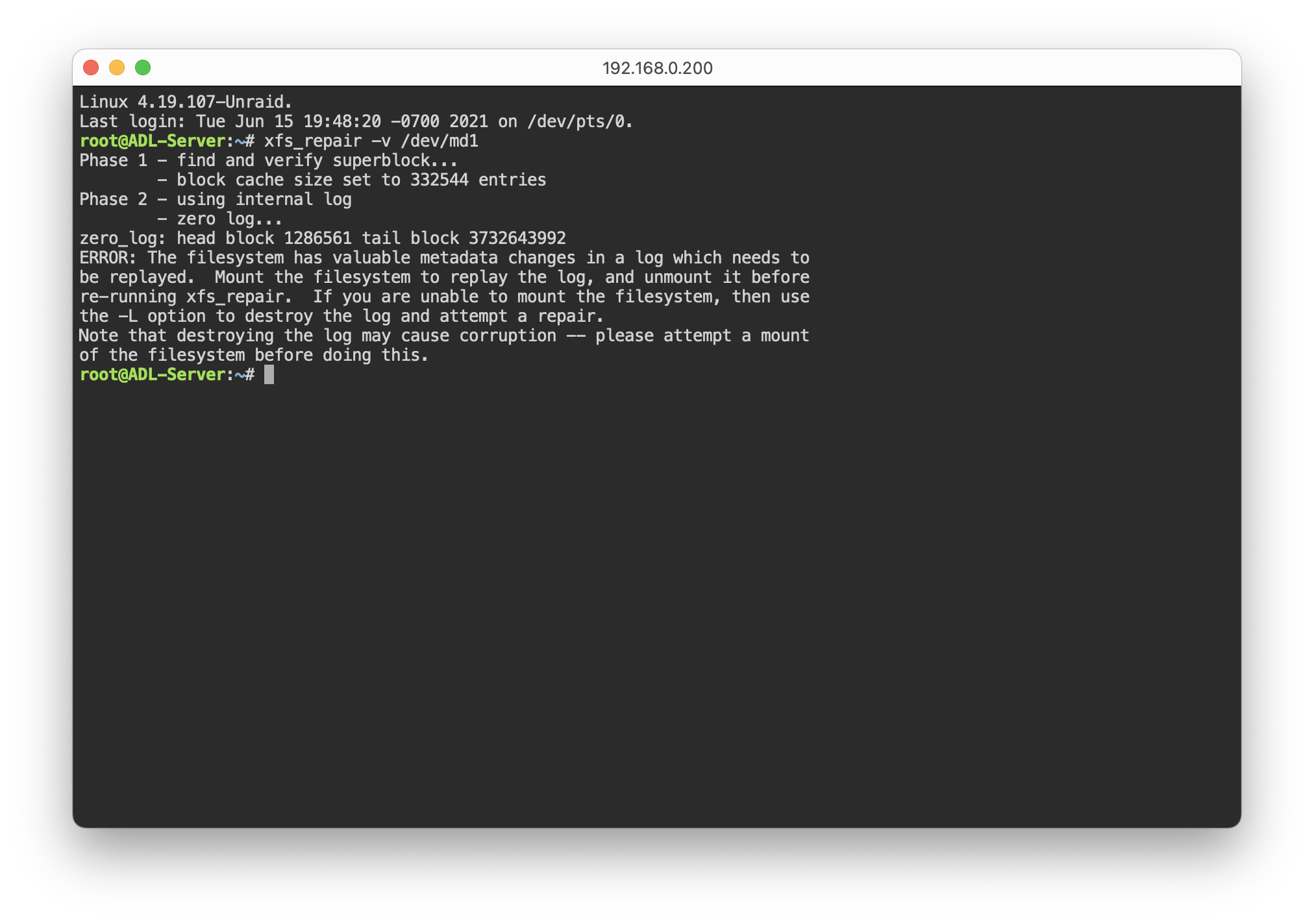

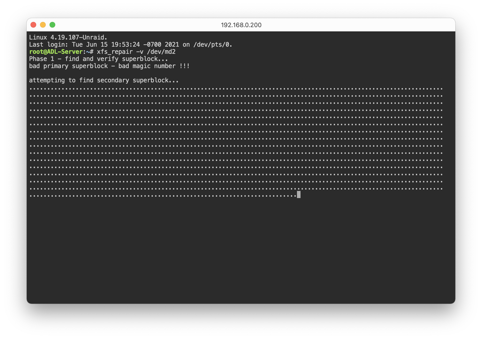

I did find this and tried " xfs_repair -v /dev/md1 "  and get the same on drive 1. On drive 2 I get "attempting to find secondary superblock..." I wonted to check in before moving on.
For drive1 run with the -L option for the repair toproceed as the warning is standard after a disk has been reported unmountable.
for disk2 there appears to be a more serious issue that xfs_repair will not be able to help,with.

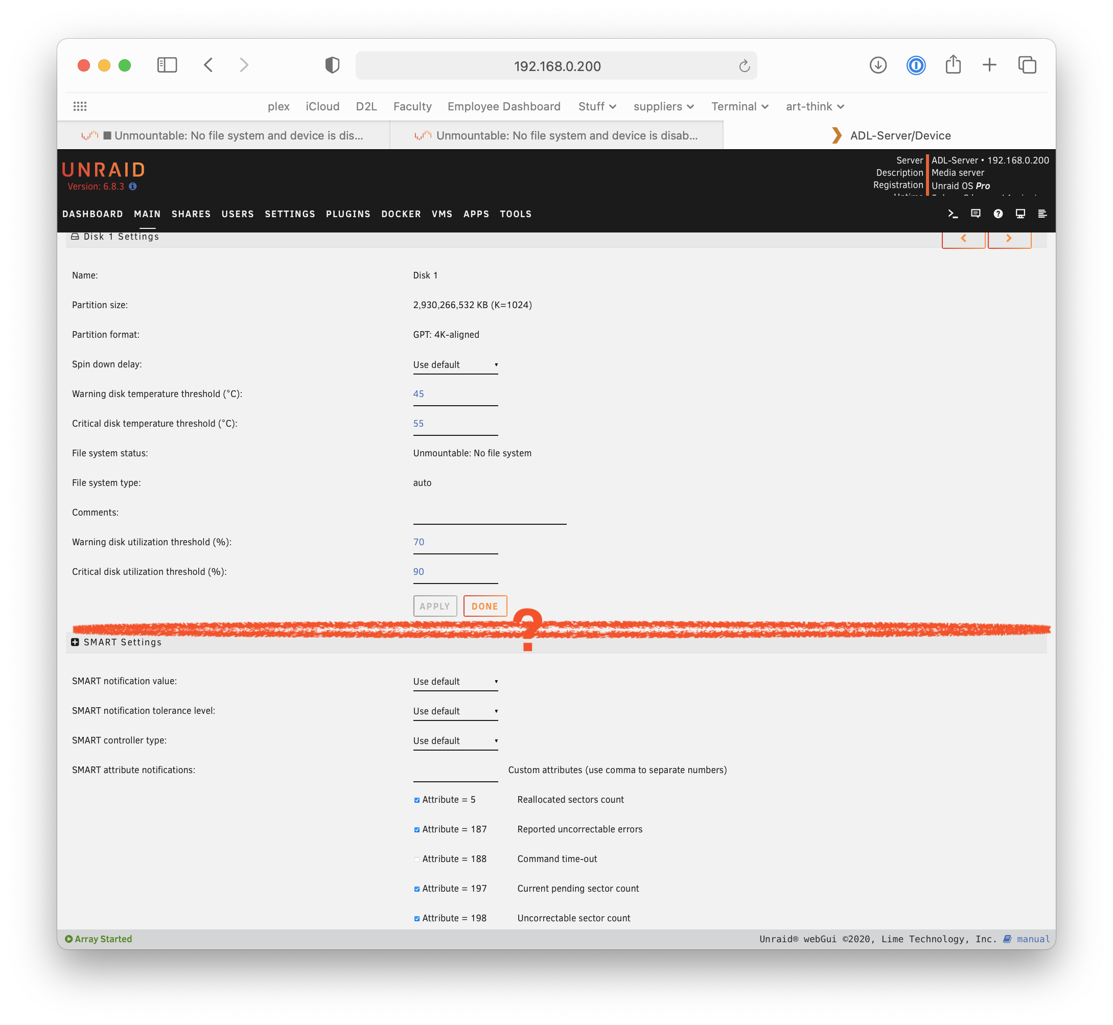

That will happen if the FS is set to "auto", the bigger issue is the superblock not being found on disk2, that suggests no valid filesystem is there.
Is was set to xfs before this happened. Don’t know how got set to auto?

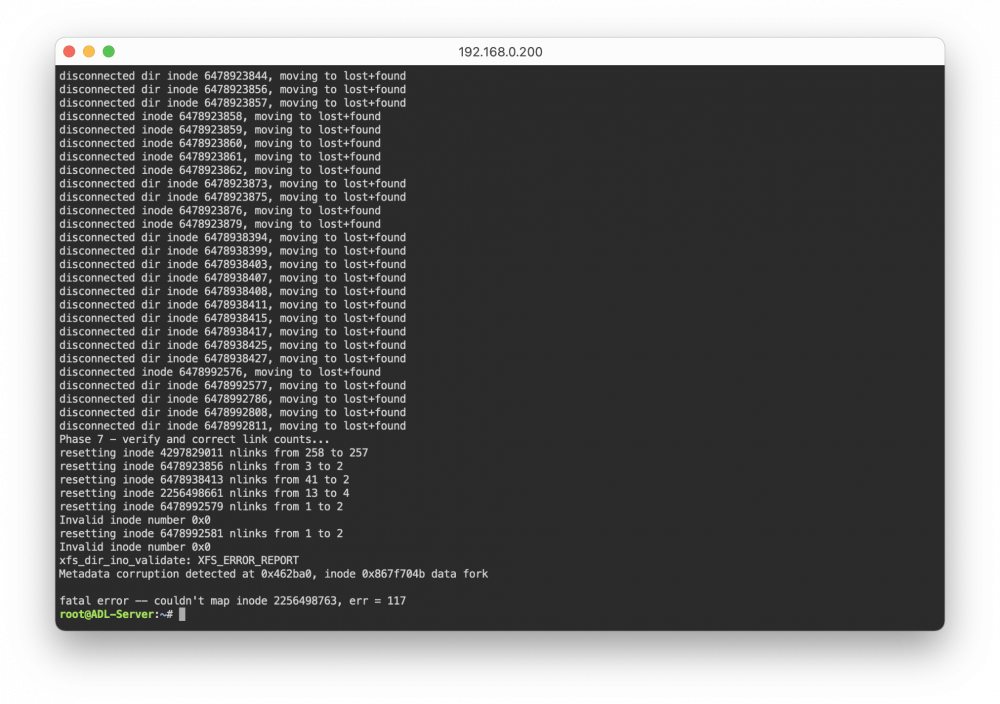

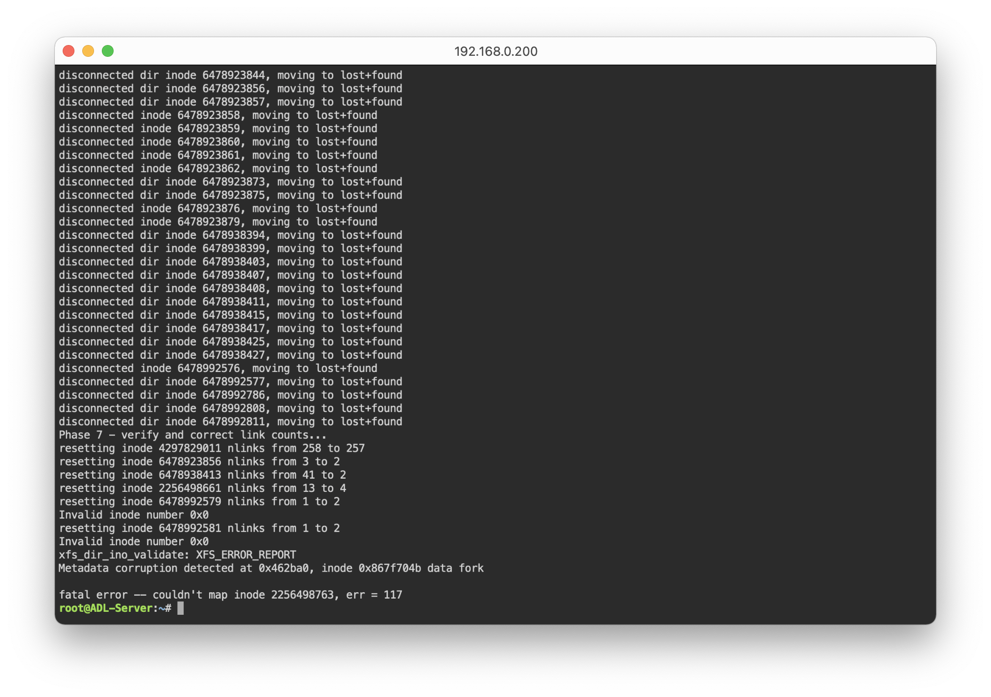

I Drive one with Option -L I Get "fatal error -- couldn't map inode 2256498763, err = 117"
That looks like a xfs_repair problem, update Unraid to v6.9.2 and try again.
Ok that works Thank You all for the help!
