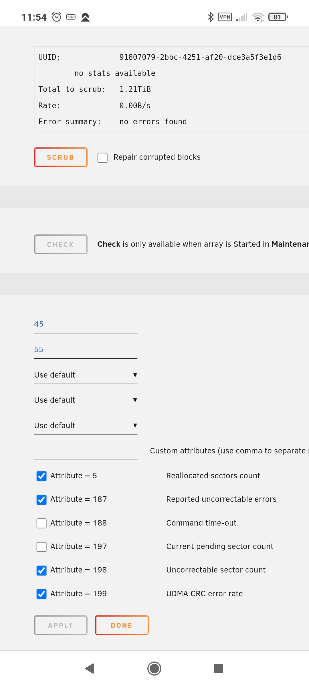

Cache1 (default):
Screenshot_2021-06-13-11-54-01-385_com.android.chrome.thumb.jpg.a040249fc8a1a6157881dd37e9f9c3b4.jpg

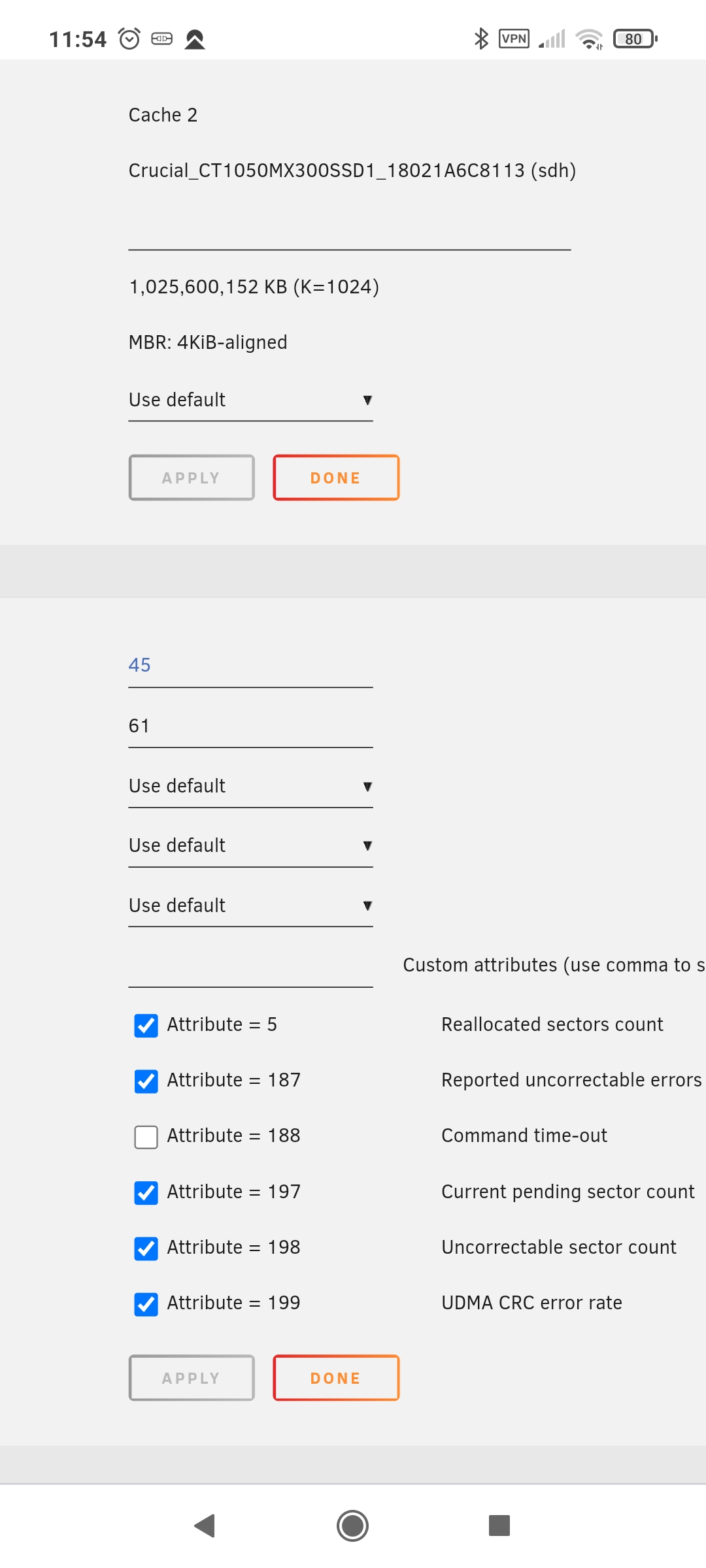

Cache2 (61C):
Screenshot_2021-06-13-11-54-22-035_com.android.chrome.thumb.jpg.2e2194a3c2736af201bc1db2928e3b07.jpg

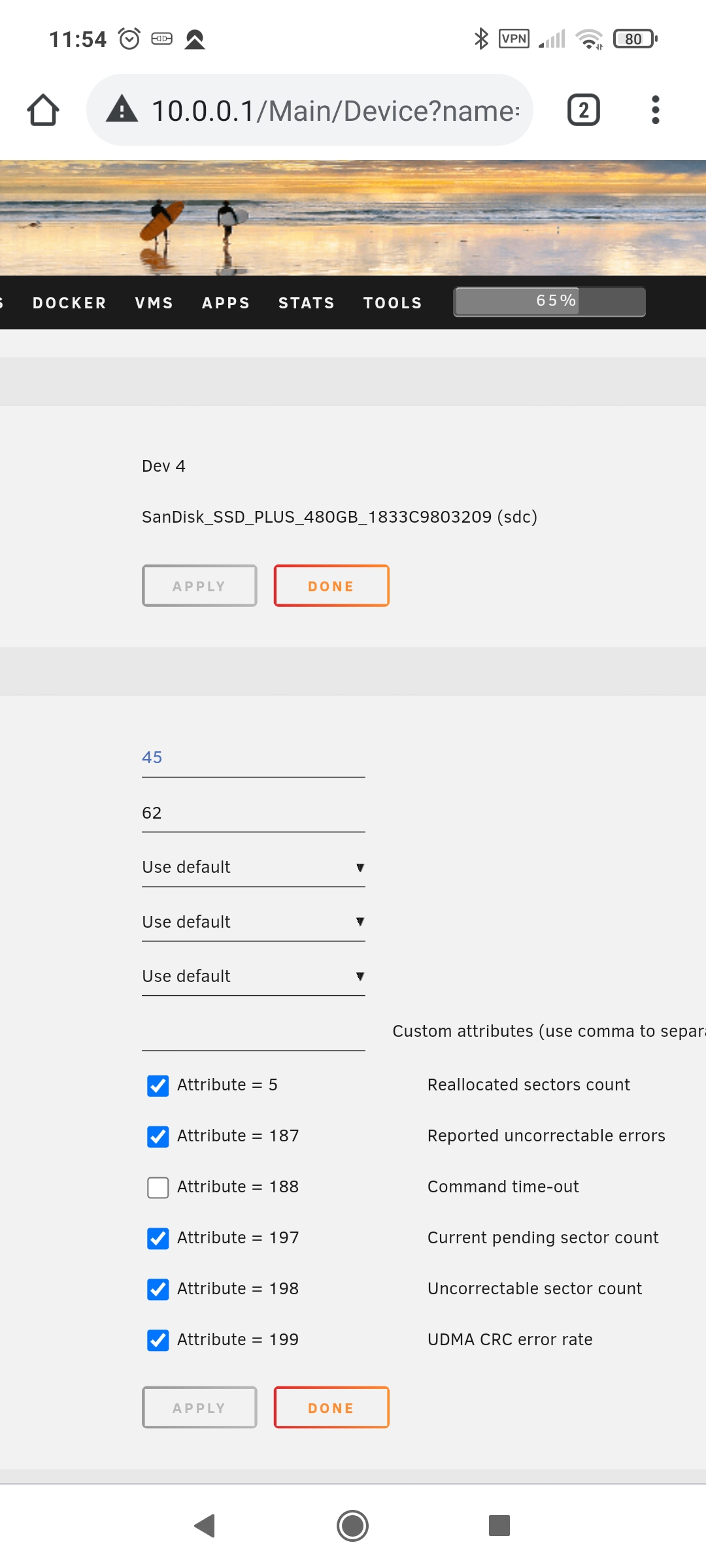

UD Dev4 (62C):
Screenshot_2021-06-13-11-54-35-654_com.android.chrome.thumb.jpg.917a9368ba18caa74528319ce2303f4b.jpg

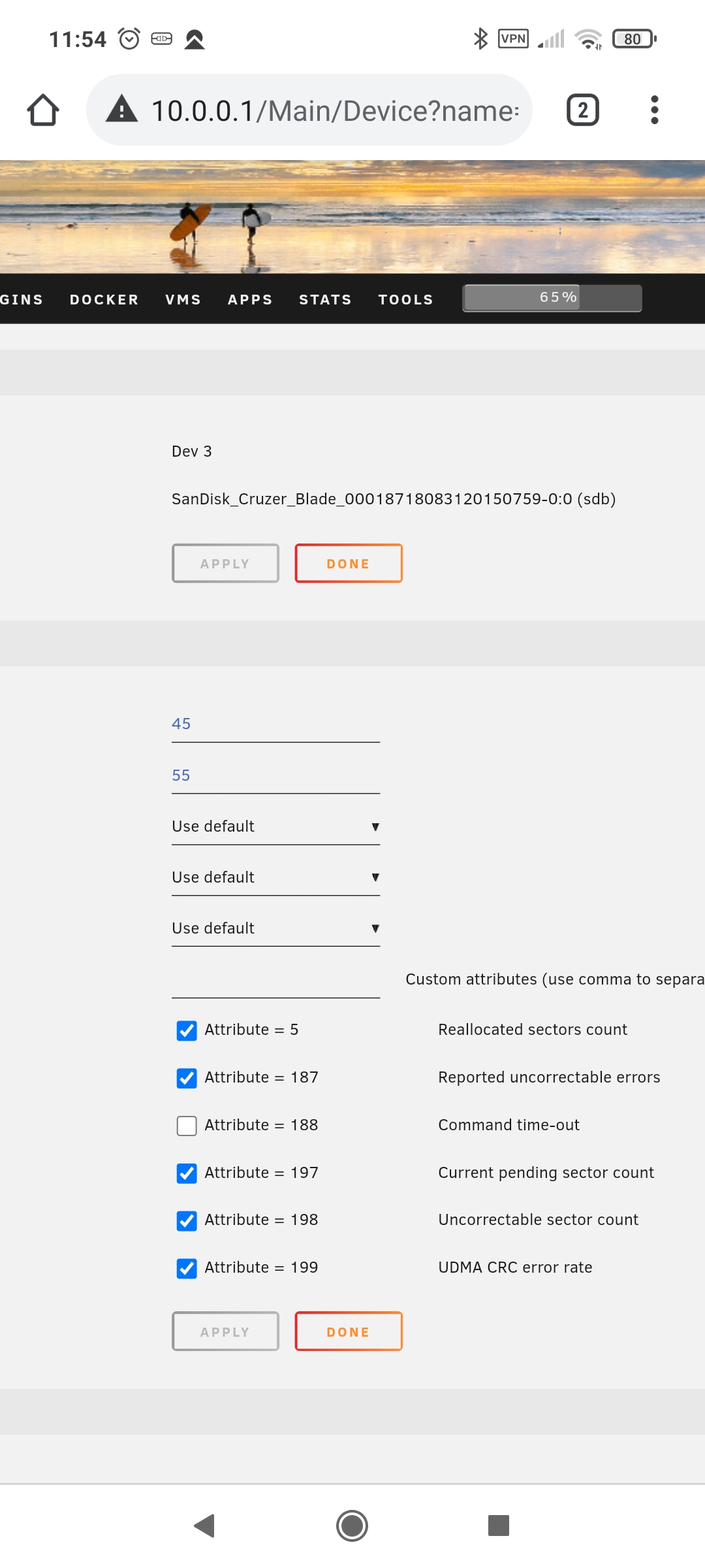

UD Dev3 (default):
Screenshot_2021-06-13-11-54-51-699_com.android.chrome.thumb.jpg.2d7870dae22f1155542565006969a6a4.jpg
Wird alles richtig gespeichert.
