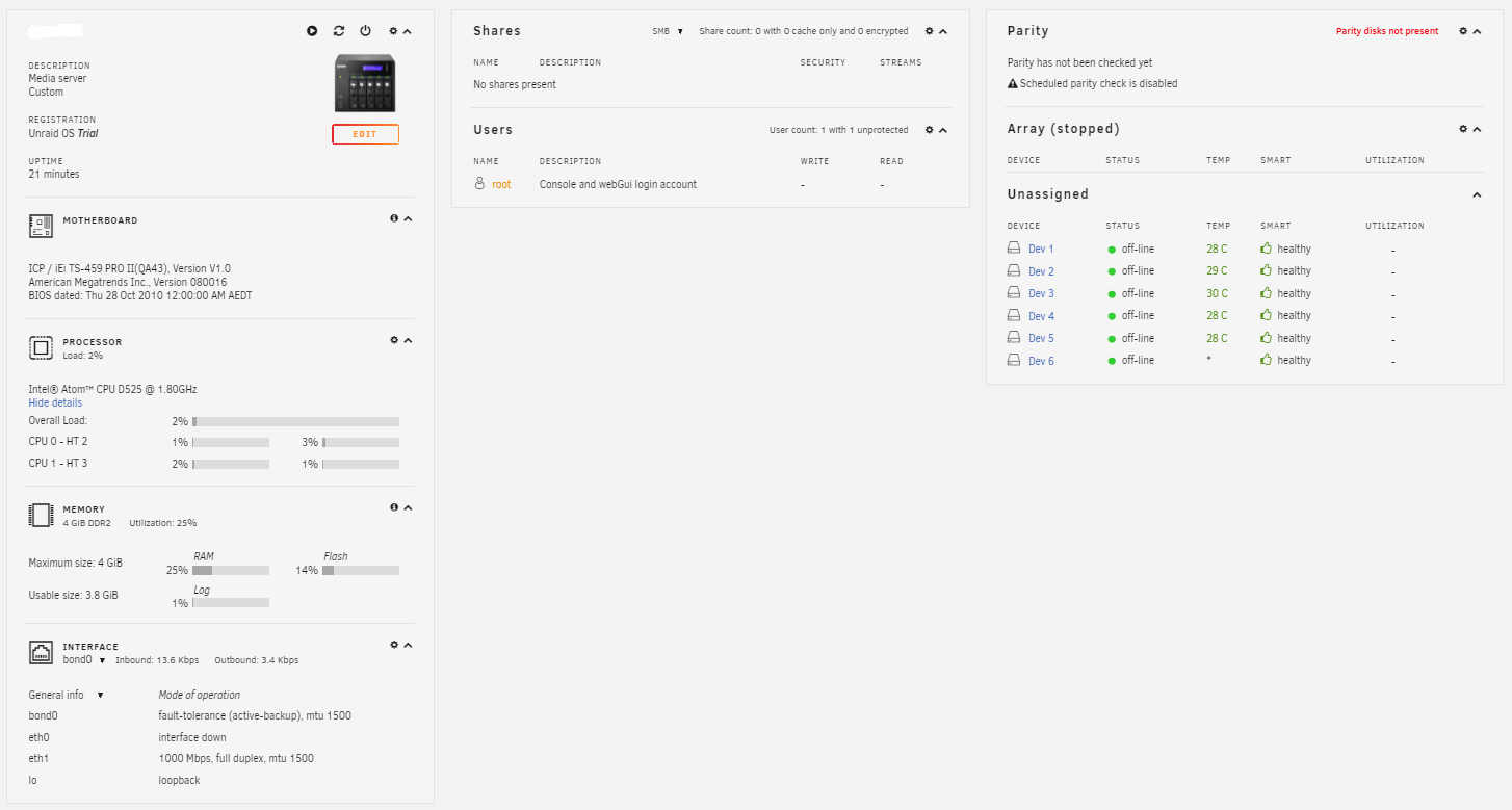

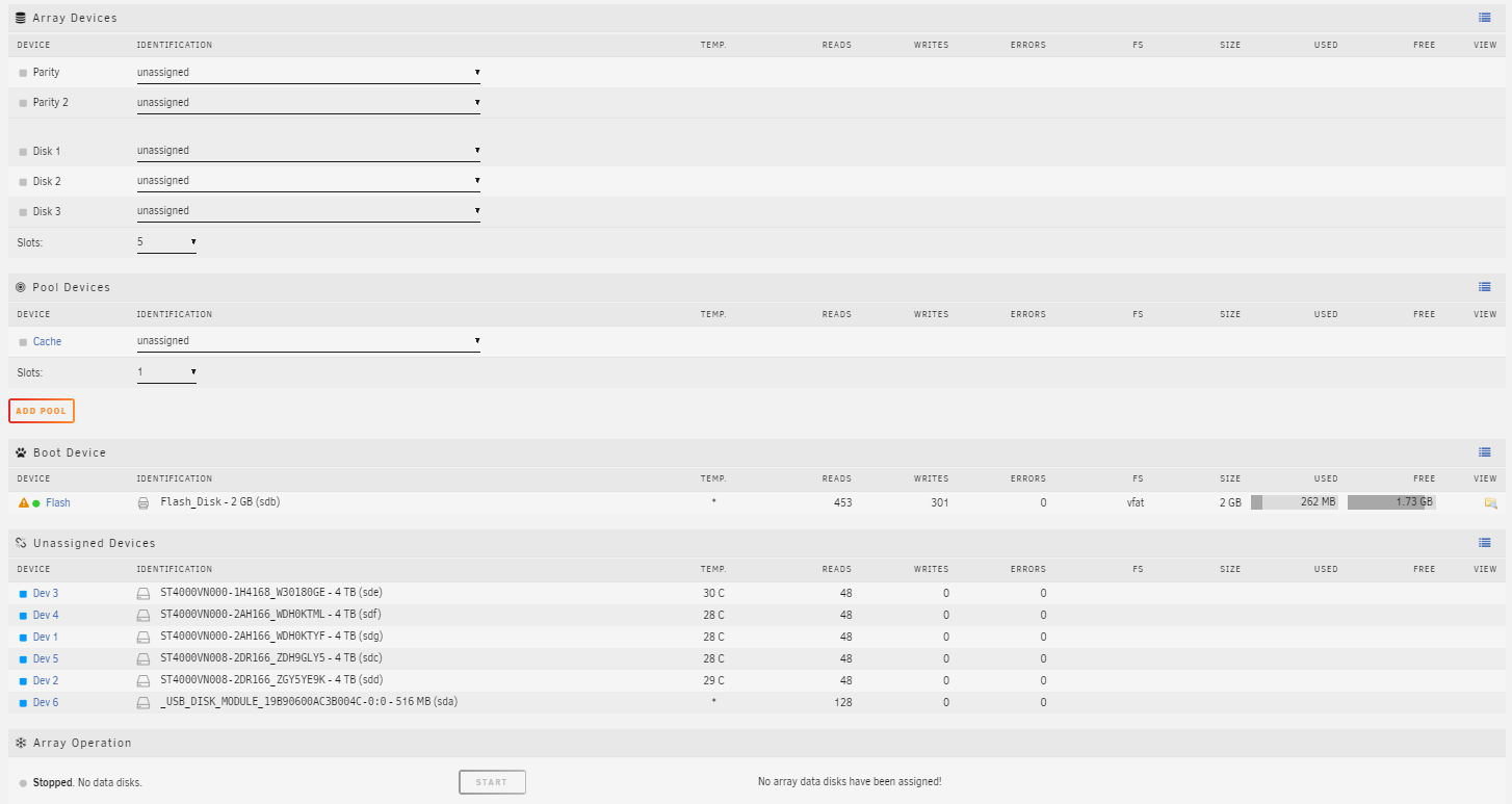

June 14, 20215 yr Hi everyone, I wanted to see if my 12-year old QNAP TS-559 PRO II would run UNRAID...and it does. QNAP no longer supports this hardware which is a real pity. It also has a limit of 15TB. So with UNRAID, I'll be able to use larger capacity, non-NAS specific drives. And, Plex upgrades on my Apple TV no longer work with the old version the Plex Server on my QNAP. So, time to try UNRAID. I just want to store my files and run the Plex server. Nothing more, except perhaps Google Cloud backup. I did remove the 1GB 204-pin DDR3 RAM that came with it and installed 2 x 2GB DDR3 SoDIMM RAM sticks into the QNAP however. (second hand and only $15 on eBay for the RAM) I have not pulled the 512MB USB DOM (QNAP boot drive) out of the system. I simply plugged in a 15-pin VGA cable to see what it was doing, plugged in a keyboard, plugged in the UNRAID USB, rebooted and pressed DEL to enter the BIOS. I then set up the BIOS to recognise the UNRAID USB drive and selected it to look like a Hard Drive. After rebooting, UNRAID unpacked itself and ran on the QNAP hardware. I decided not to assign the drives and build the raid at the moment as they still contain 'live' data. To get the QNAP back to normal I'll simply unplug the UNRAID USB and boot the QNAP. Time to move 10TB of data on the QNAP to an external drive, plug in the UNRAID USB, and copy the data back. Goodbye old QNAP!! Edited June 14, 20215 yr by AndrewMc
